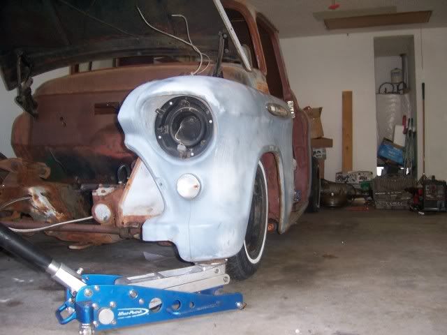

    Thought I would share my install.
    Someone had installed a clip before I got the truck and it was grafted on, one can clearly see that the tire is setting back to far in the wheel well.
    Now here is the Lux Blue way. :)
    And the rocker is around 5" or so.
    How does this look compared to the original???
    Do you all think that the wheel base is to far forward??? Or is it ok??
    Comments are welcome and expected.
    Toad
  20. brewsir
    Joined: Mar 4, 2001
    Posts: 3,278
    brewsir
    Height is good but yeah...a little far forward.
  21. Toad Frog
    Joined: Aug 24, 2009
    Posts: 17
    Toad Frog
    from Texas
    Does it look centered???
  22. JAWS
    Joined: Jul 22, 2005
    Posts: 1,848
    JAWS
    The hub to hub is 62" if memory serves. I am running 15X7's all around and no rubbing.
    Mine uses the stock '79 TransAm WS6 front suspension, all of it. The stock camaro or firebird stuff will sit about an inch higher.
    The rear is the stock truck springs, I removed all but 5 and spaced them out to match the leaf style pattern. The springs are on top still, with 2" longer shackles. The rear is a '72 camaro with 273's, stone stock.
    This thing rides very nice and smooth. If you were here I would toss you the keys and let you take it for a spin. It's almost boring. It is even better than my 46 coupe with it's Mustang II front and camaro with leafs.
    Angles are the most important part of the install, it's not just a quickie. No offense intended, but the engineers who built the F bodies weren't dummies and the position of the control arms and front crossmember in correlation to the rear end and frame are essential.
    Most people don't know but the F body's were built with the p***enger side front suspension exactly 3/4 of an inch off from parallel to the drivers side. Even the front fenders are made differently, not mirror images.
    My clip is not in stock like the LUX way, infact aligning it to the factory specs for a camaro will make it a mess. It is however perfectly symmetrical and level now compared to the stock F body.
    Prolly more info than you wanted to know.
    My buddy who does them is a magician. I have driven many clipped cars and trucks, none drive like this.
    He has one customer who prefers it over his '08 silverado SWB as far as ride and handling.:D
  23. JAWS
    Posts: 1,848
    JAWS
    Looks good to me. You must have moved it 1-1/2 forward at least.
  24. Toad Frog
    Posts: 17
    Toad Frog
    from Texas
    Thanks JAWS....
    I really dont know, I mean I measured the old clip that was installed, but who knows it that was right or not.
    It is around 1-3/4" more foward from that measurment. I know from the front cab mounts to the edge of the shock hole (closest to the firewall) it is 28-1/2" I talked with LUX today and his magic number is to the center of the shock hole. If I measured there it would be around 28-7/8". It is square with the stock frame I just wanna make sure that it is good before I weld'er in.
