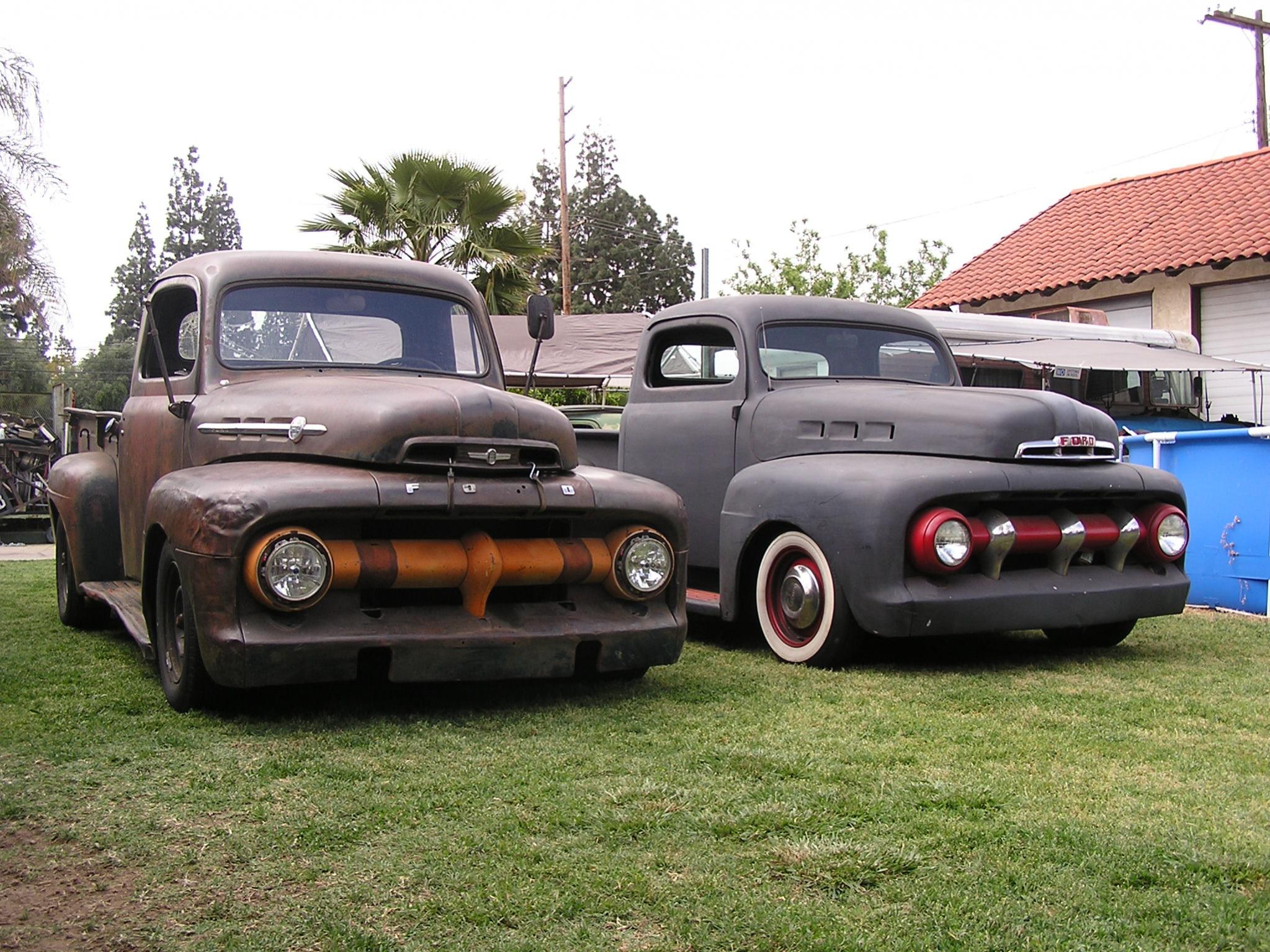

    father and son cameros, my sons is the chopped one......did his first loved it so much made me one...........
