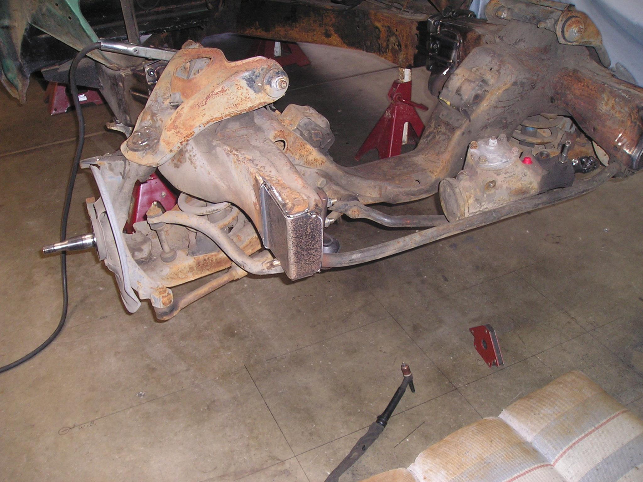

    Thanks Jaws, just dicovered photo bucket so here go's again with some pics of the firebird clip squared & tacked. Still need to mount A arms, spindle & rotors then remount wheels, & have another look with complete front clip re attached. The wheels should end up exactly where they were mocked up on shown on post #389. but.... we used the center of the shock hole to measure up? hopefully thats ok??

    "we used the center of the shock hole to measure up?"
    ...I'm thinkin the top shock hole is not the centerline thru the wheel, I almost positive it ain't....better re-check that.
    ...here's a clip I did, note the line drawn on the drivers side upper A-frame; it's ahead of the shock.

    that's correct, it isnt. however, since the rails themselves are different from side to side, and the upper control arm mounts are welded on after all is said and done, I prefer to use them because the are the most consistent measuring point on the clip. not to mention that the spindle center moves around with the alignment shims.

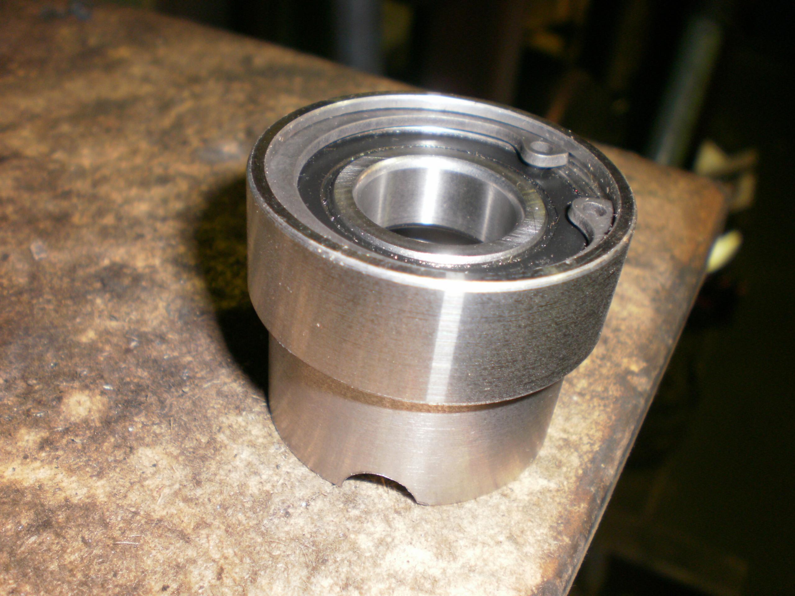

    great job but were did you get the bearing for the column it looks almost like a perfect fit?

    Its on the first page.
    "I came across these little jewels-the bottom support bearing from a 69 chevy pickup. now, I know every one of you knows where somewhere there is a 67-73 chevy truck"
    I used this and it is a perfect fit, hope to be able to post my clipped truck soon as we used this Tech article to show how it should be done.

    I bought the smallest of the shelf bearing with a 3/4" ID, a circlip & had a step bush made at my local little machine shop. Press the bearing into the bush then tap into the column tube.

    I took the upper bearing out of another 55-59 column I had and put it in the bottom of the tube. The bearing OD is coated with rubber so I shaved a bit off with a file and drove it into the tube. I then took a 3/4 washer and tacked it to the shaft with the steering wheel spring compressed. I had a newer tilt column with the square/round shaft that matched the rag joint yoke. I cut probably a little over a inch off the column shaft, flattened two sides of the 3/4" shaft of the 59 column with a grinder. I then knocked the square/round stub onto the 3/4" 59 shaft, drilled the hole and welded the very end of it. LMC sells the upper bearing so they are easy to come by.

    So did you weld it up as in the pictures on post 392 or did you relocate the sub frame after you mocked it up ?
    thanks
  26. Red Foreman
    Joined: Sep 11, 2009
    Posts: 43
    Red Foreman
    No I ran into clearance issues with the F body sway bar & the GMC rad support crossmember, I ended up t******* a little more off the frame rails to end up with 3/4" stretch, still looks good.
