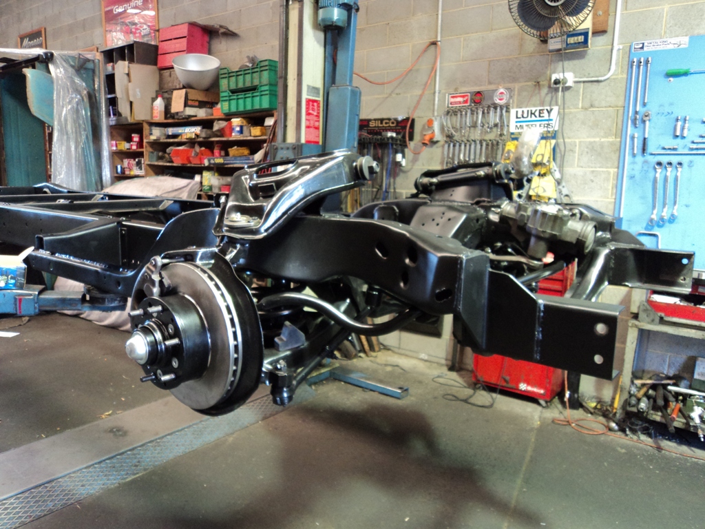

    Got the Durango front frame on my 1957 Chev pickup 8 degrees of caster but it took me a few days. Lots more screwin around than the Camaro swap.Dropped it down 6-7 inches with engine sitting in it.Only reason I used this Durango framewas because I had it. This thread helped me set it up and measure everything. Had to step up frame to get it where I wanted it. A lot more work but I got her done. Rack and pinion steering should work nice.:D:D:D
    Again thanks to all who contributed to this thread..After you get one done your ready and more confident to do another one.

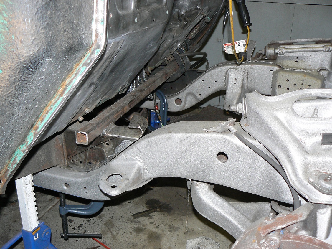

    I'm so close to welding this thing, it's driving me nuts! Still have to double and triple check dimensions and figure out how I'm gonna power a Millermatic 252 to weld this thing up. Anybody used a portable generator to power a 240V MIG? lol I don't have 220 service yet. :confused:
  30. Gomojo55
    Joined: May 18, 2011
    Posts: 97
    Gomojo55
    Fenders on for confirmation of wheel centerline. :D I felt like a huge weight was lifted after seeing this. haha Obviously no weight on the suspension yet, I think it's "gon' be jess fine".
