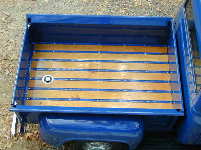

    I have clipped three of my cars.....the first was a 55 ford F100. I installed a 71 Monte Carlo clip and it fit like a glove....it was the perfect width and I never even had the front end aligned in 30,000 miles. Took me longer than 2 days though. The most critical parts are making sure the anti dive angle is like the orig clip had, re-installing the bumper brackets, and very critical...making sure the front crossmember is dead right on height wise or your whole front end sheet metal will have gaps and never fit...and that is never going to fit right if you are off here.
    I did extend the wheel base by 1 inch and the tire sat perfect in the opening.

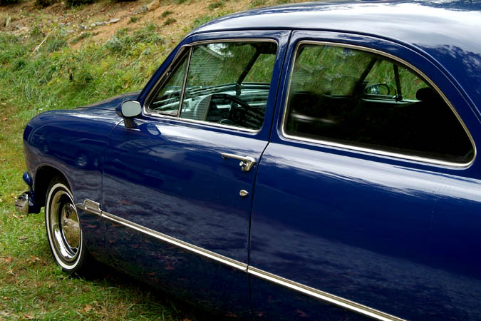

    I also clipped my 51 ford car. I used a 84 monte carlo for this one....again...it was the perfect width and this car drove like the 55 f100....like a dream. I never had this one aligned either driving it for 8 years and the tires looked brand new....even though the car has been sold and is close to Greensboro NC, it is still in the cl***ifieds on this forum with a video clip and you can see how nice it rides and drives.

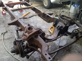

    Anyway, picked up a '76 subframe last fall and had intended to clip it this past 'off-season' but life got in the way. After getting the fillings rattled out of my teeth on the trip to the Road Rockets show last weekend I immediately came home and started tearing it down for a rebuild. A friend with a heavy-duty sand blaster has offered to clean it all up for me.
    I still won't tear my old truck apart till the Redneck Rumble in September, but I'm hoping to have the clip painted, rebuilt, and ready to go.
    Here's my buddy Pete helping me get it outta the salvage yard last year.
