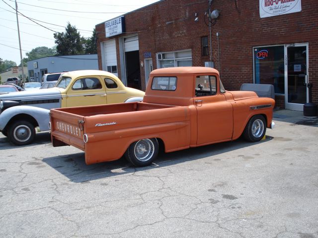

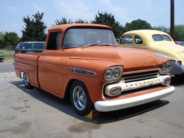

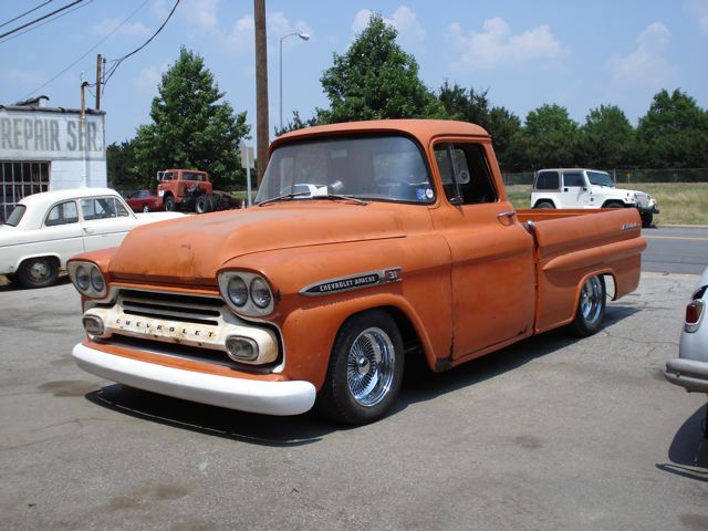

    Actually drove it around today, sits right... drives right... ready to go back to the owner at the end of the week...
    Just got to fix the $60 ****** that was put in it... :mad:
