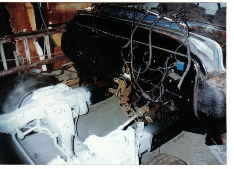

    Here's a 58 I did around 90-91, I slipped the 77 stub inside the rails and flipped the rear on top of the springs.
