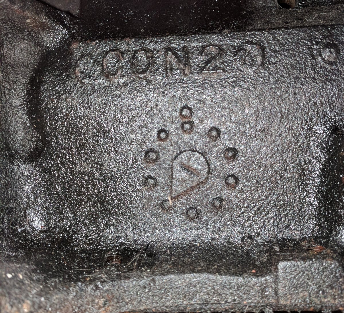

    I'm having a bit of trouble identifying an engine. Supposedly this should be a 1970's Chevy 250 straight 6 but the cast number is 3851659 which seems to be a 292. Below that number is the GM logo and the number 7. It does seem to have different, dished pistons than another engine I have that I know is a Chevy 250 so I could believe it's a 292. Unfortunately, I am unable to ID the year. The stamp by the distributor reads 17 5407268 which doesn't have a factory letter or year. On that same side above a dial casting are two plates, one reads CON2 and the other L234. There is also another cast in the front that reads 5 on top of 859. I've attached images, any ideas? Thanks in advance!
    IMG_20171225_154855~2.jpg IMG_20171225_152930~2.jpg IMG_20171225_152138~2.jpg IMG_20171225_151946~2.jpg IMG_20171225_152522~2.jpg
  17. squirrel
    Joined: Sep 23, 2004
    Posts: 60,068
    squirrel
    L 23 4 would be the casting date, most likely...Dec. 23rd 19x4
    Does it say "Hecho en Mexico" on it anywhere? :)

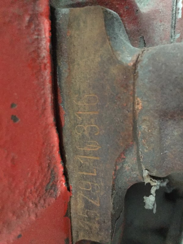

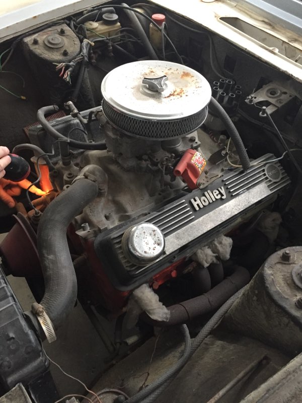

    Hi, I was wondering if anyone can give me any details about the small block Chev which is now in a Triumph Stag in Australia, I was told it was a 327 but the only engine no. in front of the head is 1529L1Q316
  26. squirrel
    Posts: 60,068
    squirrel
    We can't tell you anything about it from that number, because it's obvious to a North American that it was not stamped at a Chevy engine plant with that number....it just looks "wrong".
    What about the casting numbers at the back of the block, above the bellhousing?
  27. Peter Burns
    Joined: Jan 10, 2018
    Posts: 2
    Peter Burns
    Hi again, I have finally been able to look at the casting no. and I think it is 3903352
  28. squirrel
    Posts: 60,068
    squirrel
    block is likely a 1967 327. Sounds like a good engine to have.
