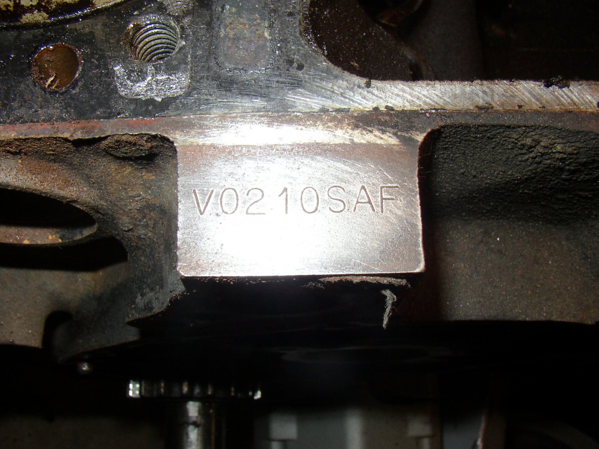

    I have bought a 350 that was transplanted into the truck I got it from. I can not find the last letters that are stamped on the front pad. Could you please help me with them. V0210SAF I know the "V0210" I can't find the SAF, I believe it's a corvette. The heads & intake were changed to 193's when installed into the truck.
    Thanks, Pat
  2. squirrel
    Joined: Sep 23, 2004
    Posts: 60,070
    squirrel
    Ignore the part about it being from a Corvette, that's just normal salesman ********.
    But if you could post a picture of the stamped number, and the stamped partial VIN if it has one, that would be a big help identifying it.

  3. Fordors
    Joined: Sep 22, 2016
    Posts: 6,577
    Fordors
    Any chance it is SAP? SAP comes back as a 1993 350/275 horse tuned port injection engine. Does it have the oil cooler adapter above the filter?
  4. HemiTCoupe
    Joined: Apr 4, 2013
    Posts: 217
    HemiTCoupe
    from TN.
    That's what I told them, they all came from a vette. lol I'll get a picture posted tomorrow.

  5. HemiTCoupe
    Joined: Apr 4, 2013
    Posts: 217
    HemiTCoupe
    from TN.
    I'll check closer tomorrow, if it's a "P" and not a "F".
    I bought it from my next door neighbor. The oldest brother said that he watched them pull it out of a wrecked Vette, and then changed the heads & intake, before putting it into his Mom's wagon. The engine was a transplant into a full size '93 chevy wagon. A boat of a car. It was Mom's car, but the boy's wrecked it many times over. After wrecking all of theirs first. They each go through (destroy) a car every 6 months for the past 11 years I have lived here. Five son's, three and a half came without brains! One s****ed his S-10 to get money to make a payment on it! Figure that one out!
    Yes it did have a adaptor, and the oil pan has a fitting on the drivers side also. But I didn't get to see where that ran to, he just brought me the engine. The filter was off, because when he ran the car off the road into a field, something went through the oil filter, then he drove it a block or so, then it started to make noise.

  6. HemiTCoupe
    Joined: Apr 4, 2013
    Posts: 217
    HemiTCoupe
    from TN.
    It is definitely a "F" and not a "P"

  7. squirrel
    Posts: 60,070
    squirrel
    with no partial VIN on it, perhaps it's a GM crate motor. Those suffix codes don't show up in the lists for engines that were installed in cars.

  8. HemiTCoupe
    Joined: Apr 4, 2013
    Posts: 217
    HemiTCoupe
    from TN.
    It's just a 350 with switched heads, that doesn't know where it came from!

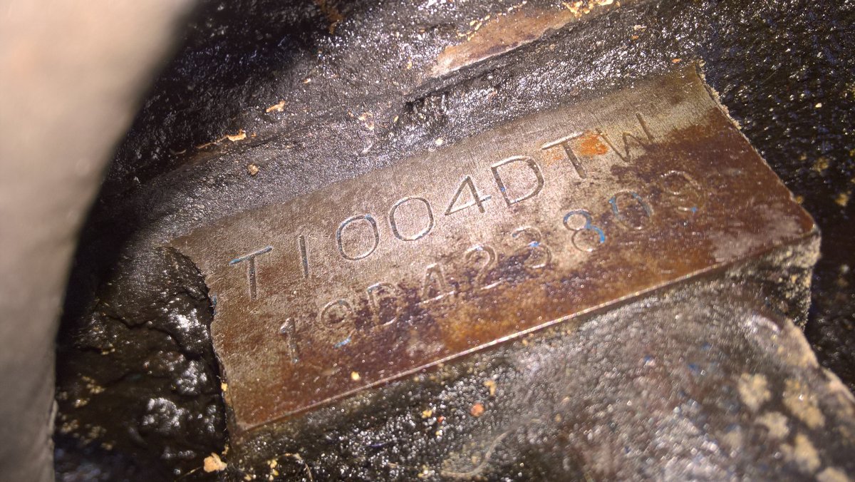

  9. Bel305

    Hi! I'm new here. Could anyone help me with engine suffix code DTW? It's cast 460777. So I know it's 305. From suffix and partia vin I can tell it's from Tonawanda engine ***embled in Atlanta in something. I can't find suffix DTW or witch cars were made in Doraville 1979.

  10. squirrel
    Posts: 60,070
    squirrel
    What specifically do you want to know about the engine? It's a 1979 305, it either came with a 2 or 4bbl carb. If it has the original intake, that will tell you what it is, essentially.

  11. Bel305
    Joined: Feb 24, 2019
    Posts: 3
    Bel305
    Is it lg3 or lg4. And if there was any additional information from DTW. By looking at it, seems extremely low compression. Also 1.94 intake valves. Propably chanced. No original intake.

  13. squirrel
    Posts: 60,070
    squirrel
    I made it home, where my books are....shows DTW as Malibu or Monte Carlo, with the 4bb carb, 160 hp
  14. Bel305
    Posts: 3
    Bel305
    Thank you, very much squirrel! I have owned this engine from 1990. Tried to find information ever since.
