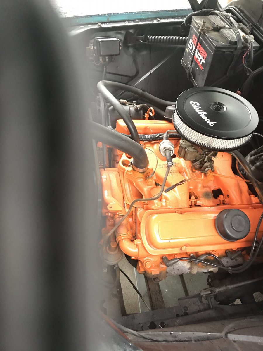

    image.jpg Hey guys, I just purchased a 1959 GMC 150, and we are trying to figure out what motor is in it.
    Castings on right side under the head says GM-2 and then under that it says 533087. It has 4 on the floor and drives like a tank! Any clues what it could be. He said it is the original GMC 283 but it looks like a Pontiac motor to me. Ive tried to find it in GM casting number searches but I don’t see it anywhere. Thoughts?
    1Nimrod and Bowtie Coupe like this.
  11. theHIGHLANDER
    Joined: Jun 3, 2005
    Posts: 10,798
    theHIGHLANDER
    Yes, that's a Pontiac. Just under 300 CID, I can't quite recall the exact size. Makes it easy to drop a 389 or bigger in it;)

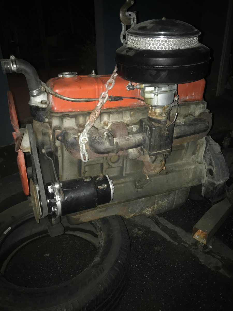

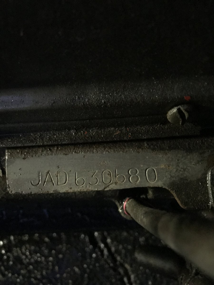

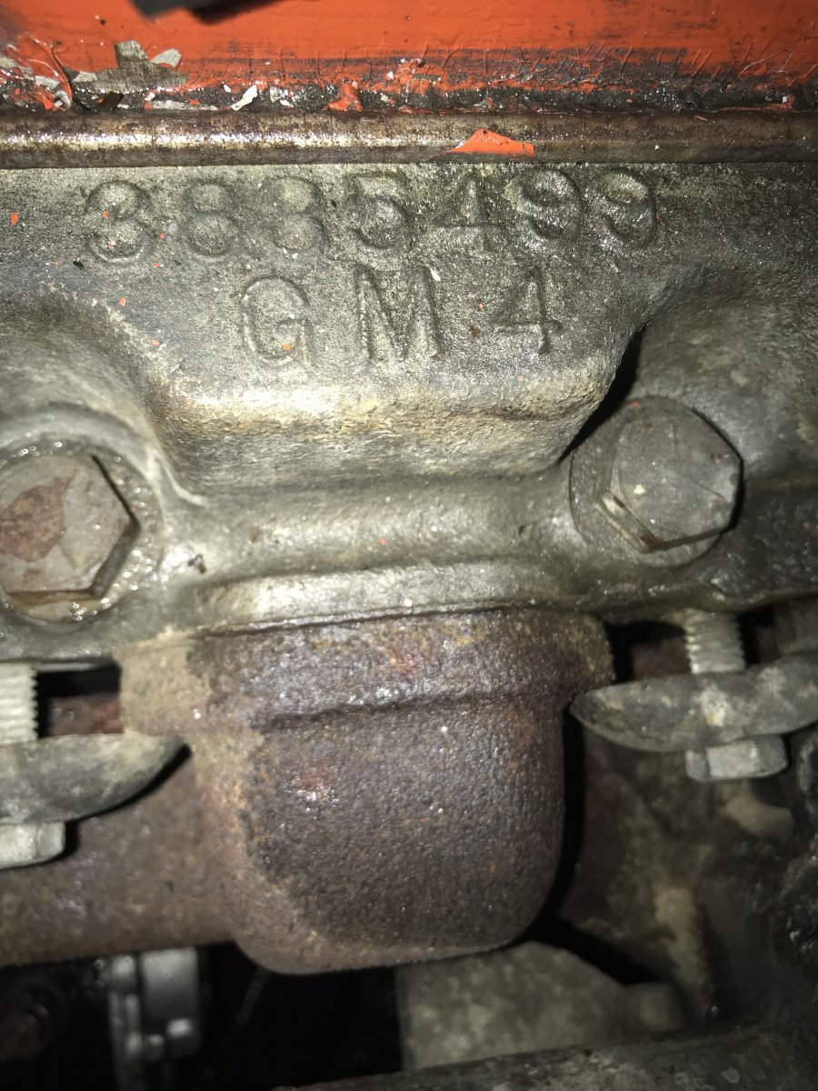

    Came across this thread searching online for ways to figure out the engine I just bought. Can someone shed some light? So the head number is 3835499 which I think I found out it's a 235 head. But the the block stamped number is JAD630680 which I can't find anywhere on line. I found JDA but that's different. Thanks in advance.

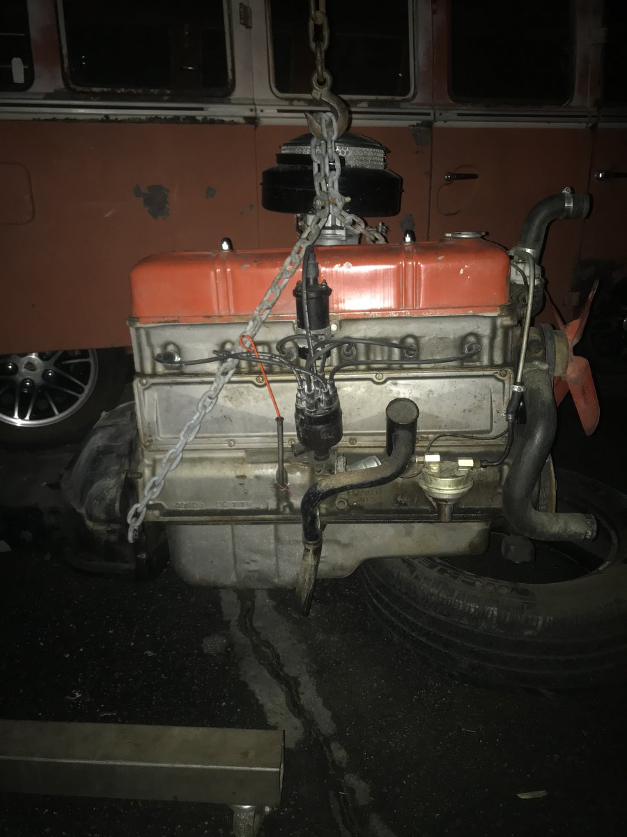

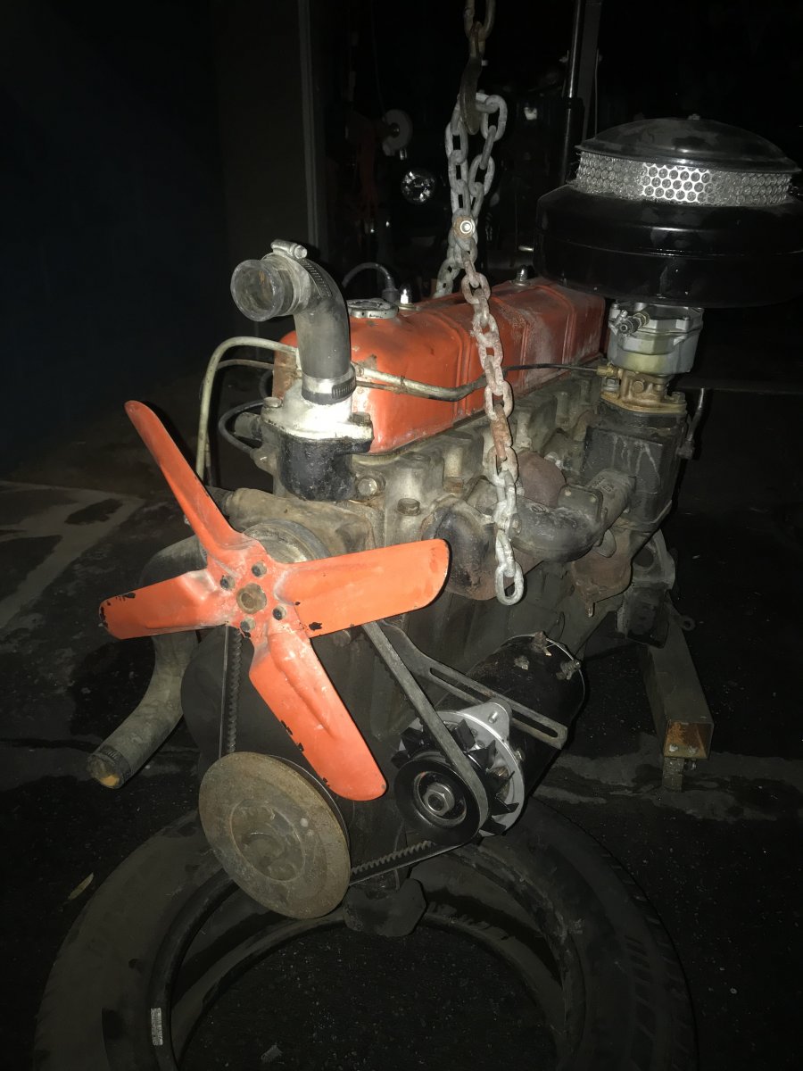

  25. Salvarican
    Joined: Oct 17, 2006
    Posts: 82
    Salvarican
    Pictures of engine and numbers
  26. Salvarican
    Posts: 82
    Salvarican
    More
  27. squirrel
    Joined: Sep 23, 2004
    Posts: 60,068
    squirrel
    That could be a 1951 235, from a powerglide equipped car.
  28. Salvarican
    Posts: 82
    Salvarican
    How can I make sure?
  29. squirrel
    Posts: 60,068
    squirrel
    It has the correct code stamped on it, and the stamp appears to me to be original...I guess you could also check the casting date of the block.
    The side cover is the type used on 235 engines, and the rest of it looks "right".
    Just how sure do you need to be? :)
