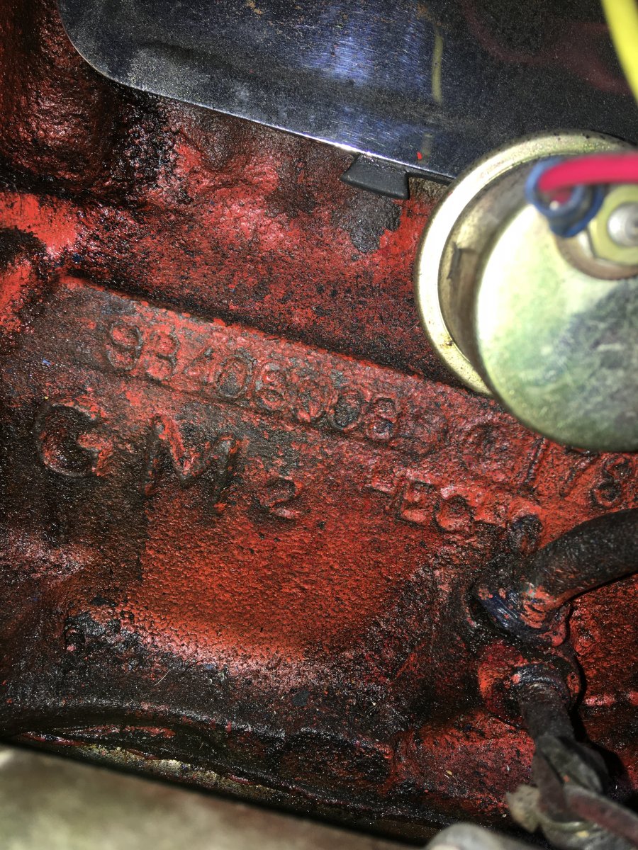

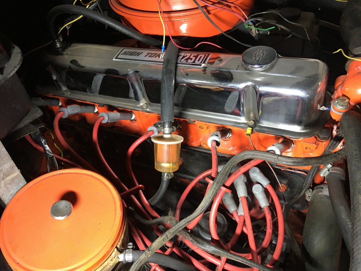

    I'm hoping someone can help me out here. I've recently bought a 66 GMC pickup truck and was told this is the original 250 motor. I was a bit curious and crawled underneath to check the casting. I can't seem to match anything up tho. "Hecho en Mexico" - is this simply a replacement motor?
    Any help is greatly appreciated!
  4. squirrel
    Joined: Sep 23, 2004
    Posts: 60,068
    squirrel
    Most of the newer replacement engines were made in Mexico, starting....when? in the 80s?

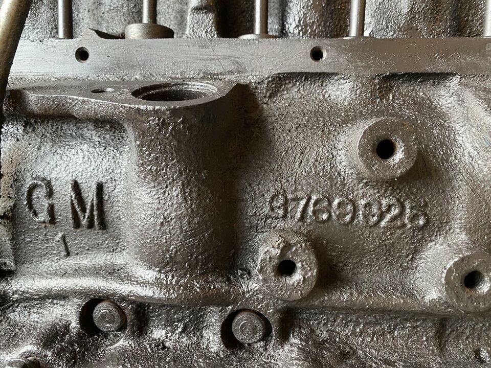

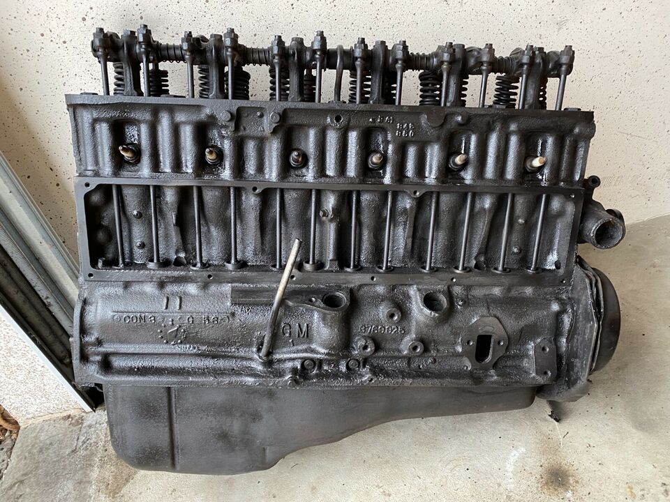

    After reading through all the replies here helping guys id their engines I'm hoping I can get some for myself. I have a 1949 Chev truck with a 235 in it - I'm trying to rebuild the engine but having a hard time nailing down the exact engine I have since I know it's not original to this truck. It's a 235 with the 848 head on it, has hydraulic lifters, and as long as I've had it there's been a 4 speed manual in it. There is no engine date code on the lower rear right block, the block casting number is 3837004 (which I think tells me it's a 1955-57), and the engine code stamped behind the distributor is C270610... and that's what's got me stumped. I'm struggling to order parts for it since there's several options available for that year range and if it came with a manual or powerglide transmission. Any help on the code would be very appreciated - could the C indicate a Canadian made engine, or a crate/counter replacement? Thanks
  7. Maybe this link will help you. If you can find the serial numbers for the engine, which should be on a pad below the distributor, this would be really helpful. The suffixes on the serial number will indicate how the engine was configured.
    http://chevy.oldcarmanualproject.com/models/engine.htm
    The casting date on the block would help identify when the block was cast. The engine normally meets the car on the production line about 90 days after the casting date.
    http://devestechnet.com/Home/CastingNumbers
    Bob
  8. Alberta Andy
    Joined: Jan 22, 2021
    Posts: 4
    Alberta Andy
    Thanks for the fast response Bob. I've spent quite a bit of time looking online, and I had found your suggested sites as well - that's why I'm stumped, because they don't correspond to anything I've come across so far. The serial number on the pad is the C270610 I mentioned, and it just doesn't make any sense. And the block doesn't have the CON**X and date code on it, so the closest I can come to is the main casting number of 3837004 which gives me a range but not a specific year. I'd be leaning toward it being a replacement engine, however the engine shop I'm dealing with has another 235 there right now that's supposedly the original from another guy's 59' truck and the serial number on it is C414477, and also has no date code on it. Did they stamp Canadian made engines with a C? I appreciate the resource suggestions for sure
  9. I just happened to be checking the forum. My understanding of the serial numbers starting with C, is that they are warranty replacement blocks. I am guessing it would only have been a short block, but I am not certain of that.
    I have a block with a serial number starting with C, and I know it was a warranty replacement block. I can't confirm this, but a lot of Chevy engine blocks cast in Canada, were cast by McKinnon industries, and this is identified by K in the serial number.
    Here is another site that will be helpful.
    http://1954advance-design.com/Stovebolt-engine/casting-numbers.html
  10. squirrel
    Posts: 60,068
    squirrel
    Where are you? There's a way to put your location in your profile, so we could tell. If you're in Canada, or up north, then it could be a Canadian engine. The stamped numbers on US built engines don't look like that,
  11. Jim, I am guessing by his handle, that he is from Alberta, Canada. During that period, we would see some vehicles with a Canadian built engine, but that was not true of all models. For instance, my Cameo was built in Flint. I pulled the original engine in 1968, when I did the first swap, so any information I could have gathered from the block is long gone. I have another 235 out of a 55 pickup, and I will have a look to see how it is stamped tomorrow.

  12. Alberta Andy
    Posts: 4
    Alberta Andy
    Yes, I'm sorry I didn't see where to put my location into my profile - but I am in central Alberta, Canada.
  13. squirrel
    Posts: 60,068
    squirrel
    my guess is you won't find any useful info about the engine from the numbers...you'll have to look at the parts on it, to figure out what parts you need.

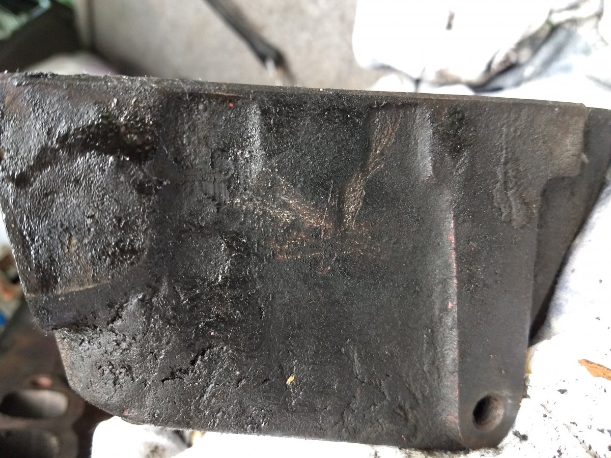

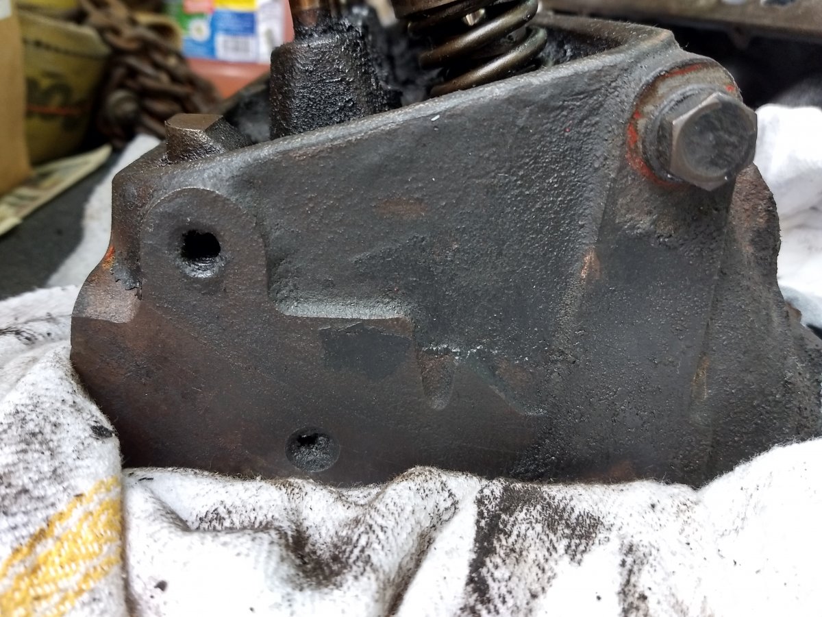

    @squirrel , Jim,and all you numbers gurus, I need you help here to verify this please , I just found what I think is a July 5th 1956 cast , 3969925 block 261 in our local cl***ifieds. It´s listed as a 50s 235, but the captain´s bars rang a bell. Condition is unkown and he is asking 300€ for it, but these 261s are the needle in the haystack if you have to look for one over here. I tempted to go an get it... if it really is a 261. Thanks in advance!!!
  15. squirrel
    Posts: 60,068
    squirrel
    Yes, that is indeed a 1956 261. Might also ask to see the stamped number on top of the distributor pad, just above where it says GM.
    might also see if it's cracked above the forward freeze plug, there's a strange line in the casting there....and that is the area where they crack if left in the cold with water inside. I have only owned one 261, it was a freebie, because the crack there was pretty serious.
    Baumi likes this.
  16. Baumi
    Joined: Jan 28, 2003
    Posts: 3,397
    Baumi
    Thank you, Jim. I was wondering about that irregularity above the freeze plug also... He ( the seller) is or acts clueless and says he has never run this engine and knows nothing about it. I´ll just go there tomorrow , give it a closer look and see what happens. Thanks for your help! If it turns out to be good you will probably read about it in my truck build thread, along with a ton of other questions:D

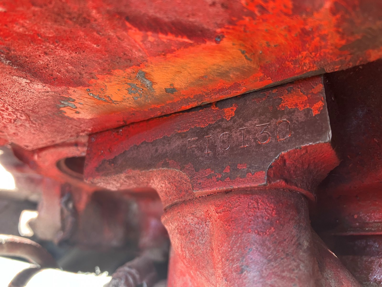

    @squirrel I have a 1952 Chevrolet Pickup with engine F1013D. I'm looking for a code listing to identify the engine and what vehicle it came off. I know the first five are Flint and the date, but I am having issues finding anything for the D. Any help would be greatly appreciated.

    Early '60's 283 mostly 170hp with a powerglide trans.

    D is 1958-64 2bbl powerglide 283. If you want to know the year of the engine, find the casting date code on the back of the block.
