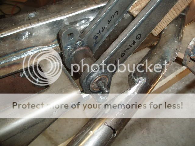

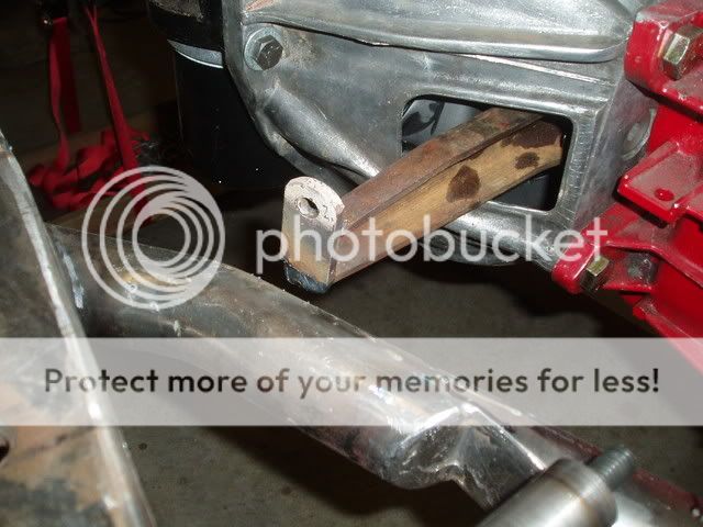

  1. Just wanted to thank D-Russ for this thread. It helped me sort out the clutch issues with my Pontiac 347/BW T85 in my 21T Modified. I made up a bracket similar to the one in his pictures using 30mm x 6mm mild steel strap. My bracket also mounts the circle track shifters. I made up a trial cable using some old Citroen 2CV outers and an inner from a lawnmower. I used a 2CV clutch cable housing that can be seen on the firewall of the 27T cowl.
    The cable set up worked great until I used it too many times and it ripped the soldered ****** off. No matter, it was only to get the dimensions right and I'm having a proper swaged cable made up by a local control cable spe******t. I might also need to alter the angle of the cable holder on the gearbox slightly but other than that it's all working well.

  8. Swapped the cable stop for a swivelling stop that automatically sets itself at the correct angle to the clutch release arm. The guys at North West Control Cables have made me a heavy duty adjustable clutch cable so it will all come together tomorrow.
