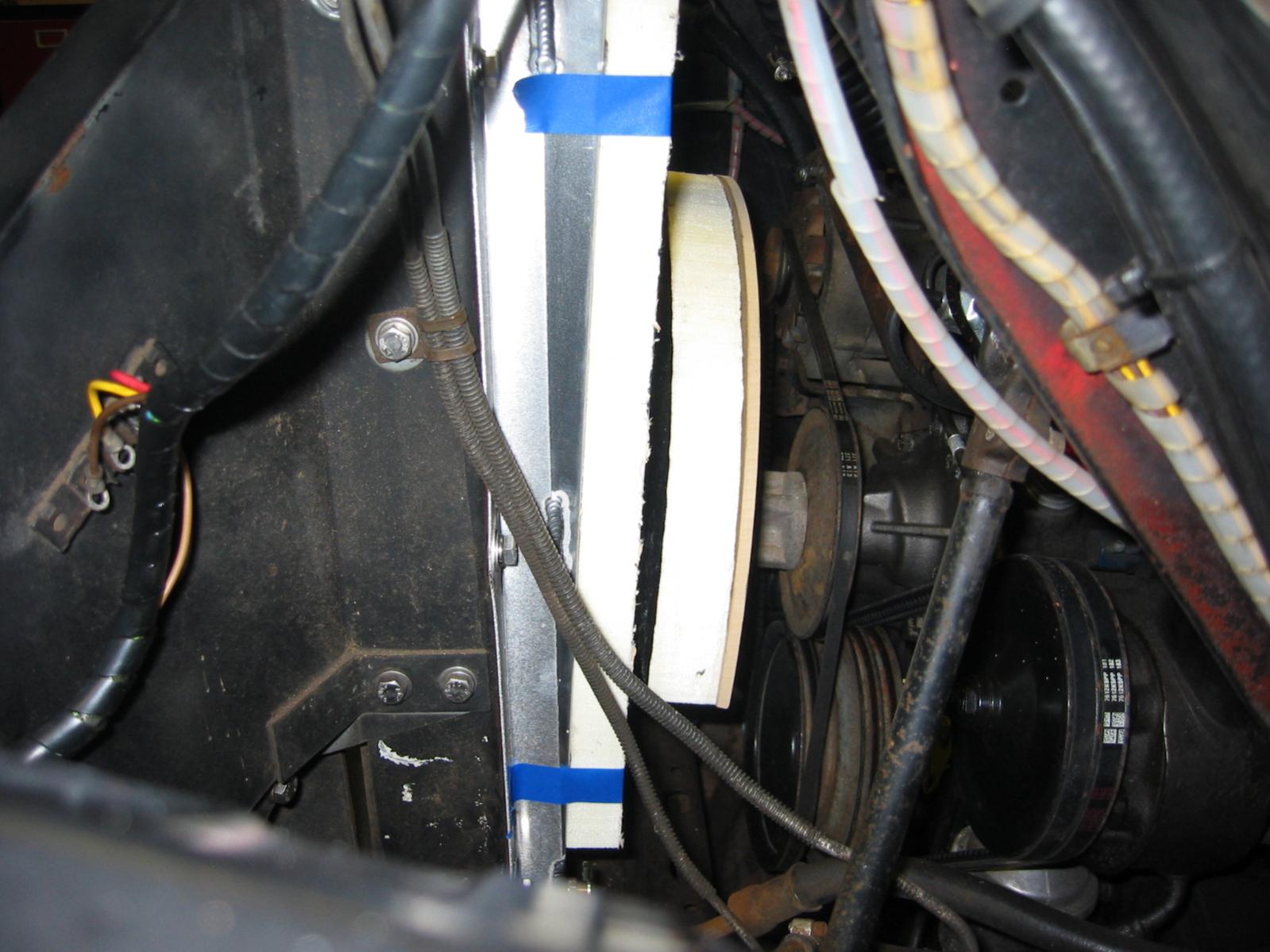

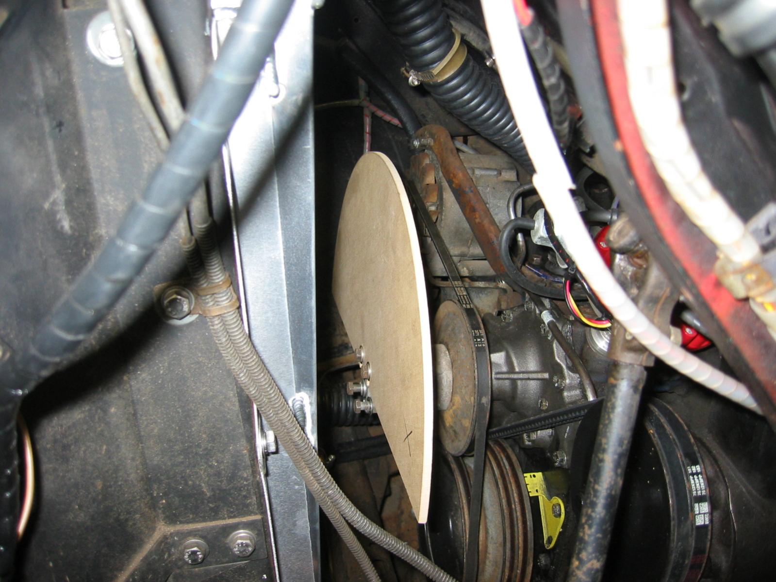

    Why is it great threads from HAMB pop up when you Google. Sweet idea, just found this thread yesterday by Googlin' how to make a fan shroud. Already started the mock-up. A bit of a challenge in my COE with limited access. One thing I did different, since I am still waiting on the UPS person to deliver my 16" fan - I made an 18" disc from Masonite with a 5/8" pilot hole. This locates the fan opening perfectly:

    Here's my first coat of resin over the stretchy cloth - That's 86 cents worth of swimsuit liner remnant. Think I was the only man in the fabric store.....

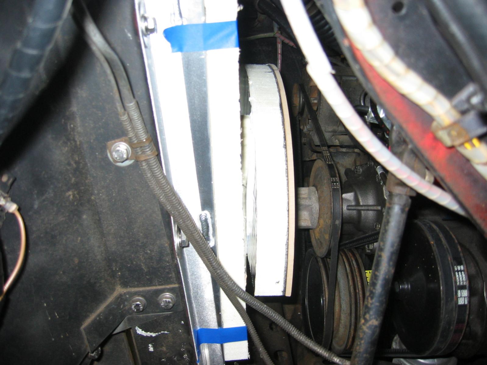

    Here's the COE shroud after last wrap - and after rough trim. Challenge now will be to get it in location, even at half a shroud. May have to remove floor boards to get it in there in one piece. Either that or split it down the middle....

    Taped her in place for a test - Before it would not hold a shop rag at the top of the radiator at slow idle..... Look at her go now.....

    COE shroud all done - Good little project, a few evenings of work over the course of a couple weeks. You can only do so much every night anyway, then let things cure.
    Did split it down the middle and added a strip of gl*** for a 2" overlap. Bonded Rotaloc 1/4 - 20 nut plates to the back for the split and mounting. Simply shot it in Krylon high heat radiator satin black. Not very visable so did not bother with a skim coat of polyester spot putty or anything. To heck with the shop rag test - that is a 20x40 terry cloth towel folded twice - 4 layers held in place at slow idle - on top where it had no idle air flow before.
