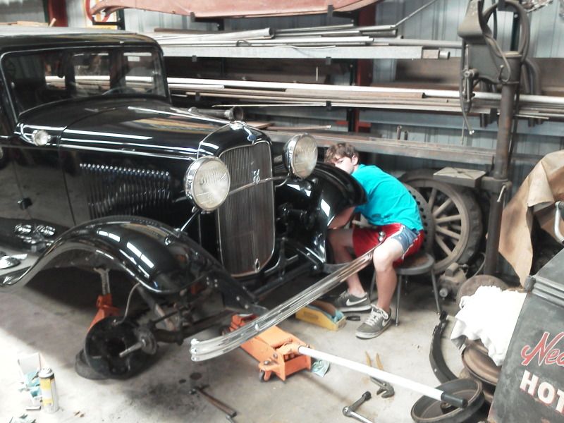

    Next step was to pull the stock front suspension out, with the help of my 13 year old son...

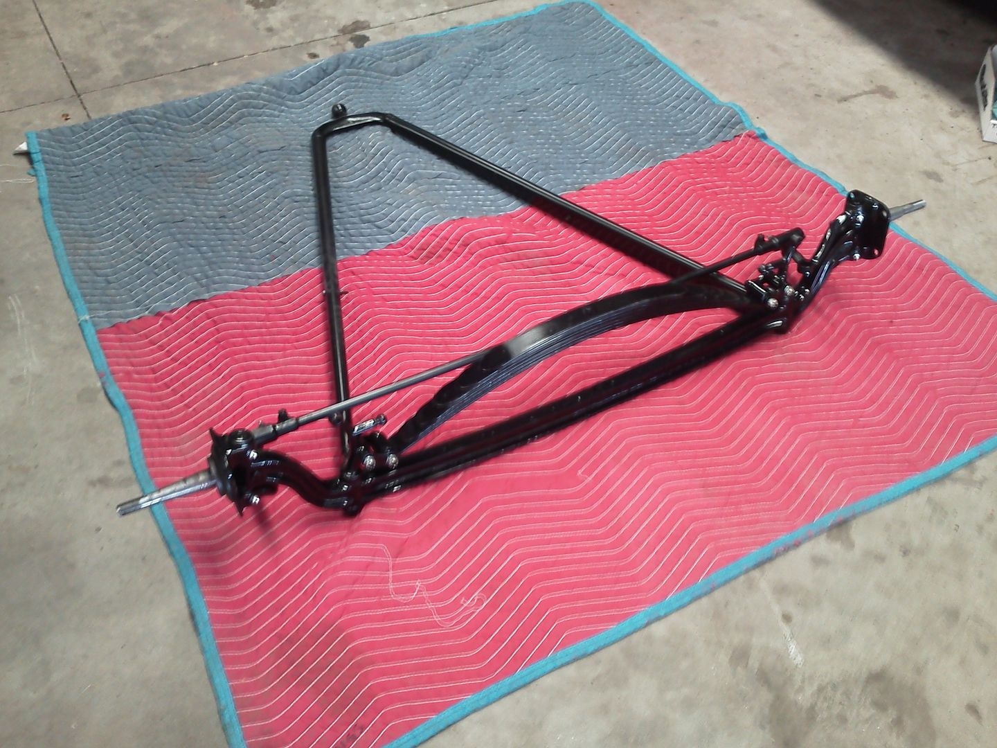

    and then started cleaning up parts to put back in with the dropped axle. The wishbone was one of the nicest I have seen. A few minutes with a wirewheel and a DA and it looked like it was ready to go to the plating shop...

    I traded for some NORS front shocks, so got those painted too...

    We bolted the wheels on out of the car, as it is easier to do the "tape measure alignment" without fenders and a frame in the way...
    The car had 40 hydraulic brakes already, so we didn't even have to break the lines loose...
    My son helped bolt things back together as well...

    Here's the front end all done...
    and the result...
    That's a stock front crossmember, a 2-1/2" Mor-Drop 33-36 axle, 7 leaves in a reverse eye spring and 32 spindles (which lower the car about 1/2" more than 37-48 spindles) and 5.50-16's.
