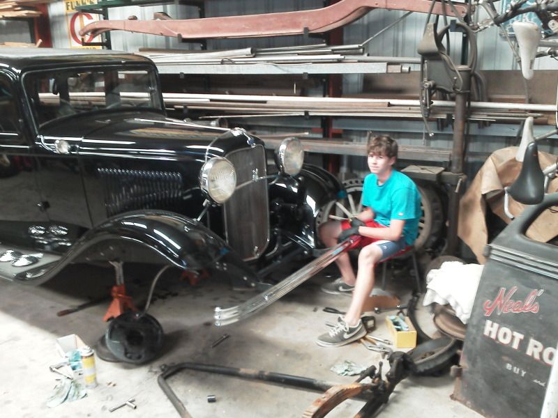

    Neal, your tech threads are always a great read! You make it all look so simple, and you're so willing to share these little secrets that few others would! Great info and pictures, and bonus points for working with your son!

    What a beauty! Nice job all around. Sits just right. QUESTION: I always thought you had to due a front end alignment with the weight of the car on the front suspension - with the front suspension installed in the car. Am I incorrect?

    For sure with anything other than a straight axle, but I was just setting the "toe". I approximated the caster by blocking the back of the wishbone at ride height. Nothing else will change once in the car...

    Neal:
    Is there a front and a back when installing a solid I-beam axle?
    Thanks, Jim
  24. NealinCA
    Joined: Dec 12, 2001
    Posts: 3,619
    NealinCA
    Jim - On an early Ford axle, no. The axle is symmetrical, the caster is set into the wishbones.
    Neal
  25. 19Fordy
    Joined: May 17, 2003
    Posts: 8,421
    19Fordy
    Thanks Neal. So, can I ***ume that a 1940 Ford axle is "early"?
  26. NealinCA
    Posts: 3,619
    NealinCA
    I am not positive about the late model stuff like a 1940...but I know 28-36 axles are same front to back. I think the 37-41 and 42-48 axles are the same as well...
