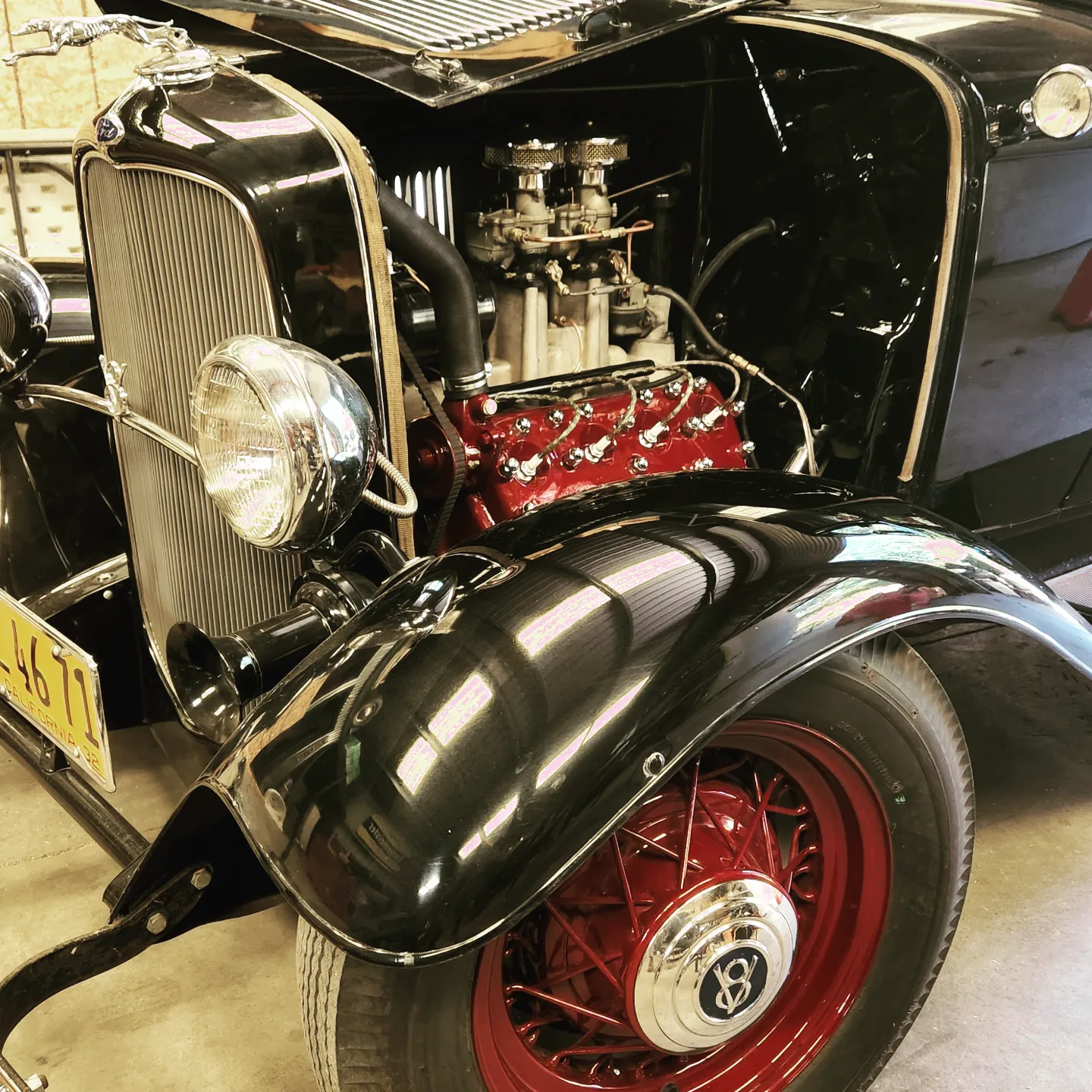

    Dredging up a post from the past with some updates on this car.
    Other than changing the wheel color, I've driven this car for the last 10 years with no other mechanical upgrades other than lowering it, replacing the steering box with one of my Nash conversions, and 2-97's and headers on the stock 32 21 stud.
    It looked sharp on the outside, as the 45 year old enamel job still polishes up well, but the drive train and brakes needed some love.
    The radiator was leaking and wreaked havok on the engine and firewall.
    I was going to repaint the engine in place, as well as the firewall, but one thing led to another and I pulled the engine.
    Since the engine was out, I decided to replace it with a rebuilt 36 LB I had picked up a few years ago. It was going to get a Ford green rattle can job, but that plan changed too.
    I ended up painting it the same maroon as the wheels
    and the firewall gloss black

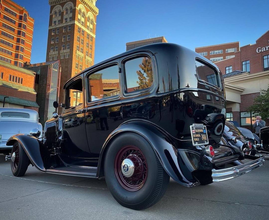

    We just got back from Oklahoma after attending the Gathering at the ROC. What a great event, amazing cars and an even better group of people!
    I had a local detailer polish up the 40+ year old enamel before we headed out
    We had a great time in Oklahoma catching up with old friends and meeting new ones.
    A highlight for me was receiving an award from Cory and Ashley Taulbert. The award was completely unexpected and really means alot coming from people that I really respect and admire.
