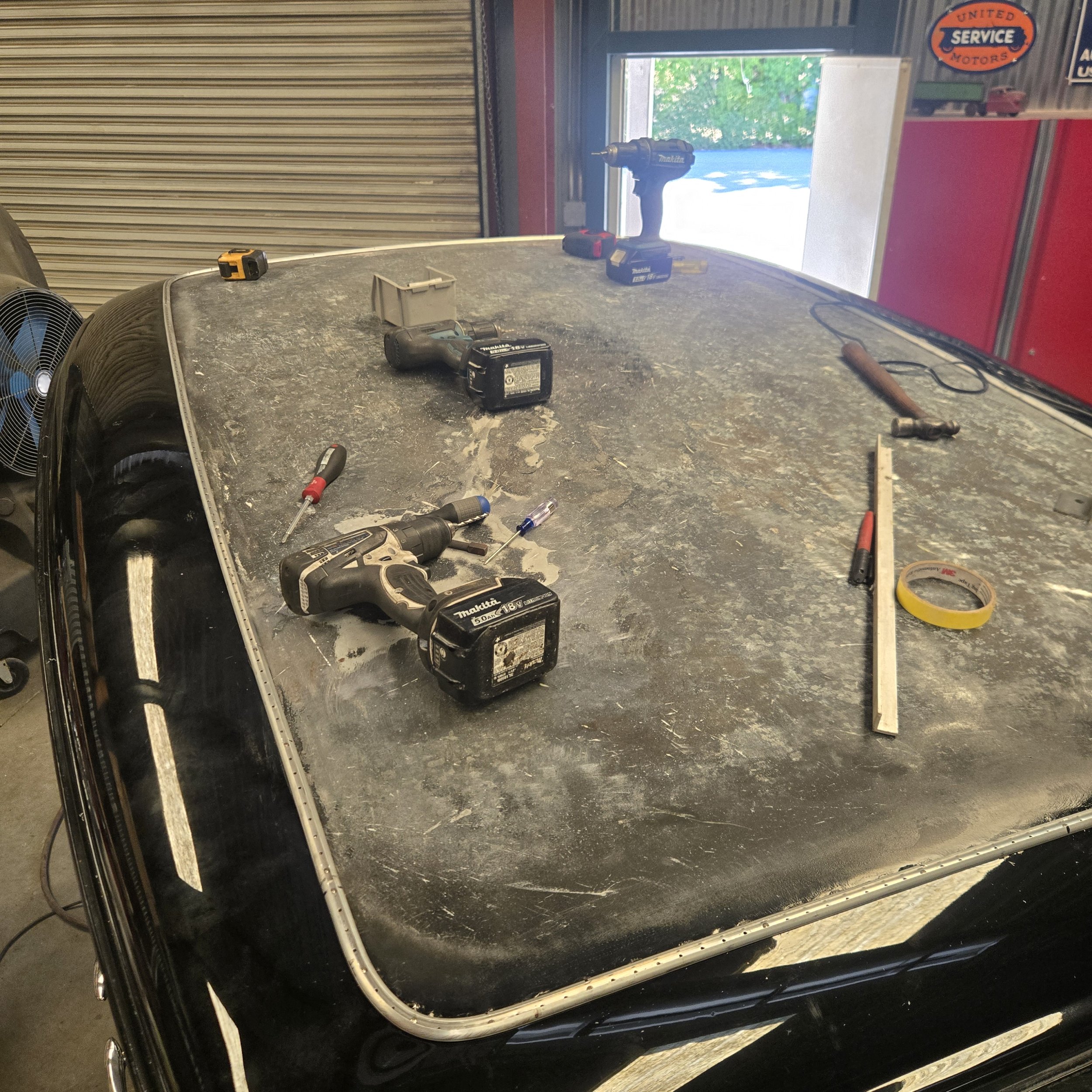

  7. NealinCA
    Joined: Dec 12, 2001
    Posts: 3,619
    NealinCA
    I annealed about 6" sections where the bends needed to be, then just bent the molding by hand. I had left about 12" extra to use as a lever. One bent really flat. The second bend had a twist to it, but I was able to use a plastic shot hammer and tap it back flat, hammering only on the top of the electrical cord I had stood vertically in the channel.
    I watched these 2 videos to get an idea of what I needed to do.
    He talks about annealing at about the 6 minute mark, so then I watched another video just about annealing aluminum.
    I used the Sharpie and Oxy/Acetylene torch method

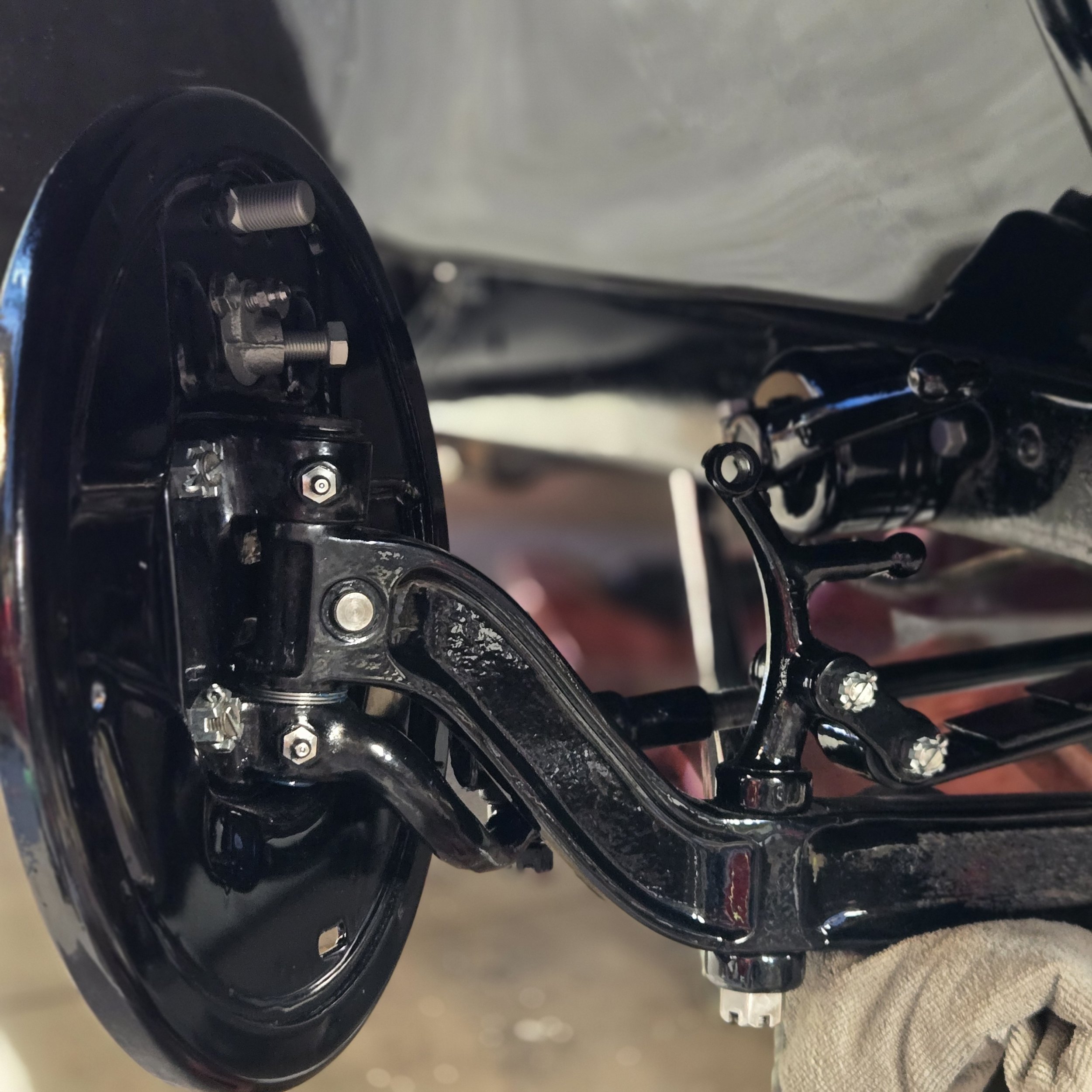

    Worked on the front end upgrade project this weekend.
    Primed and painted the front crossmember as well as the original 41 Lincoln backing plates and "pancake" drums...plus a few small pieces.
    I blasted the insides of the drums, painted them with cast iron paint and then turned them. They were standard size, but had a few grooves and cleaned up at .030" over.
    I had most of the other parts gloss black powder coated. This pile made it almost like a big model kit.
    ***embly started pretty smoothly.
    We slid the frontend under the car and let the weight down on it.
    I put a 7 leaf reverse eye spring in, as I've used that combination several times before, but this one seems to to be a little too de-arched, so I'm gonna add 2 more leaves in and try that. I ended up with 9 leaves in the front of my 5w, so hopefully that gives me a reasonable amount of travel
    Until next time...

    Got the frontend ****oned up today. Shocks attached and everything is snugged up and cotter pinned.
    Now time to put the lower splash apron, grille shell and hood back on. Then get back on the roof project. Need to drill all the holes and fit the tack strip. Then pull it back off, paint it and then get it to my friends upholstery shop to install the new top material
    BigJoeArt, Outback, RMcCulley and 6 others like this.

    I dropped the car off with Tom Sewell yesterday morning for the new top insert.
    And picked the car up at the end of the day, with a new top. I did need to finish screwing down the tack strip and putting in the rubber cord
    It was too late last night to get pics, so I rolled it outside this morning before heading to work

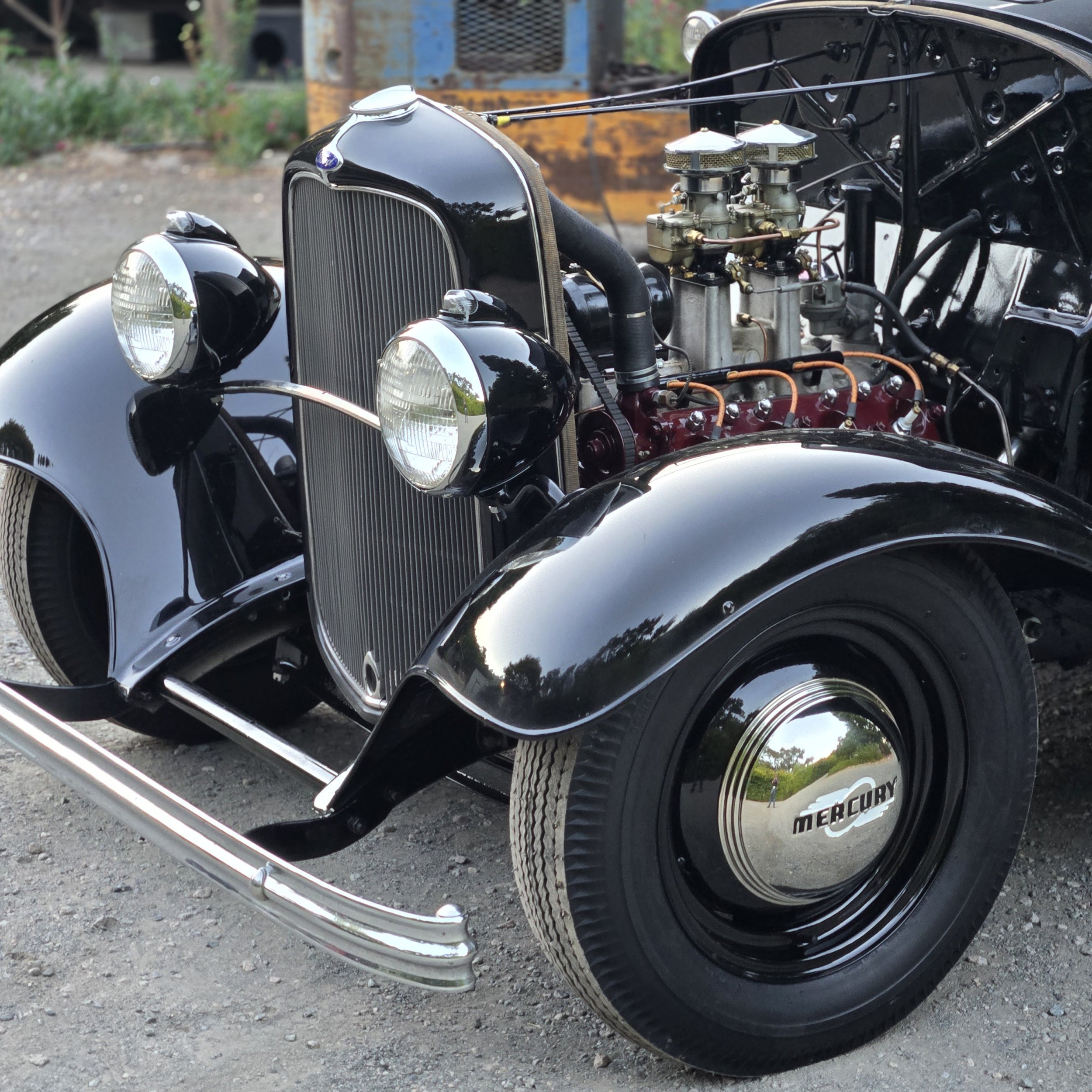

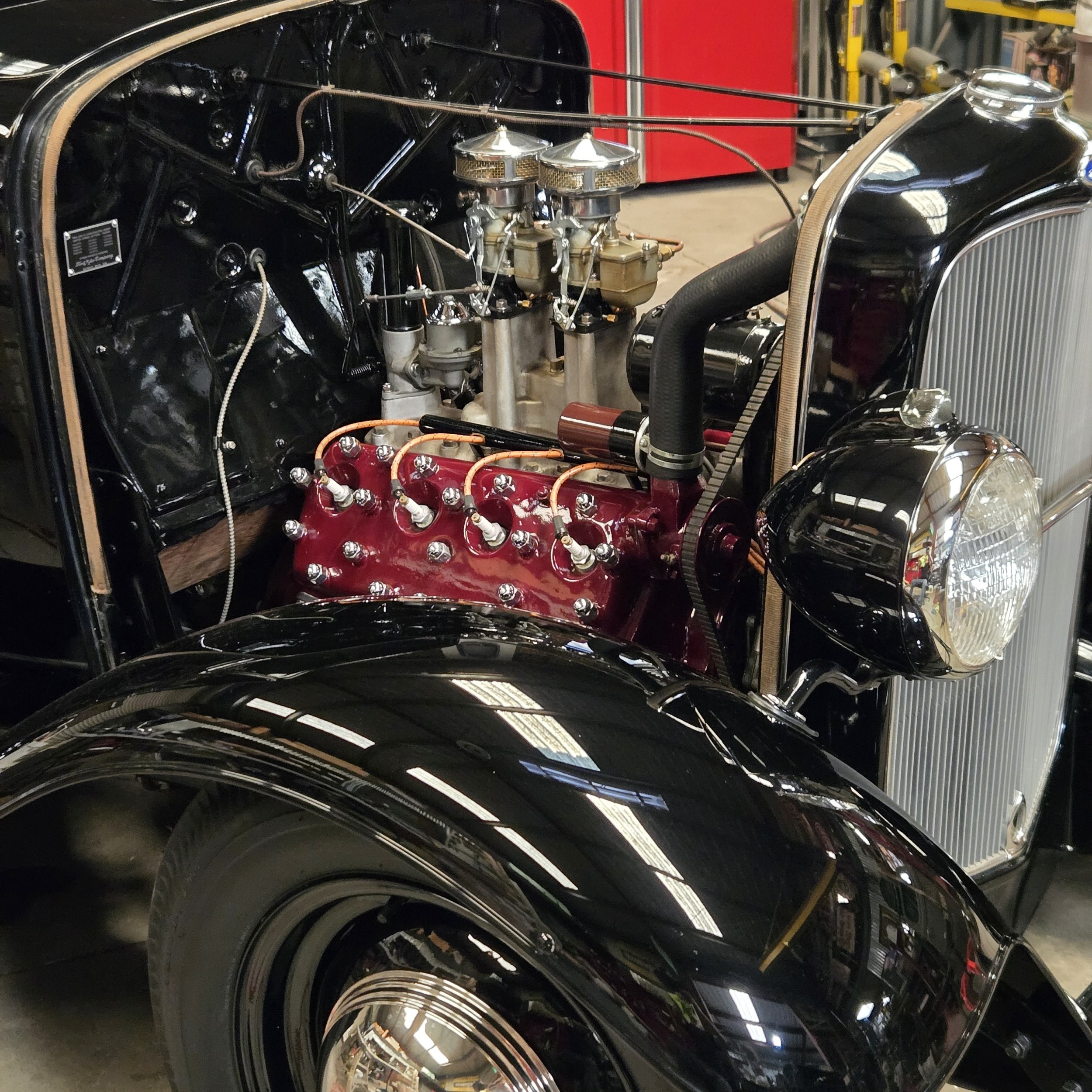

    Repaired/replaced broken front crossmember with 1" drop center grafted into original 32 crossmember, retaining the stock motor mounts.
    Replaced dropped Model A axle with dropped 32 axle
    Replaced leaning original spring with aftermarket reverse eye spring. Went from 7 leaves to 9 to gain a little suspension travel. With the dropped crossmember the car still sits a bit lower.
    Went from 40 Ford brakes and drums to original 41 Lincoln backing plates and drums. The 32 axle was a little wider drop than the Model A, but the pancake style drums narrowed up the track width, centering the front tires nicely in the fenders.
    Dropped the tierod for crank pulley clearance due to the dropped crossmember
    Upgraded to new Rotoshim shock absorbers with shorty shock links
    Powdercoated frontend plus bumper irons (went to shorty rear irons) and speader bar.
    Removed horn, front license plate/bracket, cowl lights and greyhound radiator cap.
    Changed headlights from chrome BLC 903's to painted 682-C's.
    Wheels changed from maroon Kelsey Hayes wires to 40-48 Ford disc wheels, powder coated black with 47/48 Merc hubcaps. 16x4 front, 16x4-1/2 rear, still with 5.50 and 7.50 Firestones.
    New top insert, replacing the old Hide-em trim strip with an aluminum tack strip bent to fit.
    That's about it for this round, but this car has been a continuous improvement project over the last 13 years, so I'm sure there will be more changes in the future.
    They are never done!

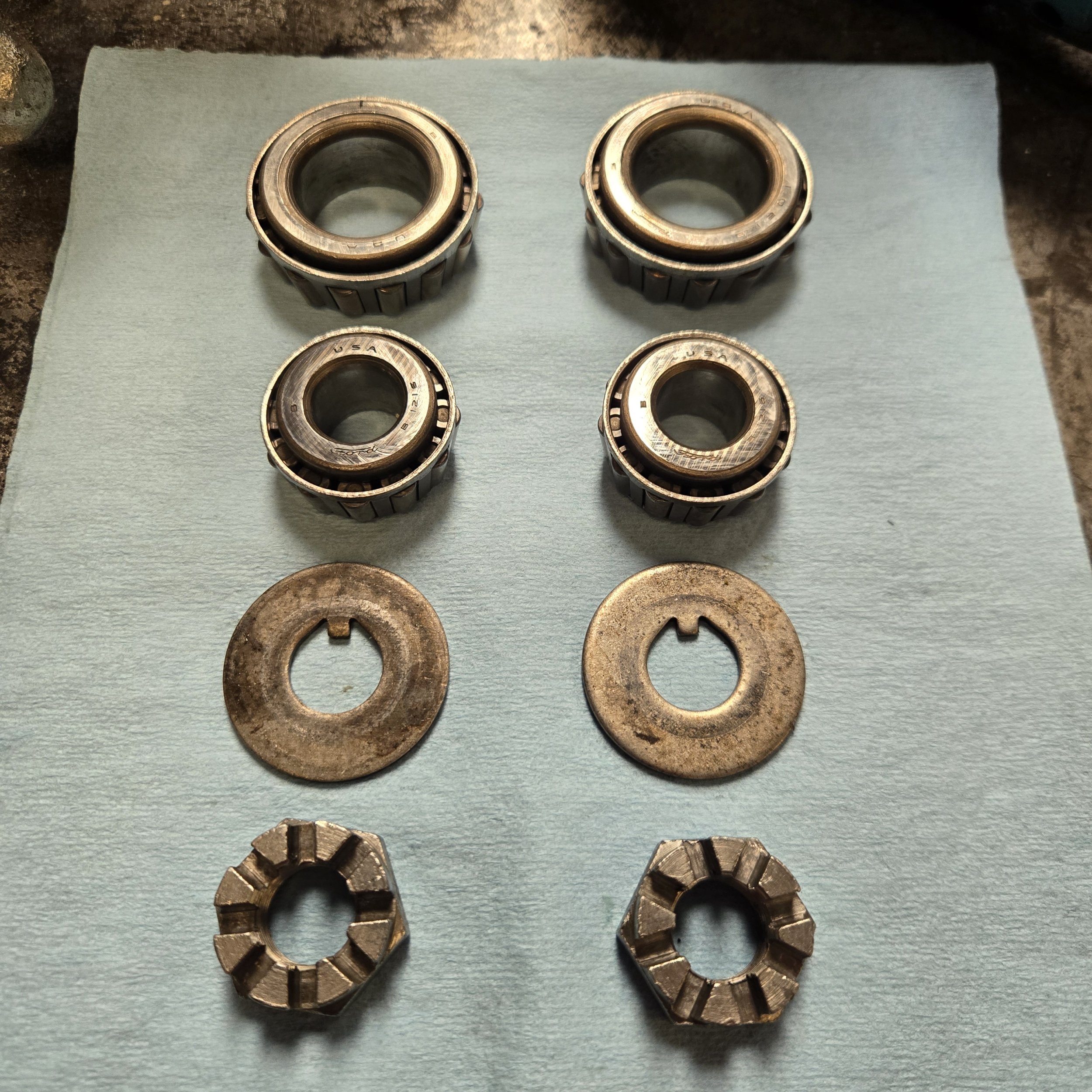

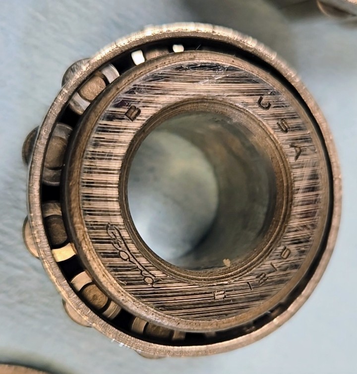

  30. alchemy
    Joined: Sep 27, 2002
    Posts: 23,467
    alchemy
    Part numbers for the Torrington bearings and shims on the spindles?
