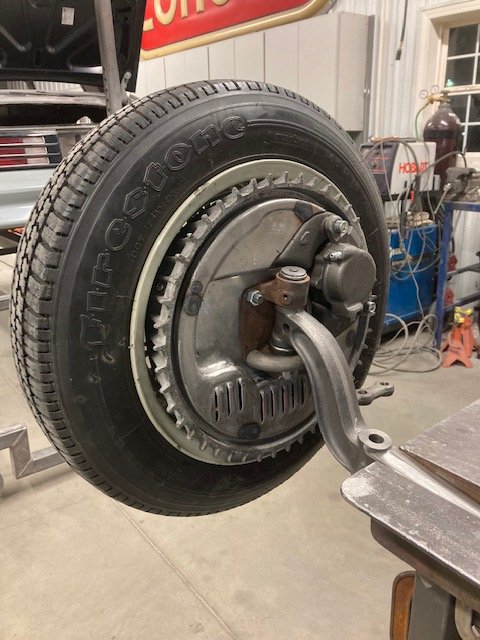

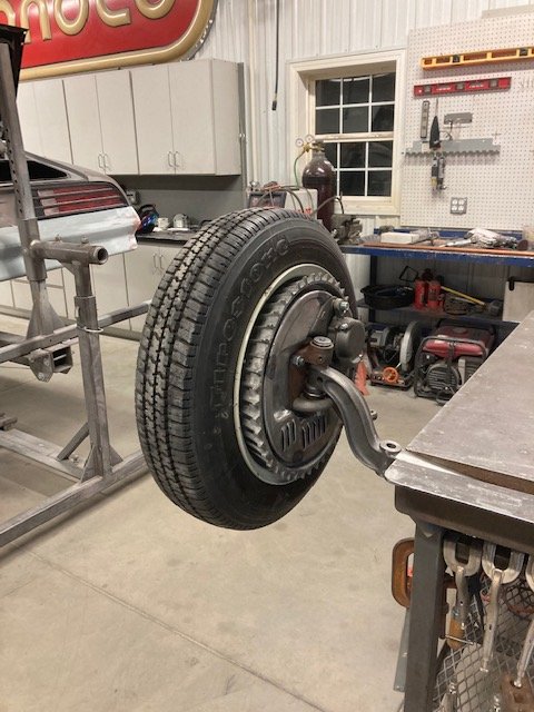

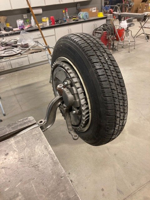

    I thought I would give it a shot with a pair of junk Buick drums I had. It took some time to lathe out the old cast liner but I got it done. something different and cool!!. faux buick cover.jpg faux brake cover 2.jpg faux brake cover 1.jpg faux brake cover 1.jpg faux brake cover 1.jpg

    [QUOTE="I thought I would give it a shot with a pair of junk Buick drums I had. It took some time to lathe out the old cast liner but I got it done. something different and cool!!.
    Cool idea on the Buick drums! Can we get a picture of your set up with the wheel removed. I'm not sure I understand the process and would like to know more. Thanks.

    Ty isn't on here very often . If you look at post #72 this will give you an Idea what he did, only he used Buick drums and machined out the centers and the steel inserts for the brakes. This helped reduce the weight.
