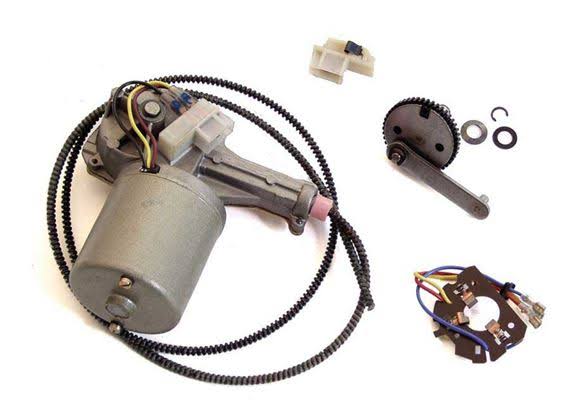

    I can't see any photos to dig up a comparison.
    but most of those vacuum to electric conversion kits [with a reciprocating motor] use a Marine Wiper Motor. [eg: Newport]
    You can get them LH or RH , and with different shaft lengths. [see photo]
    These motors can have the sweep adjusted [up to 120 deg] and also be adjusted to park L or R
    And are 2 speed.
    If you want intermittent , there is a 3 position switch available to do this [but usually $80-00 +]
    Available on Eay from about $35-00 up.
    If you want a Wide sweep ,direct motor [wiper blade direct to the motor] start looking at rear wiper motors from SW's.
    My husband used a rear wiper of an English Ford Sierra SW on his race car [he tinkered with it so it would park in the central vertical position for racing]

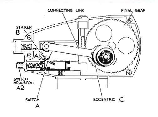

    @Mimilan I dont think I fully understand (normal for me) are you saying I can convert a marine wiper to cable drive , to make a marine motor drive off the eccentric arm like these?

    Marine wiper motors have a splined shaft that is reciprocating back and forth. An external lever for a cable could easily be fabricated.

    If you chase down a MK2 Austin Mini [1968 or newer] they self park and are cable drive.
    Most of the self park faults are in the actual wiper switch.
    When it is switched off, the park wire should be live [so the wiper can switch off internally] When the wiper switches on, the park switches off.
