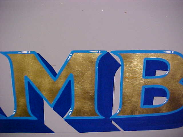

  25. OK here goes the last part:
    There are two basic types of shadows to add to lettering;the so-called,"perspective"shade(which I am using)and the,"drop"shade.The perspective shade is constructed so that the letter appears to have dimension to it whereas the drop shade makes it appear that the letter is floating in mid-air.
    The layout of a drop shade is easy if you have made a pattern for your letters:you just take the pattern and set it over the lettering so that it is slightly lower and either left or right of the lettering on there.The perspective usually(but not always)requires laying out all over again(see first pic).
    Another difference is that the color for a perspective shadow should be a complement of the lettering color where a drop shade is usually a darkened version of the background color.Not a hard and fast rule but a good place to start.
    The layout I used(and normally use)has the perspective lines at a 45 degree angle from vertical.You may use whatever angle you like but in my opinion 45 degrees works best.I also try and make the shadow equal in width to the widest element of the letter.You can vary this for special effects but again this is agood place to start.
    On larger lettering I would have used a regular lettering quill(chisel-edge)but as these letters are only 2" high I opted to use(what else?)my Swirly-Q!
    I also only used one color for the shadow but old timers liked to do a 2 color one with serif areas shaded further and a 2 color outline to simulate light spots reflecting off the high side.You can really get carried away doing this and sometimes it can be hard to stop.If you're getting paid for it,it's better to keep it simple because few customers can really understand justifying an outrageous bill.
    So the shadowing is done and all that's left is to add the "hot spot" which is nothing but where a light source would reflect on the surfaces.I use a 10 o'clock position for all my light sources which on a concave surface(such as a serif or the inside of a round letter)usually reflects at about 45 degrees.Makes it easier to place my reflections.
    And finally you see a close up of the letters and an overall shot.All that remains is to clear everything(after removing all the guide marks of course being careful not to touch the gold)and the job is complete! FINALLY!!!!!
    Of course I've barely scratched the surface of the art of lettering but it will give the neophyte an idea of what to do and maybe give some insight on why real gold leaf lettering is so expensive.
    Thanks for bearing with me and I hope you all enjoy it as much as I did putting it together.
    Ray Smith(one day into "coothood")
