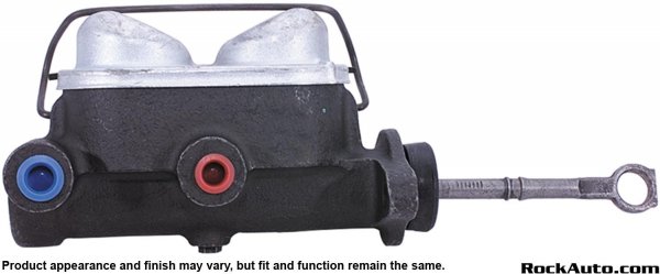

    I have a dual resivoir master cylinder I recently picked up. It is missing the guts to it. The only numbers I can find on it are 2225 01P. I can’t find anything online to reference it to to get the parts I need. Anyone have any old parts books that might have these numbers listed?

    where/why did you pick it up? what are you planning to install it on?

    Looks to be a Ford to me around a 68?

    looks a lot like a late 60s ford drum/drum master cylinder
    here's a 68 mustang type...but measure the bore size

    I’ll measure the bore size in the morning when I find my calipers [emoji50]

    From 85 Wagner catalog, only ones I saw with close to that casting number. Probably chart #27 if the bore/outlet sizes match.

    Looks like AMC , from a Jeep to me . I just installed one and the old bypassing one may still be laying there . I’ll look tomorrow for you . AMC doesnt mean it’s not Ford or any other manufacture , they used parts from many others

    I did a quick tape measure check on the note. Looks to be 1 1/16” inner diameter. Not including the slight champher around the opening. The catalogue lists a 1 1/8” bore. ???

    What other numbers are on the cover? Sure looks 60s and up Ford to me
