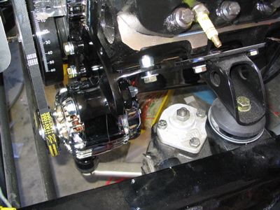

  1. Here's my home-made alternator mount. I didn't want an ugly alternator sitting up on top of my engine or hanging out the side, so I got this little chrome 60 amp Nippondenso one that I think came originally on ~86 to ~89 cheap models of Toyota and Suzuki cars (Swift and Samurai I think). There wasn't room for a bigger one down there between my steering box and the engine block. I hung it sort of upside down from how it would normally be mounted, with the fixed bolt on top and the adjuster arm on bottom.
    I just figured out where I wanted it and put it in the location where it would have the most swing for adjusting the tension on the fan belt. Then I cut up pieces of a thick manila folder to figure out how to make the brackets. Once I had a cardboard bracket that worked, I made it out of steel.
    I made the main bracket out of 3/8" steel plate. I made the "cup" part at the top of it out of a slice from the side of some steel tubing with two plates on the ends. I left about .050 clearance in between the end plates and the long mounting boss on the alternator so that it would be able to swivel for adjustment at the top end. After making the main bracket, I bolted the alternator onto it and made a template for the lower bracket and cut that bracket out of 1/4" steel plate. When I figured out how far forward the lower bracket needed to stick out from the first bracket, I made some spacers out of some thick wall DOM tubing, which I welded onto the first bracket. It felt really solid, but I didn't like the idea of having just two 3/8" bolts hold the whole alternator mount to the engine, so I made a 1" x 3/16" tab that headed out the rear, and then made a separate 1" x 3/16" bar that linked that tab back to the front motor mount bolt. It's solid as a rock now. I sanded things smooth and painted it with some engine enamel.
    Yeah, I know -- Nippondenso isn't exactly traditional hot rod material, but tucked down there by the steering box, it'll go pretty much unnoticed.

  5. Yep, small block Chevy and a Vega box. The cardboard patterns already went into the trash, and I have mounted the alternator onto the engine hopefully for the last time, so sorry no patterns. But maybe those pictures will give you a head start making your own.
    When I bought the alternator at a swap meet, the booth selling them just referred to it as a "mini 60 amp". It's made by NipponDenso. It's even smaller than some of the other "mini" ones that I saw in other booths.
