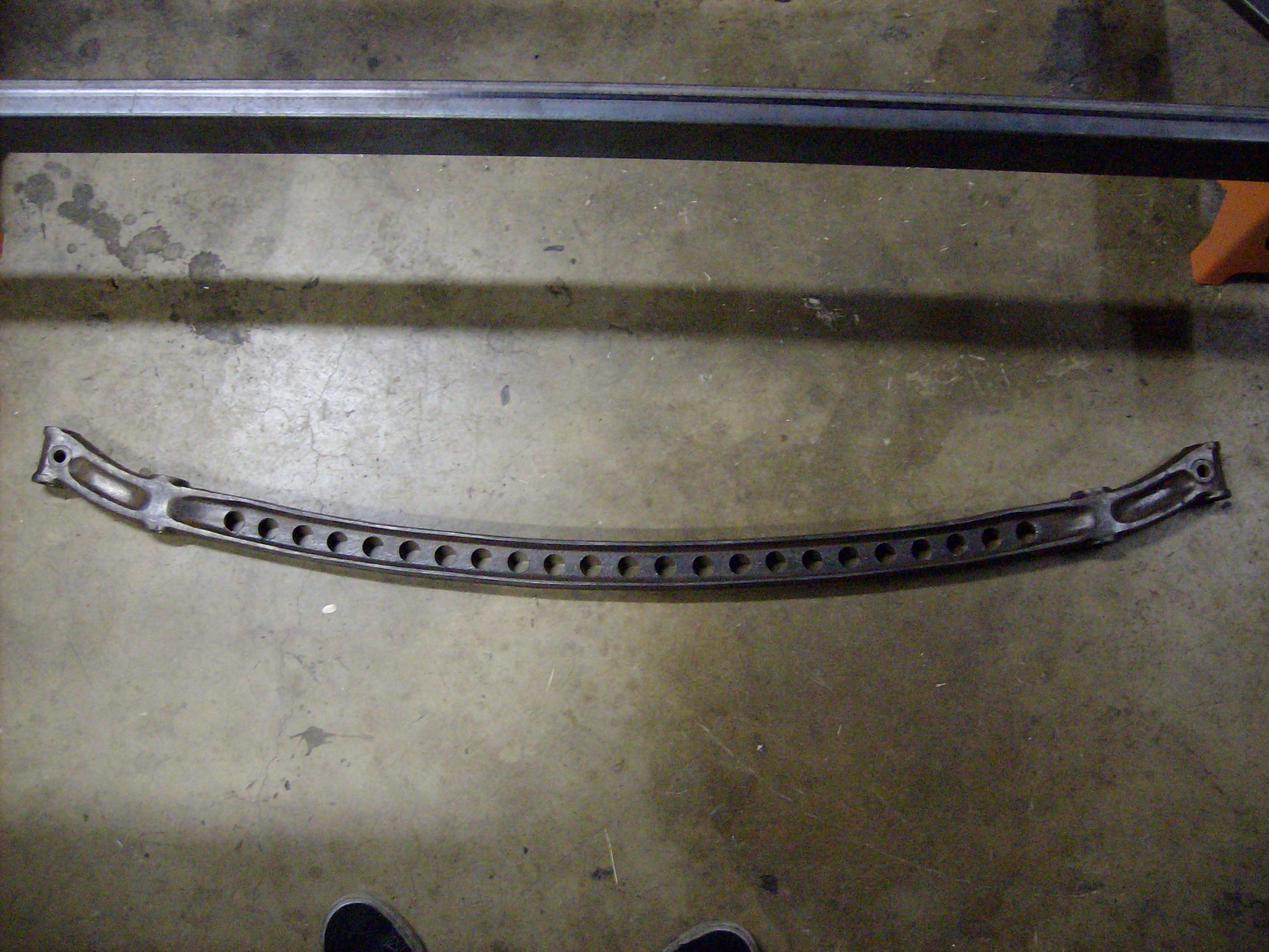

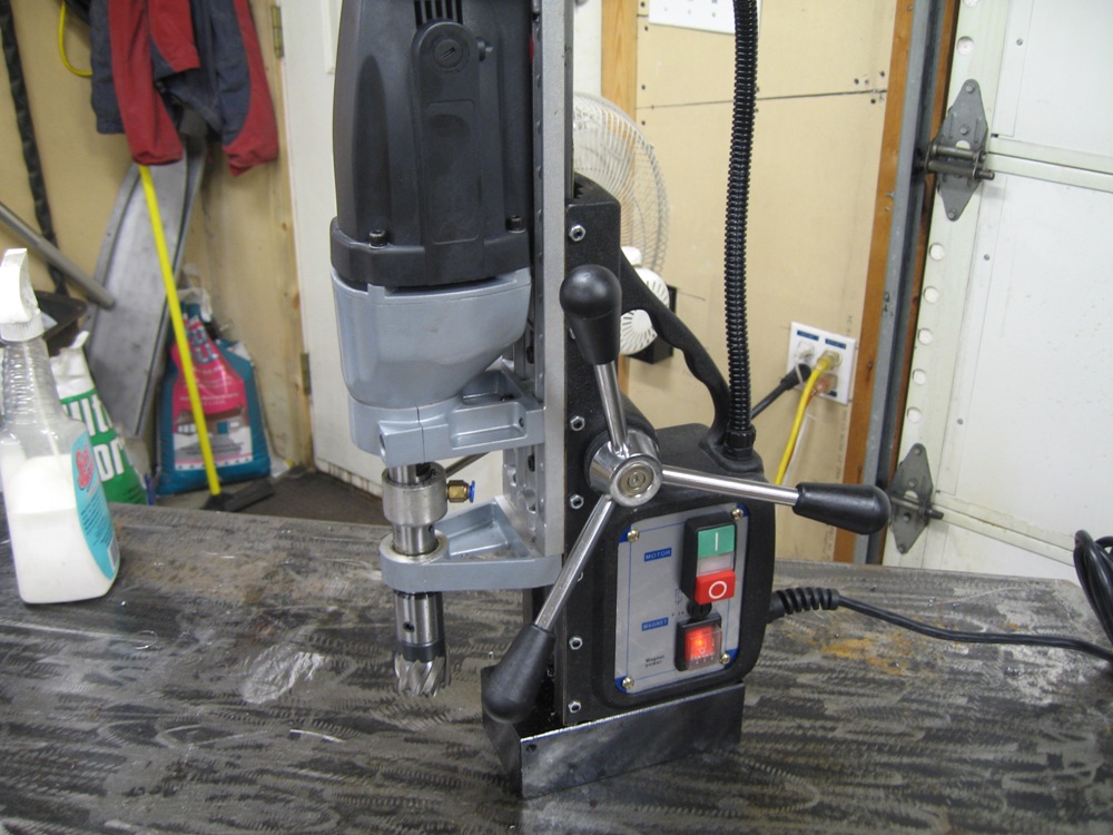

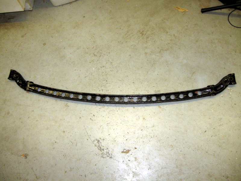

    I used this thread and techniques twice already when I drilled axles for my 26 RPU.
    First was a Magnum 46" cast axle which turned out nice, next was the So-Cal forged axle I bought to replace the cast Magnum axle.
    I used a Mag based drill ,the first one I borrowed from work, then my own bought off e-bay.
    I also used an annular cutter, they are a kind of high tech hole saw and make a really nice hole that requires very little clean up.
    You can see one of the slugs sitting on the table in one shot.
    Lots of milky white water soluable oil was used in a squirt bottle to cool and lube the cutter. You can see I drilled the one hole in the cast magnum axle dry. Big mistake, no lube and coolant will destroy an expensive cutter quickly. I got away with one hole, grabbed the coolant-lube and carried on.
    You can see the bottle of coolant sitting on the table in one shot.
    Clamped the axles down to my steel fab table, the mag base drill is really a great tool as it holds itself in place.

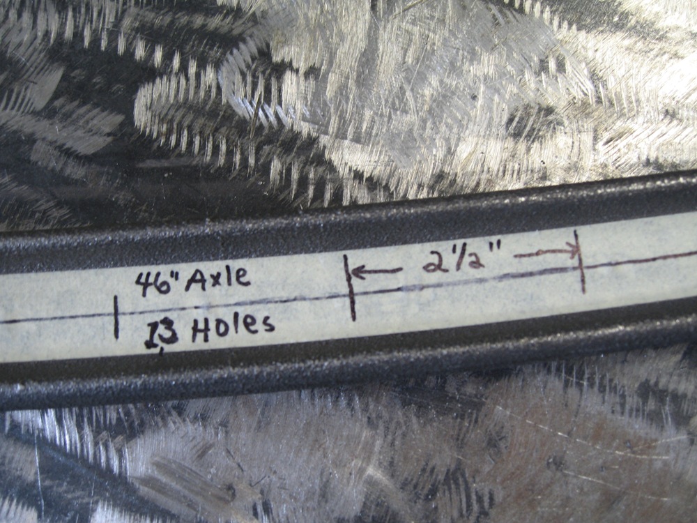

    I drilled the Magnum axle with 13-1 1/16" diameter holes on 2 1/2" centers with one hole dead center.
    I drilled the beefier forged steel So-Cal axle the same way and number of holes, same spacing, only the size is different, 1 3/8" dia.
    Thanks for the tech, here's some pics of mine. In order, first the Magnum axle, then the So-Cal.

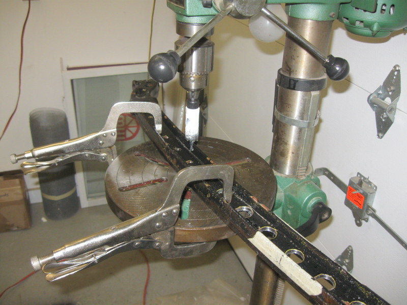

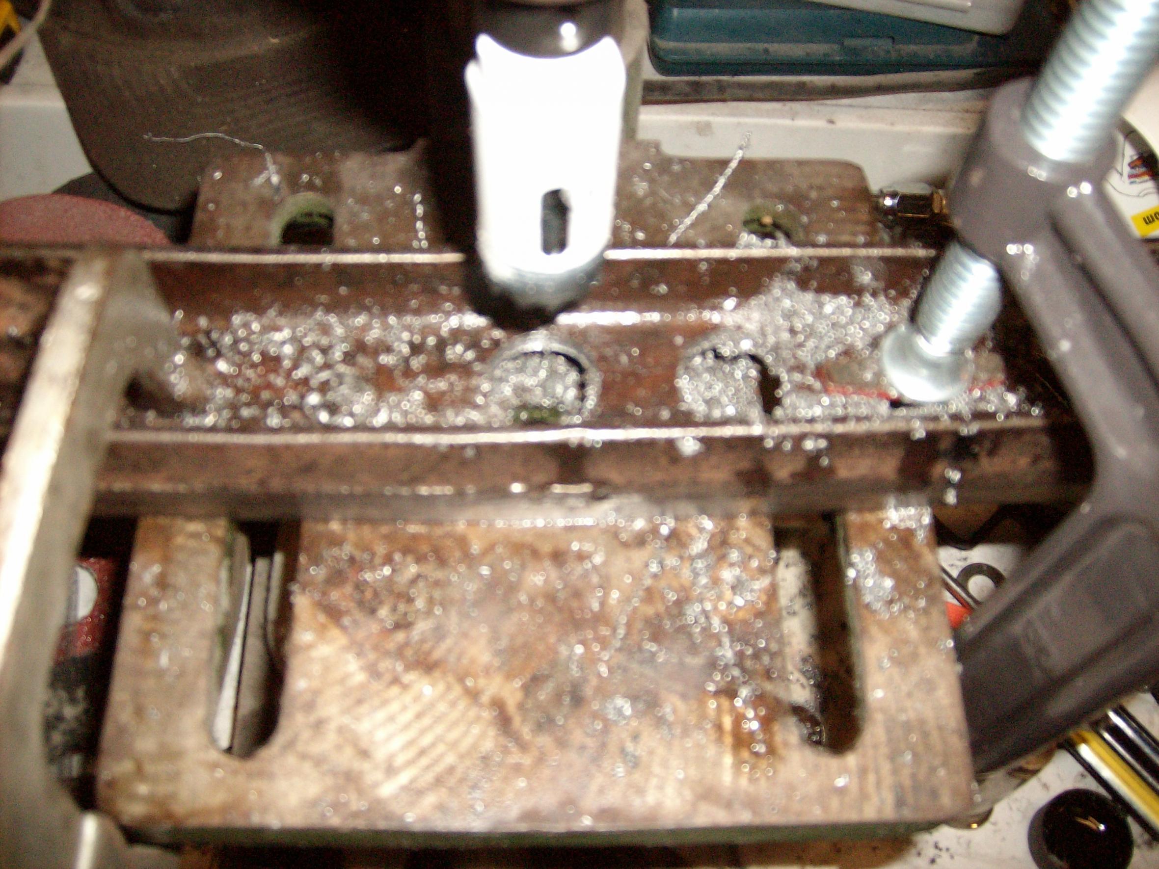

    Time to resurrect this thread for newbies. I'm glad I read this BEFORE my machinist buddy told me I couldn't drill my axle with a Home Depot hole saw on a Harbor Freight drill press.
    My axle is less than straight, so using the wood wasn't an option. Clamping to the drill press table worked fine.
    Nineteen 7/8" holes in my '48 Ford axle saved 1 pound (the web is 1/4" thick). Not much weight savings for a lot of work but hey - it looks bad***!
    Thanks, scootermcrad, for the advice and inspiration.

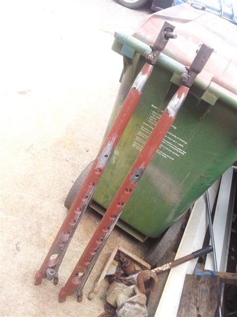

    Found this thread a while ago after I marked my first axle out. I went about this a different way in the drilling process- I have a Bridgeport in my shop so its a fair chunk easier. I used a rotabroach to cu the holes, more expensive than hole saw but gives such a nice cut. I just posted this on another forum so I thought I would add it here too, hopefully others can learn from this little snippet of info too. Great way to dress up a cheap axle for a smaller budget car/special
    Drilling in 60 seconds- CLICK TO PLAY
    [​IMG]Un***led by the pinstriper, on Flickr
    Little video snippet of real time drilling, I cut the entire axle dry so I didn't lose any marks I made. The cutter didn't blunt at all, you can see how controlled the process is opposed to a hole saw. I found no tough spots- maybe I was lucky, or maybe its because of the cutter itself.

    I tried to drill these first time round, no shock the drill walked a bit. Opened up after with a slot drill, again you could use a rotabroach in a pillar drill for this. I would advise roughing this out with a drill first due to how thick these sections are

    Layout Die, Scribe, Center Punch, Pilot Drill...
    3 or 4ea. Cheap Chinese Hole Saws from E-Bay...
    My drill only goes down to 300rpm...needs to be slower!!
    Lotso Lube!
    Look at the thickness of the center rib on the ch***is-engineering axle compared to stock!.
    BONES?
    FYI. These Holes Saw' **** at 300RPM!!..like to wobble a bit!
