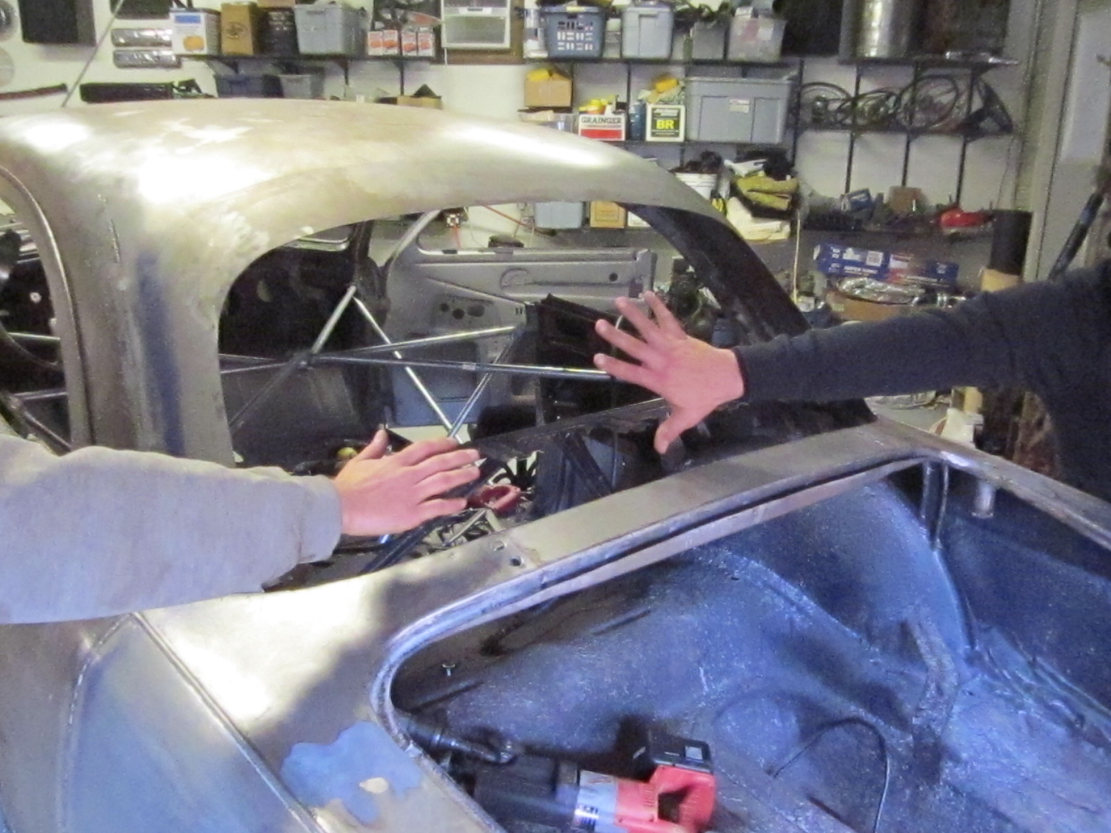

    The original layout was to take 4" out of the a-pillar and 5" out of the c-pillar. Subscribing to the theory that it's easier to cut more out later than to put it back in, we decided to start with 3" for the a-pillar and 4" for the c-pillar.
    To avoid the overly fat c-pillar look we made a paper template of the factory c-pillar to compare to after lowering the roof.
    kidcampbell71 likes this.

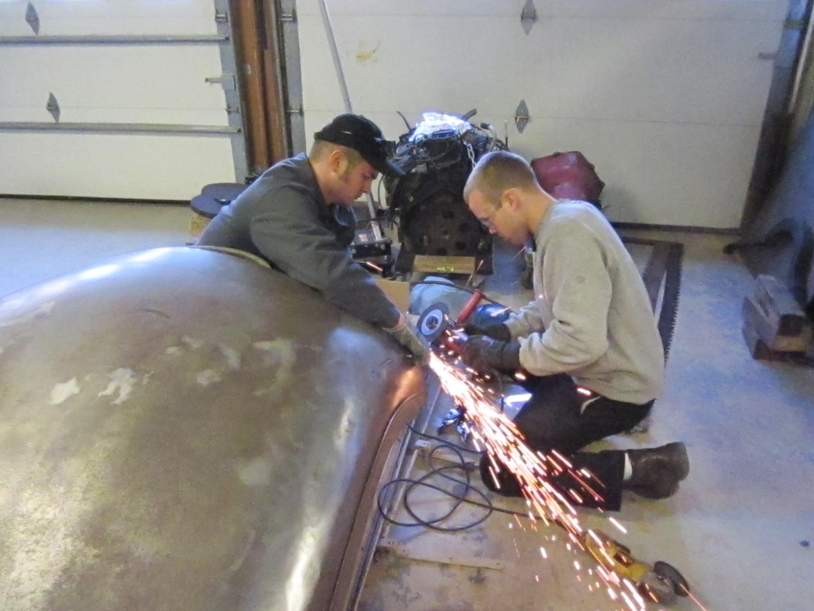

  19. It was then time for the ceremonial first cut. Scott being the hardcore traditionalist that he is, wouldn't let us use any power tools.
    After the door tops were removed, we cut out the b-pillars and rear window corner pieces.
    After a few rounds of rock-paper-scissor, Dave crawled his way through the bracing and cut out the interior brace for the back glass.

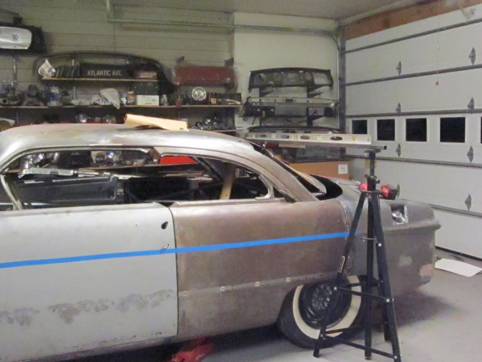

    Here it is with the roof set back on with the 3"/4" chop.
    It NAILED the look I want for the car. Glad we started on the conservative side!

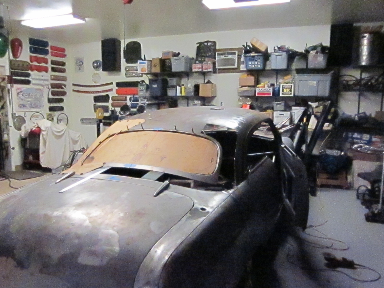

    It was then time to figure out the rear window placement.
    A little trimming here and there...
    Rear window mock up with some paper giving a general idea of the plan ahead...
