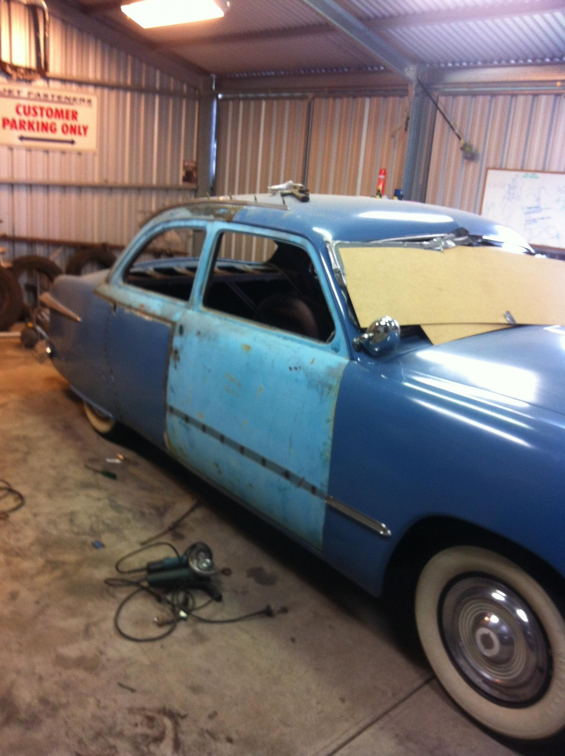

    very masterful,, straight pillars. Usually I prefer slanted pillars but what hapens with a 2dr sedan is that it shortens the mass of the door glass and stretches the mass of the 1/4 glass and makes the area of the two pieces of glass nearly equal and that doesn't look right, just my two cents.

    In your photoshop renderings, the straight pillar looks best. I've seen other cars that looked great with a slanted pillar, but it seems like your particular chop calls for straight.

  19. 50Fraud, thanks for the pics! I'm almost certain I'm gonna go with straight b-pillars.
    It's weird, the car looks SO much different in person than in the pics, the straight pillars really change the entire the look of the car.

  28. Do not adjust your monitor, the pictures you are about to see are REAL! :eek::D
    Got the corner tacked in.
    And the answer to the long awaited B-pillar question is.....drum roll please.....
    Measure twice...
    There's just something satisfying about cutting through a B-pillar with a bandsaw that's as old as the car.
    Hmmm, this might get a little tricky...
    Still needs a little trimming and fitting but I think it's in the ballpark.
