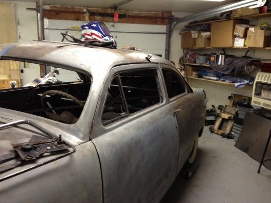

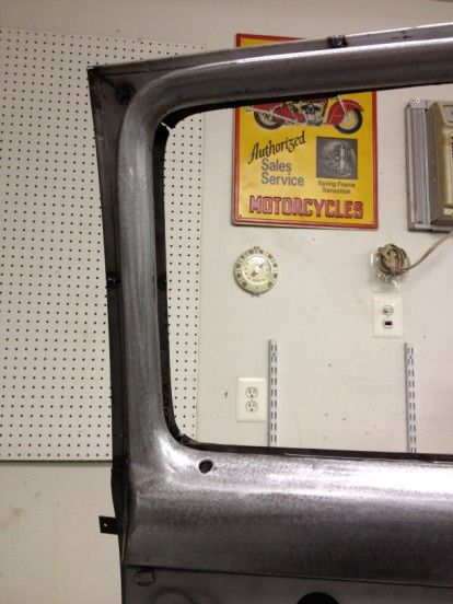

  11. Then I got all zoned out and didn't take any pics. Here's the door top tacked on and test fitting the vent window..
    I cut the vent window frame and got it tacked together...
    Ooooh, it even works!
    Now, I've got a question for YOU! When I sanded the "chrome" off the vent window frame, I said to myself, self, "that doesn't sand off like regular chrome?" When I tack welded it, it didn't look right either.
    After a quick HAMB search it appears the vent window frames are stainless, oops! So my question is, does that vent window frame need to be relocated to the nearest trashcan? I assumed they were chrome and after welding I'd get them re-chromed but apparently that's not so...so...what oughta I do now? Get another frame and heat/bend it to shape then re-polish?

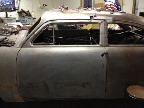

    Ok, back to the show. Here it is all welded up and ground down nice and purdy.
    Even got the inside lined up and finished off decent...
    It needs some fine tuning to get it lined up but it's close enough for now...

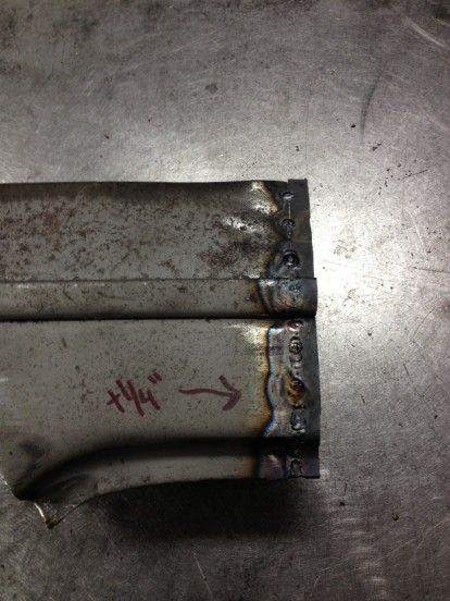

    Garnish moulding chopped and tacked...
    Welded and ground. The top joint kicked my ass, kept moving around when I tacked it, finally took it off and clamped a solid rod behind it to keep it straight...
    I guess it's just as well I screwed up the vent window, I don't like the way it follows the garnish moulding, to much curve on the end. Agree? Dis-agree?

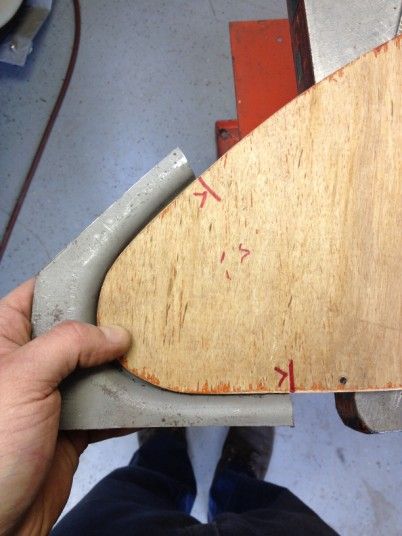

  18. Made a template of the drivers side rear window...
    Transferred it to the pass. side to make sure everything stays the same. I'm glad I did as this side was a little off, a little trimming and pushing and everything lined back up. I clecoed ( I don't think that's a word) it in place so I could have it in the same position after every test fit.
    It will also help get the rear corner in the same position as the driver side and with the same radius...
    I cut the bracing off the back side of the corner piece...
    Then stuck in the shrinker to tighten up the radius...
    That made the back side a little wavy so I put in the stretcher to flatten it out...
    Once the radius was correct I marked the cut lines on the template...
    Clecoed the template back in the window opening and marked the cut lines on the body...

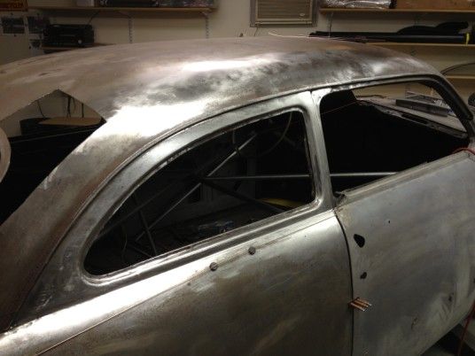

    Here it is with the corner, b-pillar and roof section welded up. Still needs a fair amount of hammer/dolly work on the roof as you can see...
    While letting the welds cool on the roof and window corner, I started working on finishing off the quarter panel seam, gonna come out pretty decent I think...
    Until next time... :D
