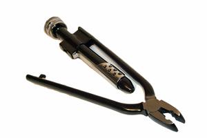

    You can do it by hand, and have a pair of "duckbill" pliers handy to pull your wire taut.
    My safety wire pliers aren't the fancy reversible kind either, so I do the reverse twist by hand, space permitting..........:eek:

    When I was in jet school back in the 70's we were not allowed to use pliers just hand twisting, they said you could nick the wire and weaken it ! After jet school I was ***igned to work on F4's and the first tool they gave us was lock wire pliers.lol I still lock wire all important components.
  21. mattrod68
    Joined: Jan 22, 2007
    Posts: 517
    mattrod68
    almost all the snap on ones now(which are made by milbar) are wavy jawed (non serrated) to avoid nicking the wire.
