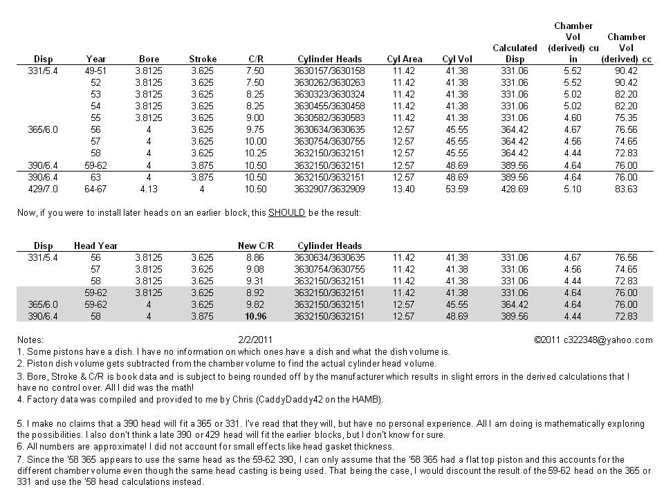

    Well, here's a little spreadsheet I put together today:
    Hopefully some will find it useful.
    <EDIT> Though I have yet to run my new engine, the early 390 head fits fine onto the 331 short block. Reports from others indicate this has been done successfully for years.
    The 390 heads require significant porting BTW. Look in my "New Skool Caddy" thread for info.

    Awesome! Any info on valve sizes? That '58 365 head is interesting. If that has, or can take the larger 390 valves, that would be the head to have alright.

    The info I have is that the '58 had 1.75 Intake/1.562 Dia. Exhaust Valves and the 59-67 used 1.875 Intake/1.50 Exhaust Valves. 58-62 used a stem height of 2.030-2.060. Head casting number 1473449 appears to be used from 58-63.
    Some of the articles I've seen recommend installing SBC valves (1.92/1.50).
    59-62 should be essentially the same as the '58, so I wouldn't discount those.
    Make sure you check out the Hot Rod Deluxe article (http://hotrodcaddy.com/?p=139) if you haven't already. It says that the 390 chambers are 66cc which differs from my numbers a little. Maybe the compression height and head gasket thickness throw off my calculated numbers a bit.

    Something ain't right on your chart---the 58 had 365 ci the 59-62 had 390 ci:eek:

    the top half of the chart shows the stock stuff, the bottom half shows the resulting compression when you swap around diff years stock stuff...what you are reading is the CR gains of putting a '58 365 head on a 59-62 390 block... theoretically should be 11:1.

    Correctomundo!
    Please see note #7 on my chart also. If anyone has info on the different pistons used I can expand the chart to include that info.

    Thank you for putting the effort forward in that spreadsheet...
    My aftermarket replacement 365 pistons came in as flat-tops, although I see the 1958 and up pistons have a 'dish' (more like an ice cream scoop) across the centerline of the piston, not cir***ferential....
    Not sure if this completely answers the mail in your #7, aftermarket pistons are sure to differ greatly...

    Are the top of your pistons flush with the deck of the block?
    If anyone has a set of those dished pistons and has a way to measure the displacement I think it would be helpful!
