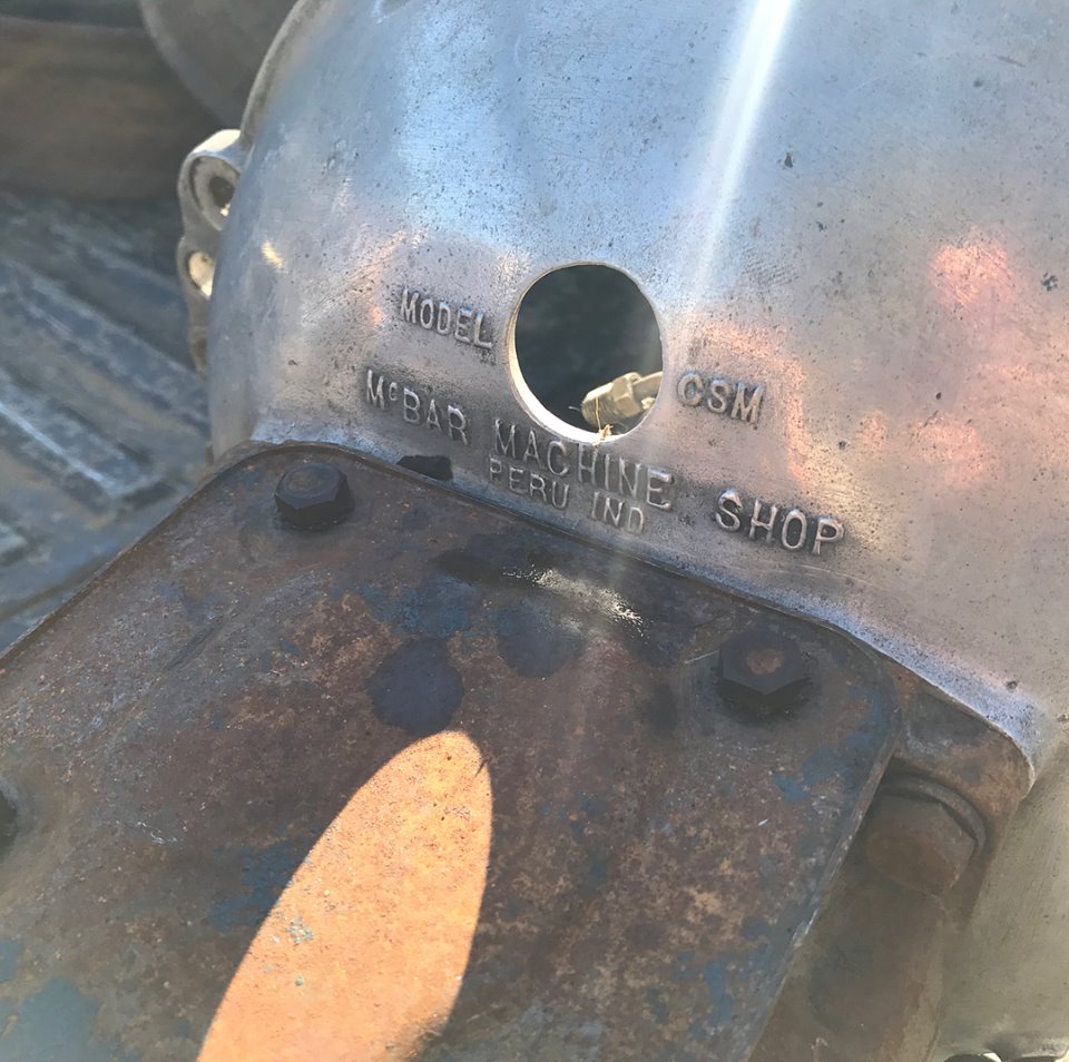

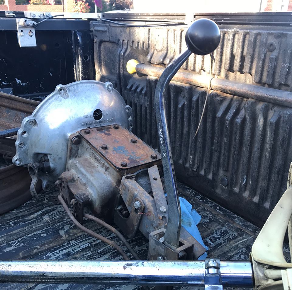

    Cool oddball trans setup I scored at Hershey this past week for my caddy build. Stude 3 spd with a McBar Machine Shop adapter kit and a floor shift. Need to find the March '54 Hot Rod article with details on the installation to keep for the files. Nice thing is the super short tail-shaft compared to the Lasalle. trans1.jpg trans2.jpg trans3.jpg trans4.jpg

    Dang Thanks SO MUCH @Speed Gems ! Gonna Print those out now. DO you have the other pages of the install? Looks like it is continued on page 50? Cool to have with the other paperwork/notes I have written down for the car. Appreciate it.
    Here's a shotof the engine and the Stude Trans hanging in the car. I need to tweak a few things for the floor shifter or tweak for a Jeep shifter top but it should fit in there nicely!
