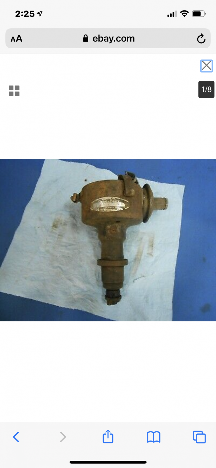

  17. Dogberg
    Joined: Dec 30, 2017
    Posts: 19
    Dogberg
    Thanks, that was the kind of answer I was hoping for!. 55 and later? Is this something useable or is this too late? https://www.ebay.com/itm/1963-1964-...906095?hash=item5d8e45edef:g:zuEAAOSwPMpdL3EL

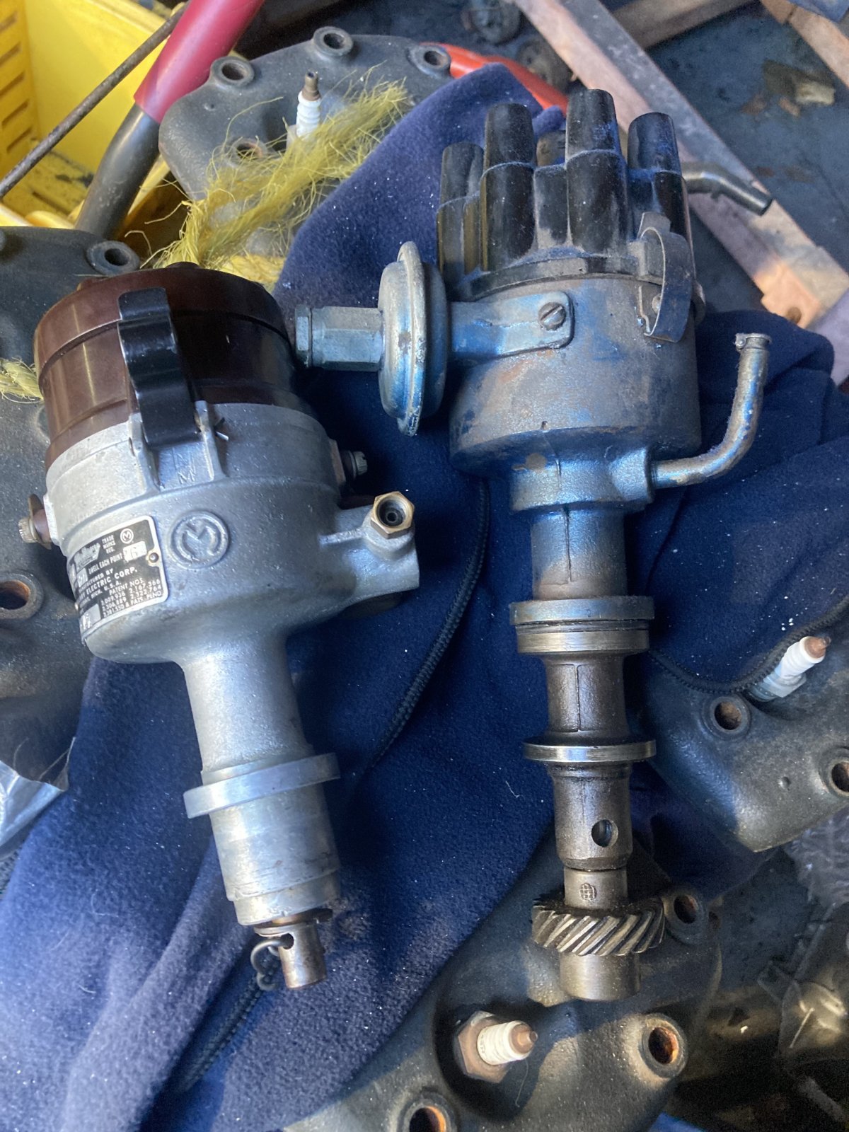

  22. cretin
    Joined: Oct 10, 2006
    Posts: 3,059
    cretin
    I mean what is the difference between all of them. Difference between a ‘49-‘54, ‘55-‘60, and a ‘61-‘62.
    I guess I see the difference between the ‘49-‘54 and the ‘61-‘62 above, but what about inbetween?
    There also seems to be a difference in the size of distributor holes in the block. I have a Mallory that fits my ‘49 331, but not my friends ‘54 331

  25. cretin
    Posts: 3,059
    cretin
    The difference in the ‘49 and ‘54 block isn’t a burr. It s completely different size hole in the block. I’ll try to get photos of it.
  26. Moriarity
    Joined: Apr 11, 2001
    Posts: 37,450
    Moriarity
    SUPER MODERATOR
    Ok I made a mistake. 49-53 have the tang drive and 54-62 have the gear. Sorry for the confusion
    I want to see a picture of the distributor that came out of it too
    Roothawg and cretin like this.

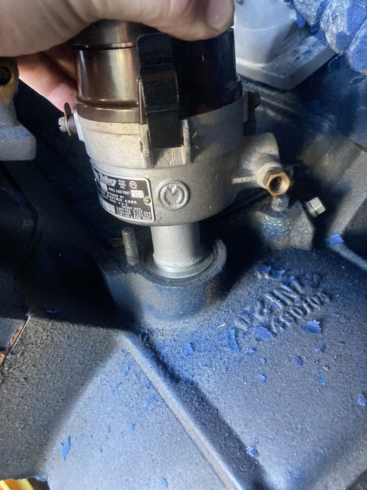

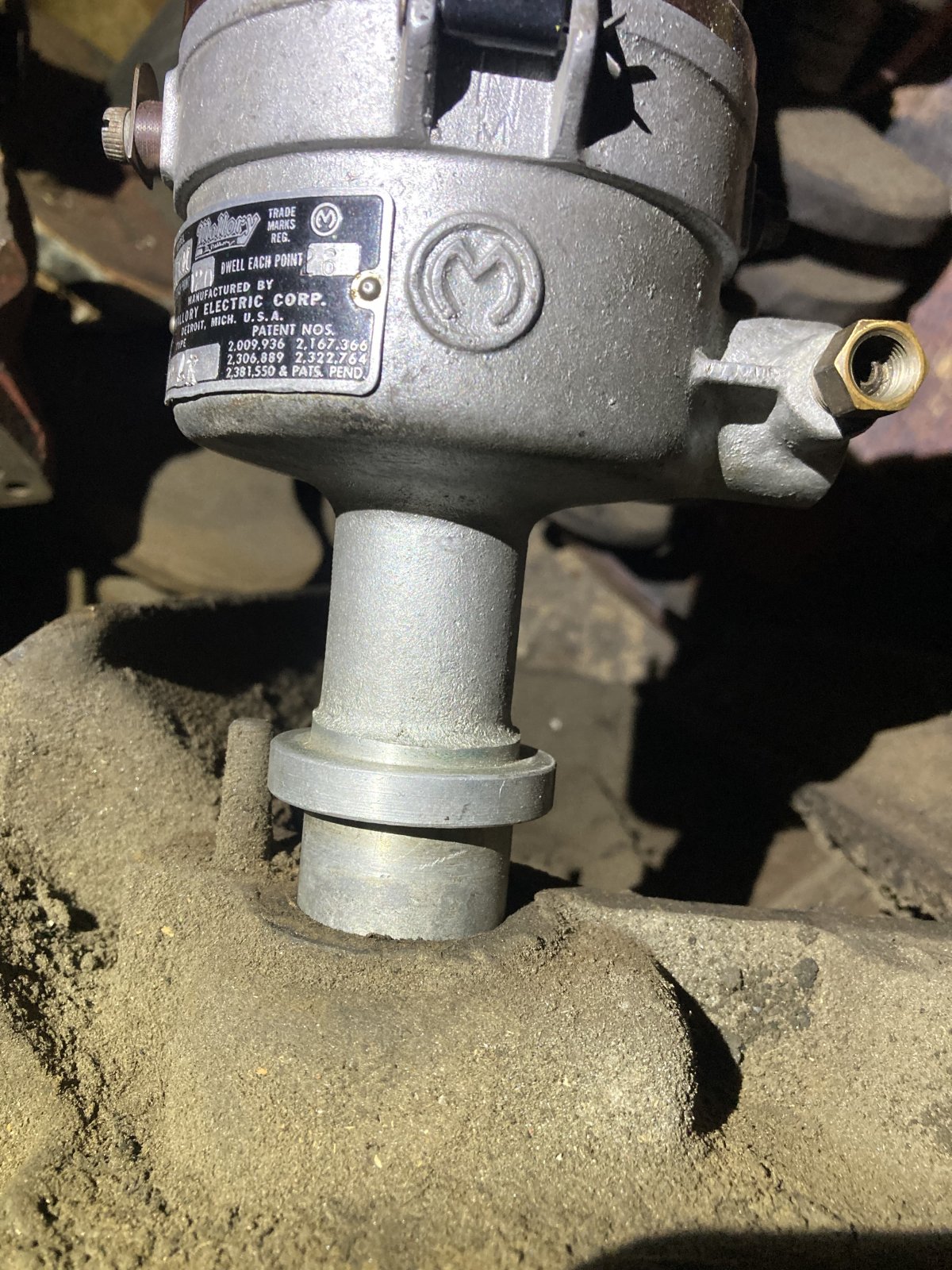

  28. cretin
    Posts: 3,059
    cretin
    Ok so I see what’s going on now. The ‘49-‘53 has the tang drive and therefore, the smaller hole in the block. The gear is pretty large in diameter, so it needs the larger hole.
    So instead of my distributor missing a gear like I had incorrectly ***umed, it’s missing the tang drive. That also helps me know what to look for to replace the distributors for my ‘55 331 and ‘62 390 that were lost in the fire.
    Thanks for the info @Moriarity
    Here are some photos of the situation.
    First photo is the Mallory in my ‘49 block
    Second is it in the ‘54 block
    And third is the Mallory next to the ‘54 distributor.
    9E05F5BC-872F-4E88-90AE-A06C83D53BB8.jpeg 177F6066-BD81-4EC5-8B4B-1F2AE3126643.jpeg 5136AA0C-750E-461E-BC00-E4A8199B8274.jpeg

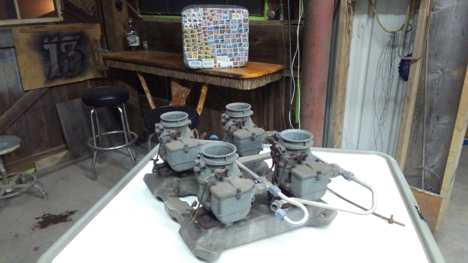

    I bought that set-up in 05... Krazy
    kadillackid and Jet96 like this.
