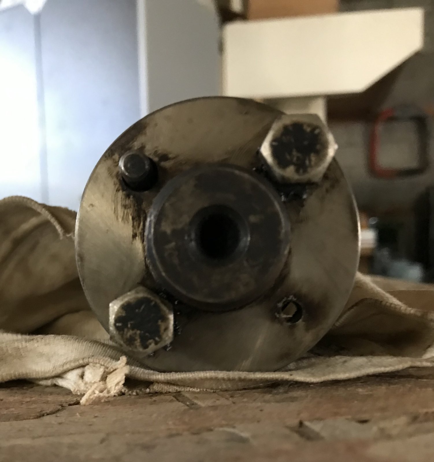

    That is helpful. Thank you. I have that snout on the front of my ‘49 cam too, so that’s making me think it’s a spring loaded cam as well. Hopefully someone can confirm this.
    These are photos of what I have.
    The first two are the ‘49 cam.
    The second two are what I believe is the ‘55 cam.
    However, I know the ‘55 was different than the rest of the 331’s with the flat back block, but I’m not sure of what other differences there may be.
    70DC7E85-1DC0-43A8-81E3-437D16791A5B.jpeg DB7120AB-E6D7-4D4F-8320-A33F17D06748.jpeg 955E45DC-6FE2-4915-B427-B90FEAE5A52C.jpeg 77E067DB-EF8D-4080-ADB6-E0CEB1606D02.jpeg
    kadillackid and Six Ball like this.
  4. Going by memory, the early 49 has about a 1/2” hole in the snout that carries the spring and plunger that runs against the timing cover. If you need it, I’ll pull the front ***embly off the 49 I have and get a pic for you?

  6. Here ya go, only took a couple of minutes, early 49 (12 or 14 week production I think)cam snout, 3/4” bore for the plunger and a pic of the plunger ,spring and the thrust area on the timing cover.
    Hopefully this helps. 821780B7-39E3-4A5F-99B9-8B332B3401F6.jpeg BAE269E5-CEB7-42CF-B3E2-87F8CD6561AE.jpeg 1BB1EC01-E25A-4CDF-B8E6-A0C5E302385A.jpeg AF6D8E9E-506A-4937-ADB5-D46DC6B8557B.jpeg 217EA4C8-C196-41B9-B725-EC4349F03585.jpeg

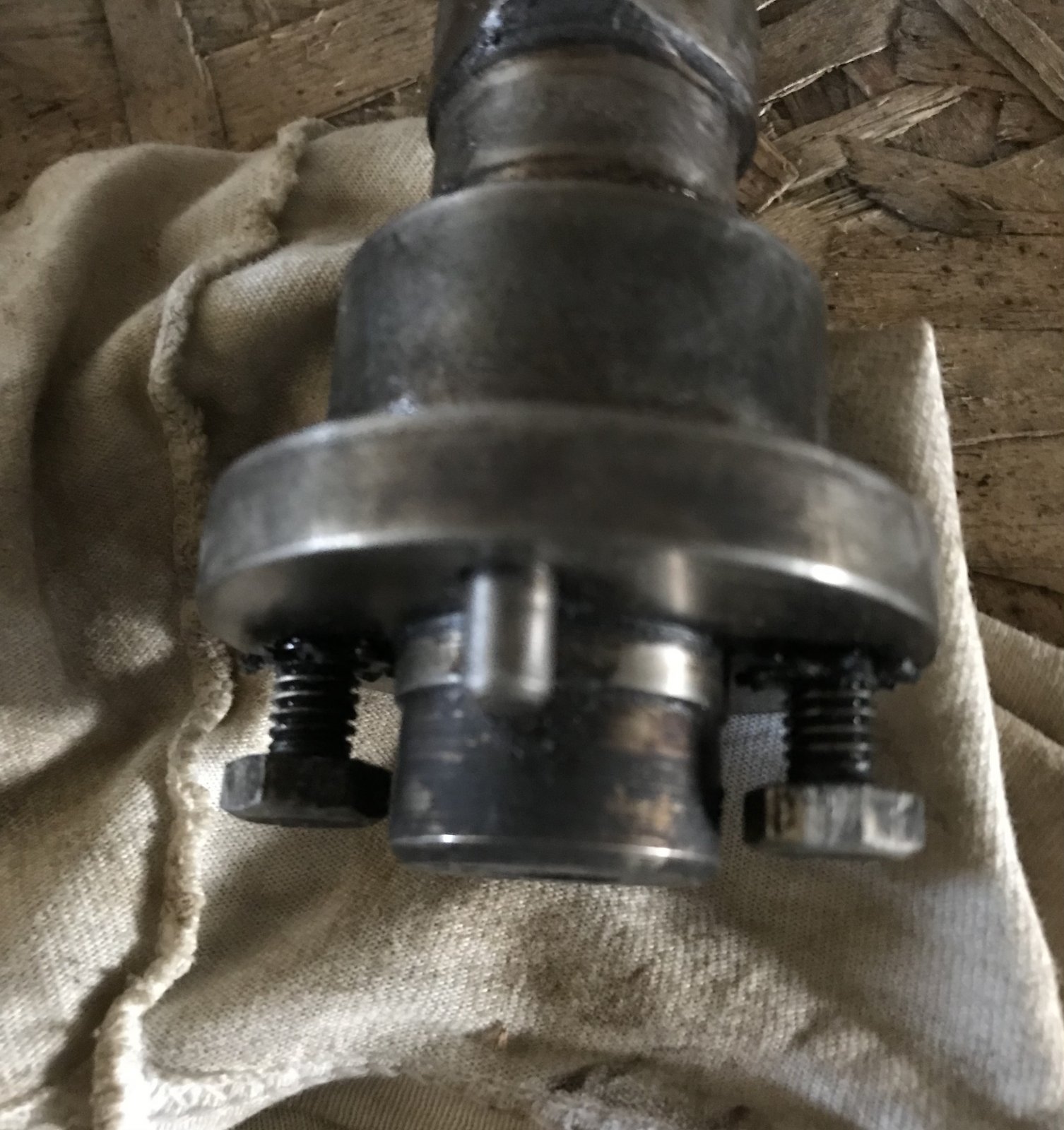

    Ok now I'm not sure what the deal is. My cam and the first one in @****** photos have a 7/16" hole in the center. Mine had no spring at all, just ran against the cover. It appeared to never have been opened up. I wonder if that was an early(early) thing and then they switched to the spring/ plunger setup or vice-versa? E8E036AF-AFA5-40AF-8CB0-97033B541477.jpeg

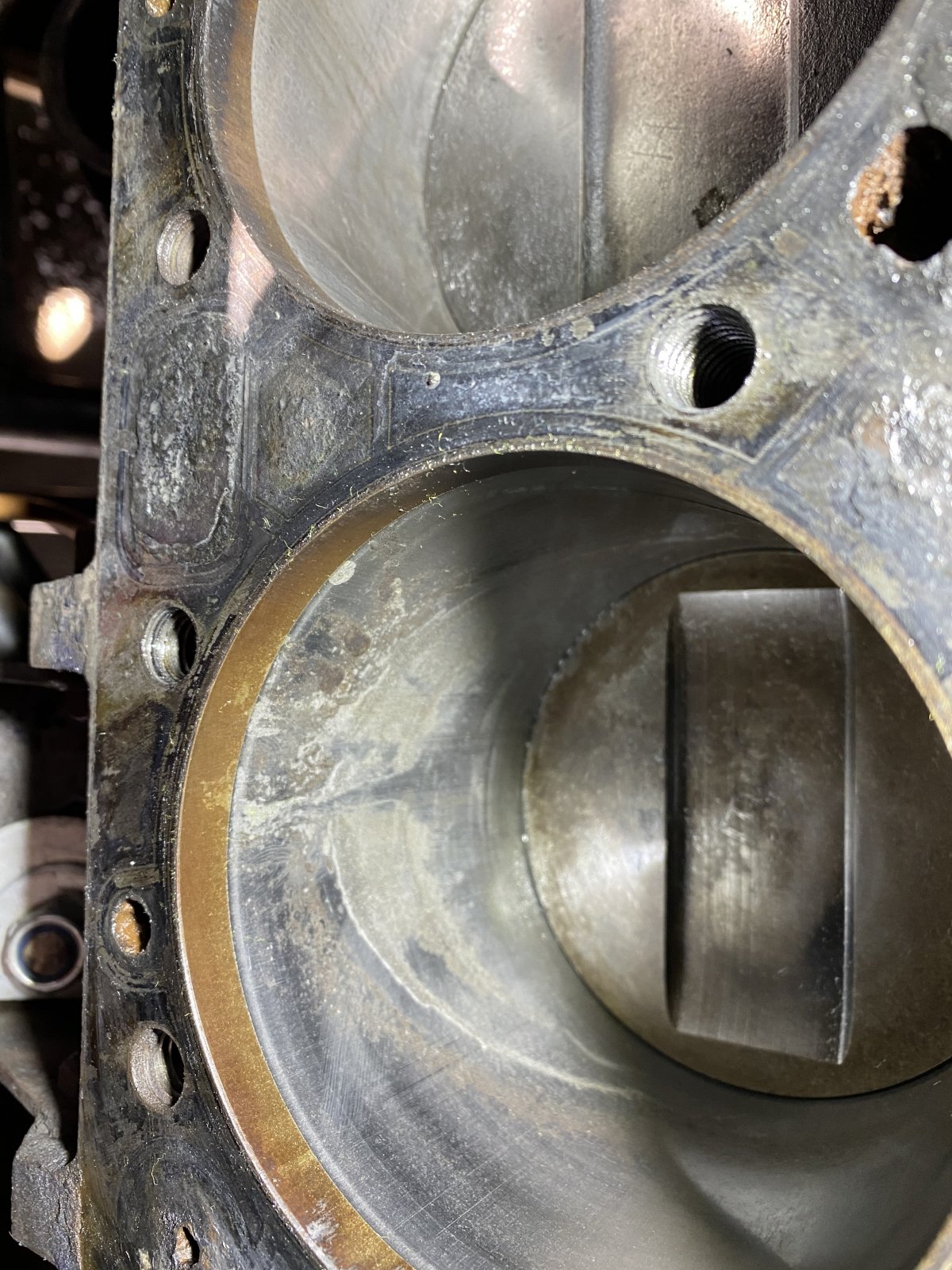

    Hi guys, need some info on the ‘58 365 I got in my ‘52 coupe.
    I got the heads and pistons out and ready to do a quick hone job and put the stock pistons back in with new ring.
    I got the bores checked by a local mechanic and he said that the lip on the top of the cilinders is not from wear but it’s a lip that makes the head gasket seat properly… it sounded weird to my but can someone tell me if he is correct?

    Ridge is from ring wear, not designed into the block.
    Automotive Stud and Moriarity like this.

    Yup, get a ridge reamer and remove the ridge. If you don't there is a good chance of damaging the rings or the ring lands on the pistons....

    If you can catch it with your fingernail it needs to be removed. Your new rings will have sharp edges and can get damaged hitting that ridge. Clean it first and check it!

    i do feel the ridge with my finger but the old pistons came out with a slight tap with a rubber hammer.
    What do you mean by damaging? Is that during installation or while the engine is running?

    damage while the engine is running, the ridge needs to be removed

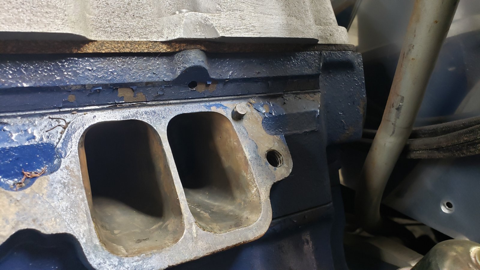

    Are these pins on the heads removable? Most aftermarket intakes dont appear to be cut for them including 2 of the 3 i have on hand. 20230823_202549.jpg

    Yes, they are just dowels.

    Im ***uming i just need a good grip on them then and theyll wiggle out. Thanks!
