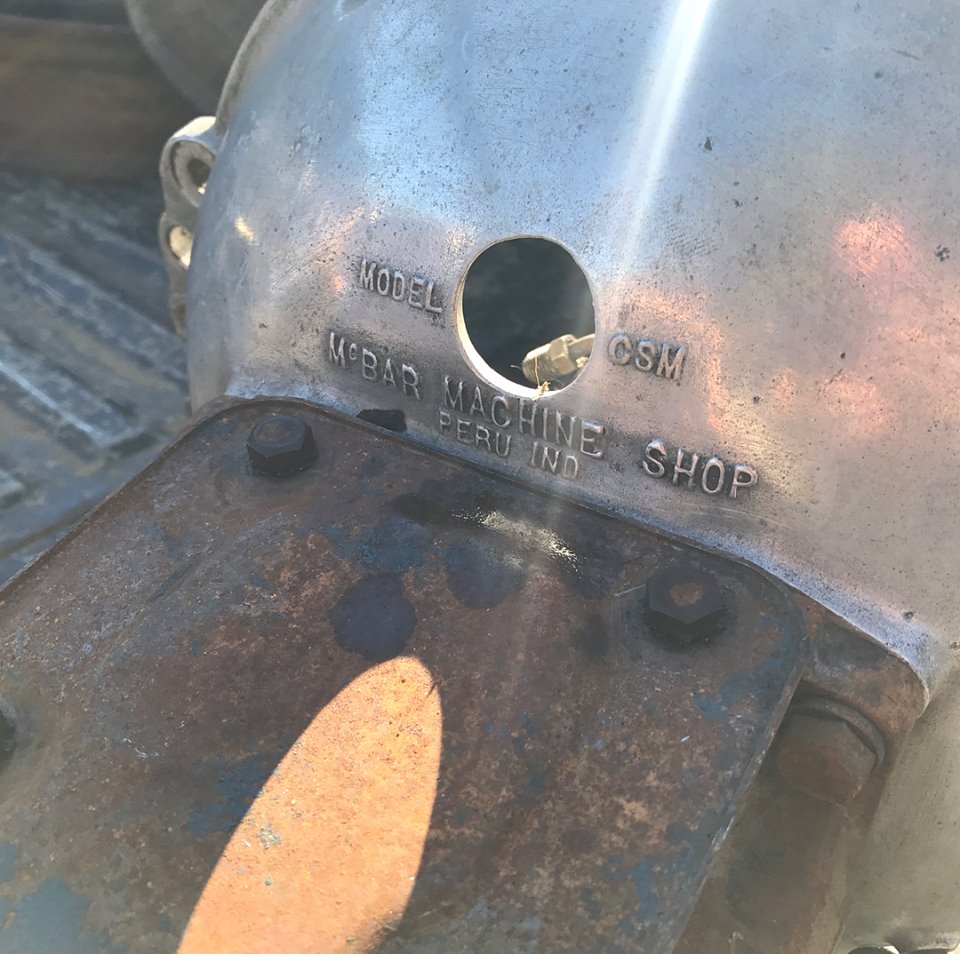

    Thanks again for the help! Thatll be easier than the stupid pins. lol
    It does in fact have a roller cam.

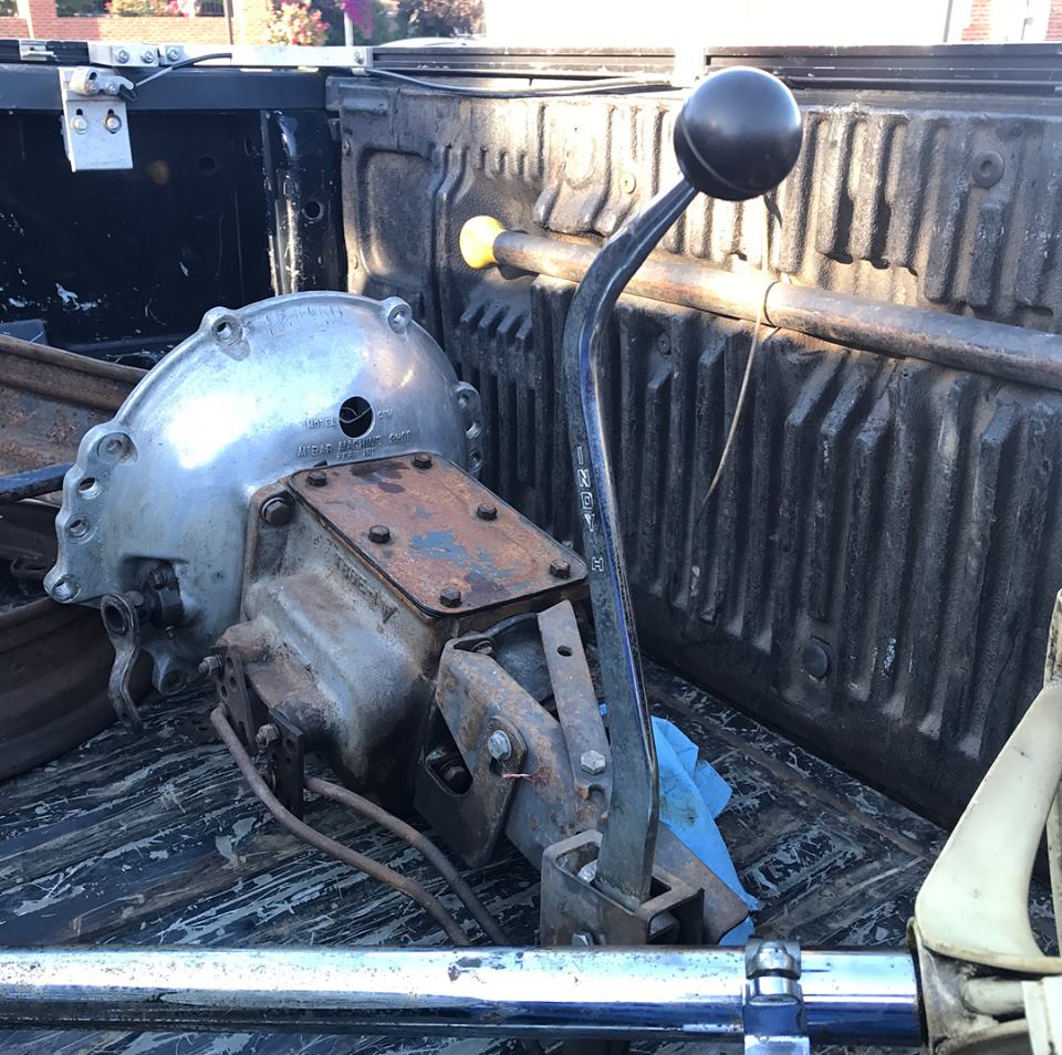

    Looks like ill be buying another tool. lol

    On the Stude 3 spd you can adapt a Stude pu shifter by removing the top inspection cover, bending the shift forks slightly, and bolting it to the top. This centers the shifter and moves it forward.
    My brother Tom (Gennie Shifter) did this in his 53 Comander with a 57 Golden Hawk 289 back in 1960.

    If you can't find a Stude pickup floor shifter a Jeep T96 floor shifter will work with the same m***age. Is that ****** a BW T86? Im putting one with OD & a Jeep shifter in my roadster. BW Overdrives are fun to drive.
