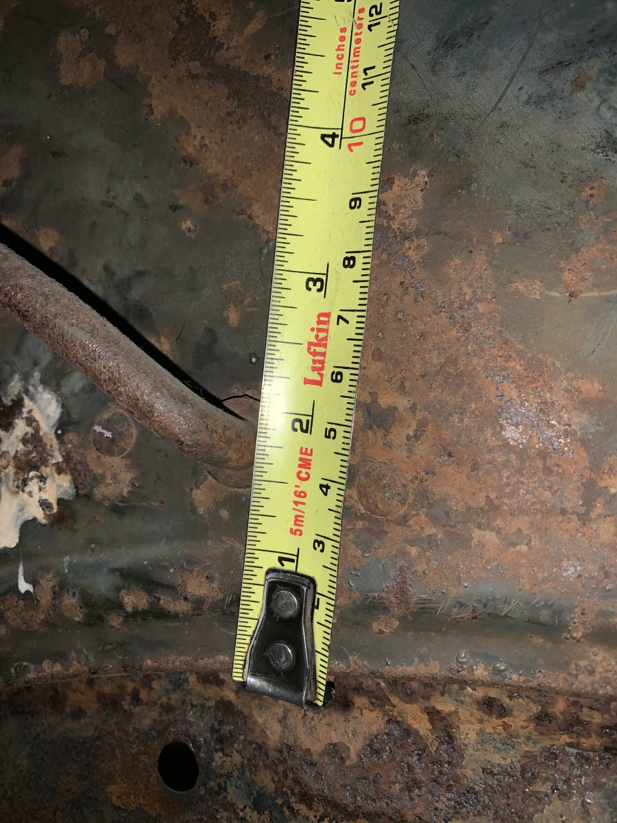

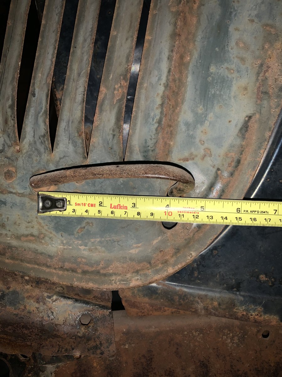

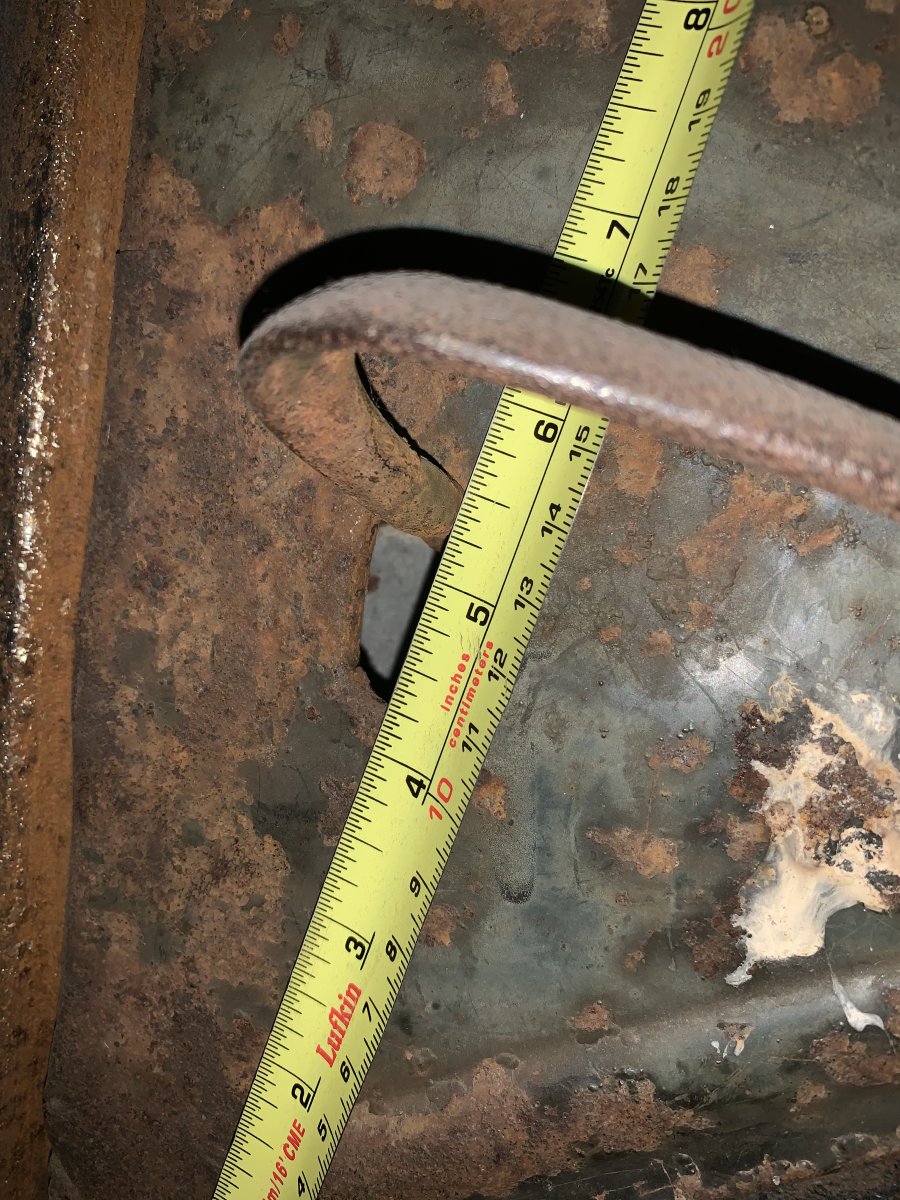

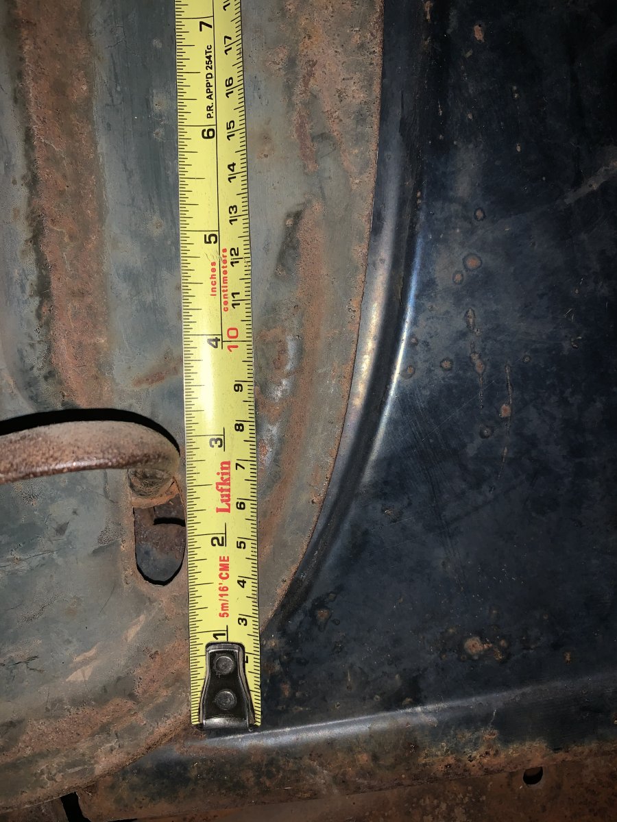

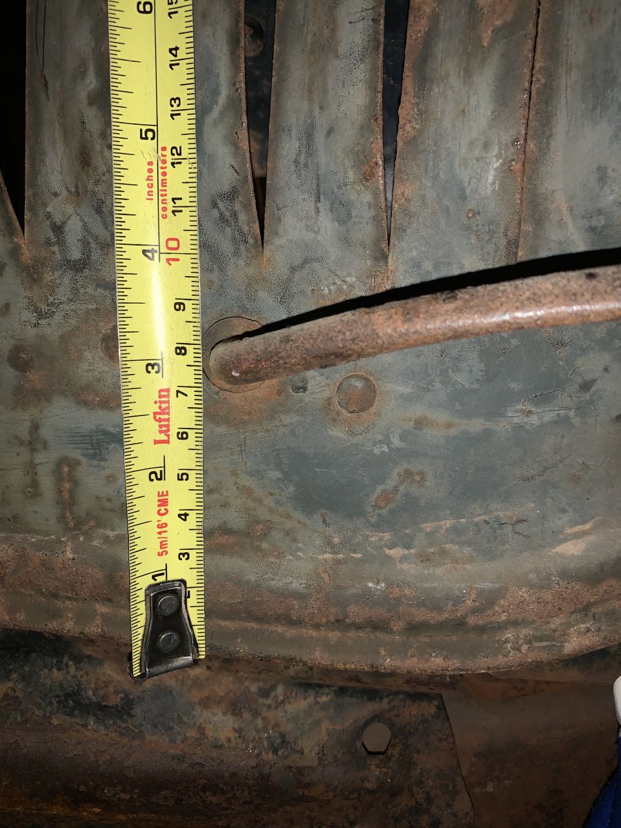

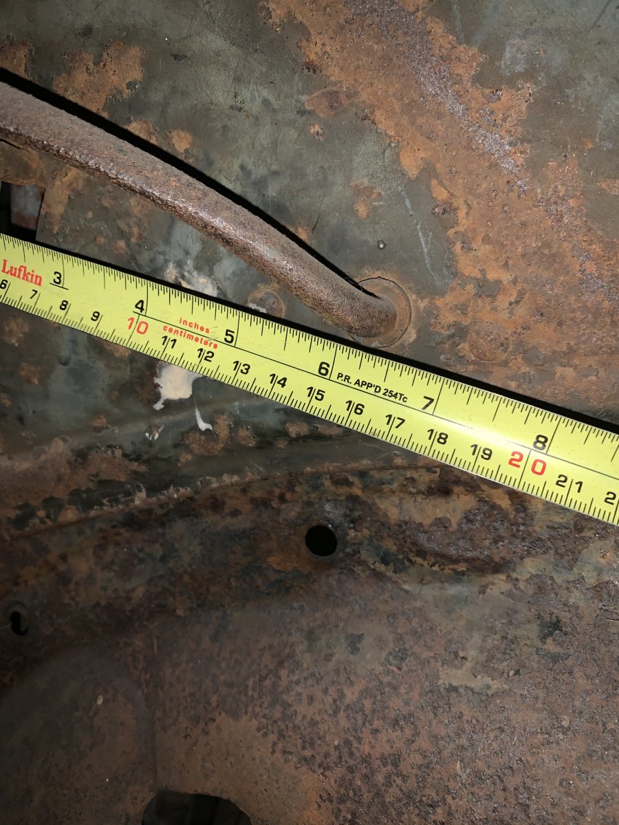

    Hi all, I need to punch holes in my hood for the latches. Looking for measurement of front and back to locate the holes properly. Thanks in advance!

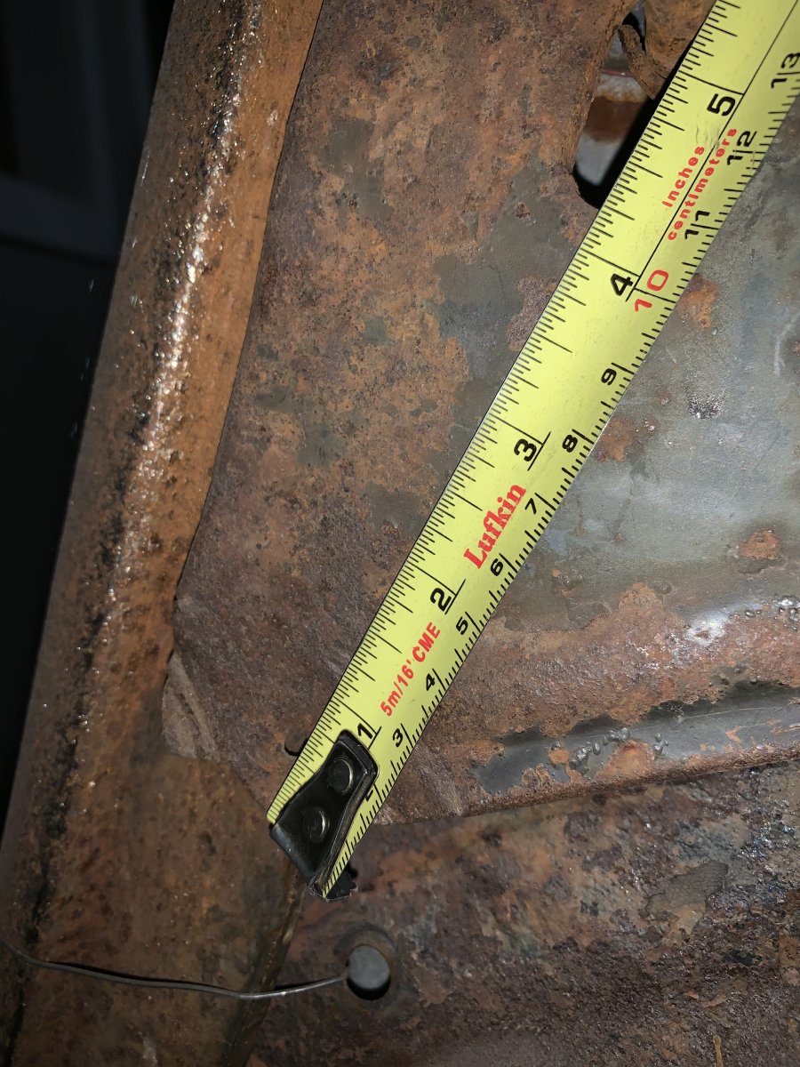

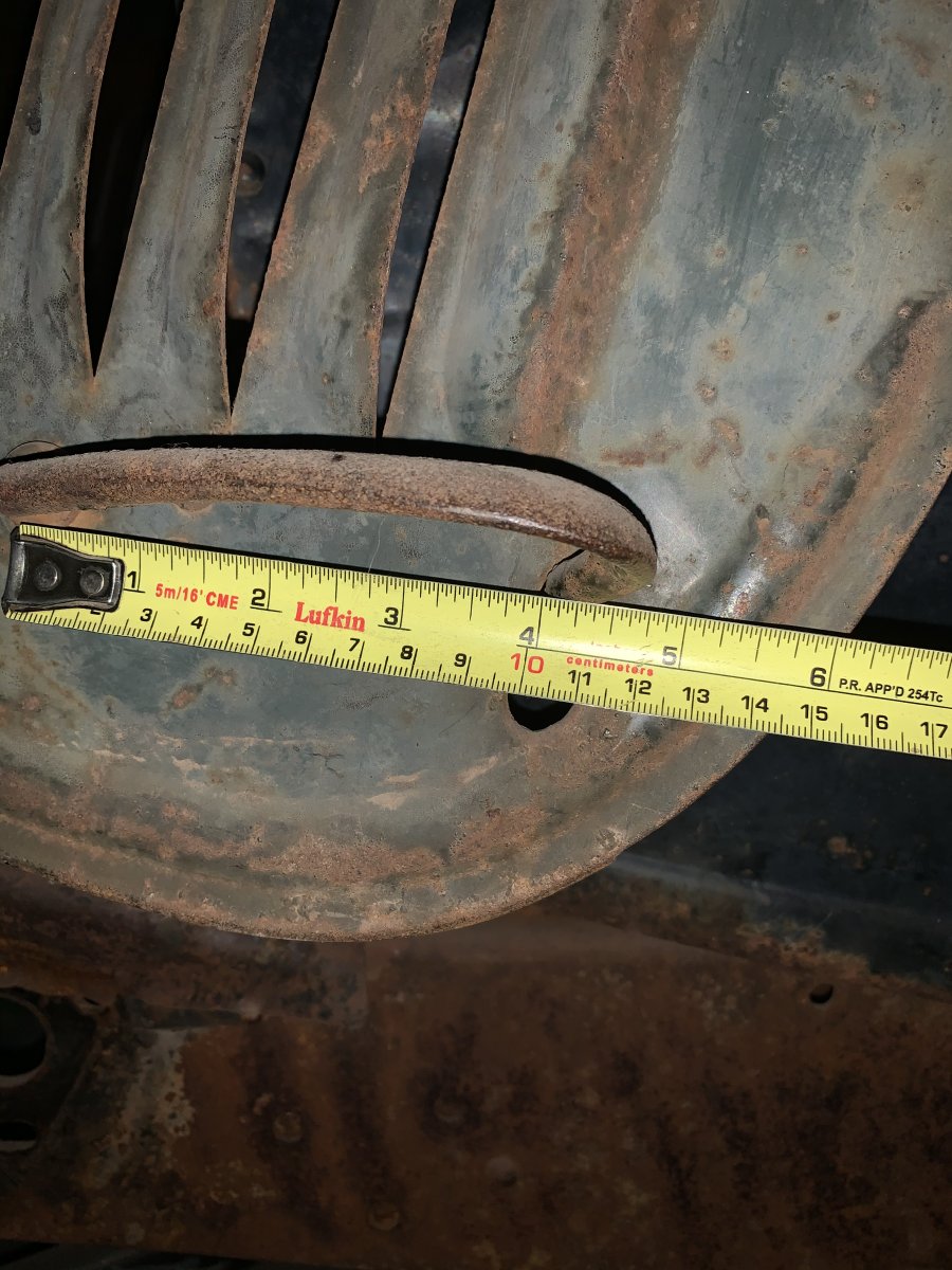

  3. Duke
    Joined: Mar 21, 2001
    Posts: 927
    Duke
    C8B4B3A7-1646-4481-AFC0-CB0333EB9DDF.jpeg 72D2F713-2992-41AC-8EB7-702B5D3F596A.jpeg 38F0C901-9558-4D4E-B1C0-1C127C1A48AB.jpeg 3EB1B0A0-01F8-4A80-BE87-E3DD69EBA81D.jpeg C8B4B3A7-1646-4481-AFC0-CB0333EB9DDF.jpeg 72D2F713-2992-41AC-8EB7-702B5D3F596A.jpeg Back handle

  5. rusty valley
    Joined: Oct 25, 2014
    Posts: 4,299
    rusty valley
    Duke, nice effort there. its gonna be a hard thing to do without a hood on sight to look at, or a cardboard template. kudos for your effort, hope the OP can get it

  7. Gnater
    Joined: Jan 7, 2020
    Posts: 50
    Gnater
    Duke you are amazing. I can use your measurements to make sure I’m in the ballpark, then a Cardboard template of my hood sides to make sure it lines up with radiator and brackets.
