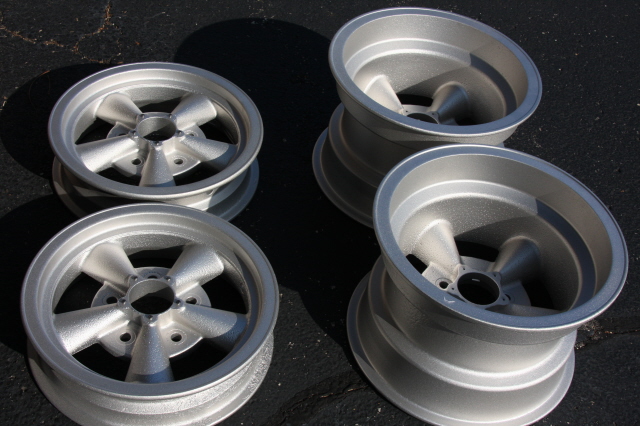

    Puddin is now sporting magnesium wheels all the way around.
    The rears are different than the restored ones in the tech post.
    They are single pattern 16x13 Halibrands and completely natural mag. Polished years ago and allowed to age.

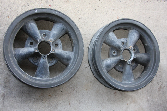

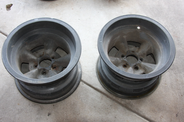

    Here's another pair of magnesium wheels that cleaned up nicely:
    Before:
    benchseat4speed likes this.

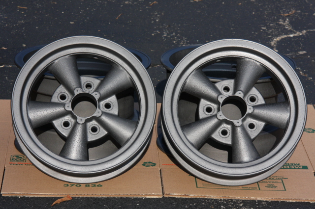

    No "during" photos, but I spent about an hour with a brush and the etching mag cleaner, followed by a coat of Gibbs. I also removed the junk tires.
    After:
    -Brent- and benchseat4speed like this.

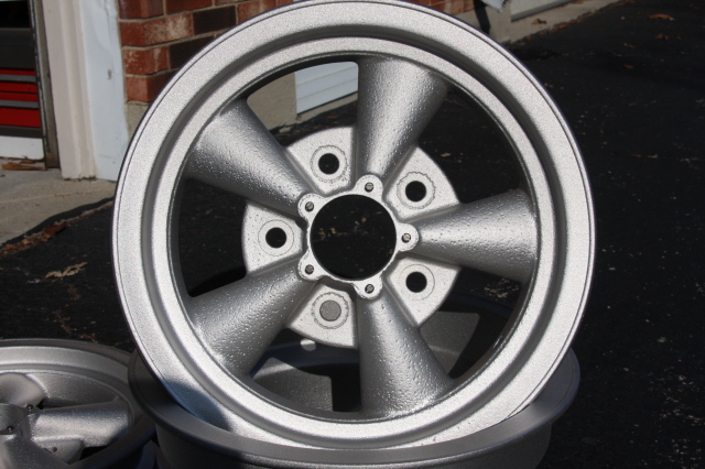

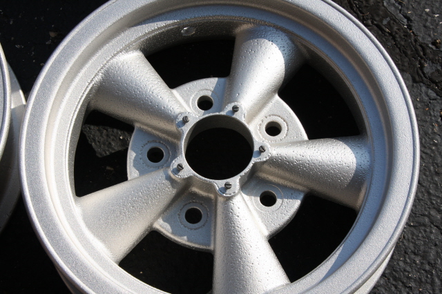

    I just got a set of mags back from shot peening and they cleaned up nice (although the pitting is really noticable now) but they look like they were painted silver instead of coming out the dark gray color?

    Here are some pics of the wheels before and after shot peening. As you can tell from the pics the pitting is really noticible after the shot peening. I`ve been told the pitting is way to bad to polish out so I was thinking about having the wheels chrome plated instead. Good or bad idea?
  25. ShakeyPuddin55
    Joined: Dec 22, 2004
    Posts: 1,906
    ShakeyPuddin55
    Rainman,
    I would just etch them now. No way you could polish those.
    When they're darkened up, the pits should not be as noticable.

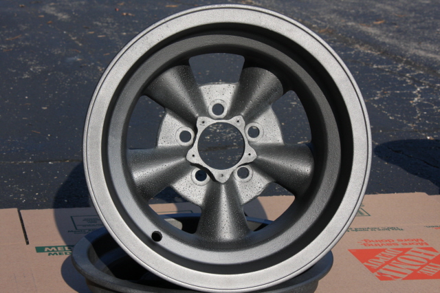

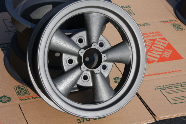

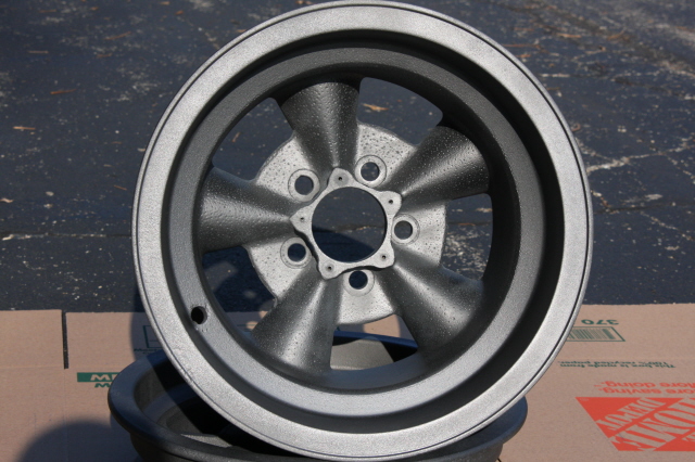

    Finally got my wheels finished and thought I`d post some pics. The wheels were shot peened then sprayed with Eagle One Mag Etching and then sprayed with NAPA Dry Graphite Film Lubricant to give them that dark look.

    Here`s the pics....
