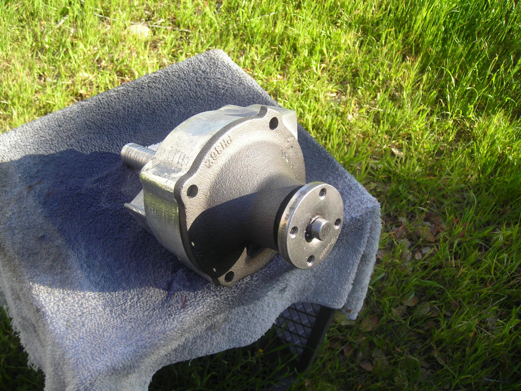

  14. I used my Gingery charcoal furnace, some s**** and some crummy home brewed green sand to make this water pump for my motorsickle. It uses a Chrysler pump. I cast the pulley, as well.
    The Dave Gingery series of books are great, even if you don't build any of it. He had a "can do" at***ude. You don't have to be rich or a genius to build some really nice stuff. You just have to be able to think logically and visualize what the finished product will look like

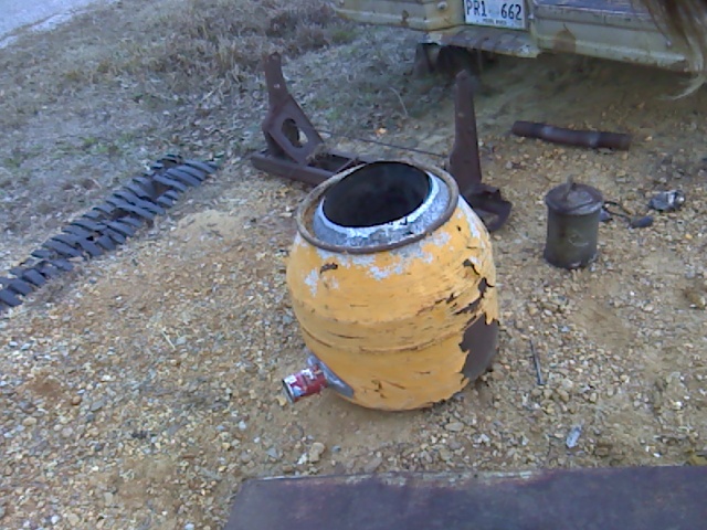

    from ms
    mine I made with a cement mixer, packed pipe clay as the insulation and a piece of chimney pipe as the in-liner, and a model A torque tube as the in pipe... weighs about 250lbs , making the lid out of a old 70's Buick brake drum .. and since I’m as broke as dirt I’m using homemade charcoal as the fuel and a 12v blower from my 89 f-150 to get air into it .. melts solid aluminum 1in di. bar stock in about 8 minutes if it’s just laid on top
  27. stainlesssteelrat
    Joined: Nov 23, 2010
    Posts: 583
    stainlesssteelrat
    from ms
    used the tape to keep the pipe from moving when i packed the clay.
