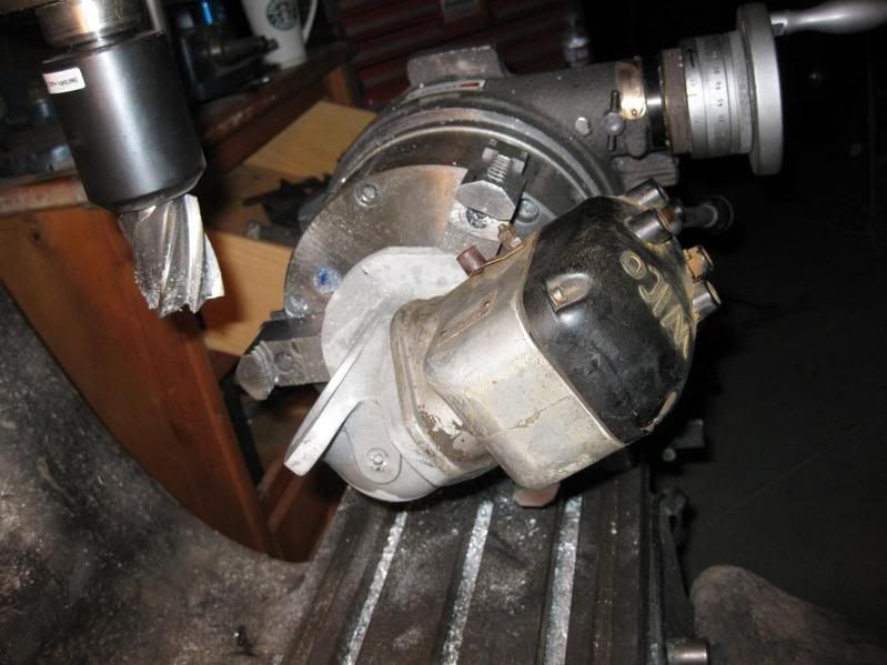

    Well I waiting for my refractory to cure. I'll pour it Monday night and post the results so you can check it out.
    It's a mag drive. Here are some more pics that will make some sense out of it:
