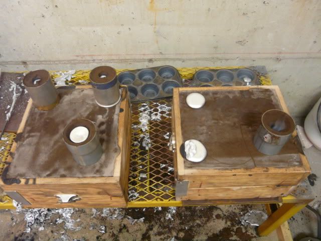

    This is what I made for a new pouring table works great. Kris have you used L****n foundry supply? I just purchased some petrobond there seems to work good I had to mull the hell out of it though.

    ...and what is the part? Looks kinda motorcycle case cover-ish.

    The sand im using now is from L****ns its a petrobond oil base mix, I love it over water base. L****ns are on about 850 W 2600 S, Just go 9th west and turn east on 2600 they are on the left north side of the street. I have bought the pre mix from them Kim Archer at State Br*** actually makes it for them, I buy it pre mixed now but im working on a larger muller so I can save some money and mix it myself. It really needs a good mulling and or some heat but you can cast a finger print from it.. That Taco cover is a clutch guard for 60's Taco mini bikes. My main market is vintage mini bikes at this time, and a few car parts but more in the mid late 60's stuff.

    I noticed my new pour bench is looking quite worked from when I posted a pic of it in Jan.
