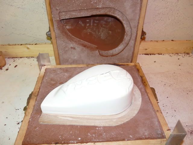

    I bought a small foundry from lost and foundry, I have built a mold but had trouble pulling it cleanly and redesigned it. I havent tried it again but wonder if I may have better luck pulling a clean mold with the petrobond vs the green sand I have been using.

    The mold or Pattern you have is actually the most important part of what you are doing over sand, you need to make sure your pattern has good draft for a clean mold

    I have had 300 lbs of Petrobond since 2006. I haven't had to add oil yet. It still works great. If you are going to get serious, an oil bonded sand is a must.

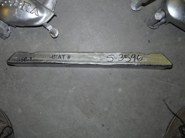

    If you want post a pic of the pattern your trying to make I can tell you if I see any issues, also you will not have problems with welding with oil base sand. One thing I found is alot of people try and melt s**** stay away from it, I had a hell of a problem at first and I was melting used material, I found I can get certified 356 casting alloy here for 1.37-1.75 a lb depending what the current rate is at, what a difference in product and time using the correct material casting alloy has silicon in it to help with flow alot of my parts are thin and without it makes just a bunch of incomplete pours..

    I hope I did not offend you when I said I do not like melting with s****.. If I did im sorry, It was not directed to you or what you do.. your work is verry nice. I should have explained it better I make alot of parts that are only .050 thick and the lack of silicon from burnout and remelt will not allow it to flow. I found I can get 1.00 a lb for my s**** and I purchased 200lbs last week from l****ns for 1.38 a lb for certified 356 I just do not see for me adding deg***ing agents and silicon metal to the melt to get flow with having to remelt it, now not for all but me its cheaper to just use new material currently im making 150 parts a month and I do not have the time to recycle I should have said that. I do throw my cut off back in the melt but I do not use various mixes of s**** in a melt you could have 6061 with 5050 and 356 all melted togeather and so on.. this is what I choose to use most of the time
