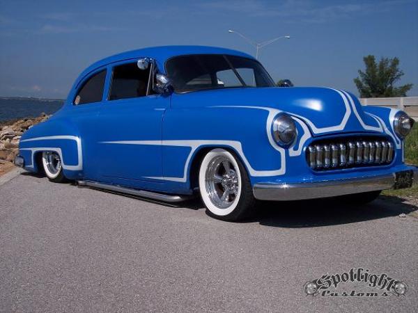

    I was looking around for a grill for my Chrysler I have been working on and the grilles that I liked were either in good condition and way too much money or the ones I could afford were in such poor condition that after repair and re-chroming, they cost more than the good one.....Sound familiar??
    I started looking around for pictures on Google Images and came across this photo:
    It is an early VW bug euro style bumper over rider. I thought it looked kind of cool. I remembered back in my teen years when I had a few bugs and thought that this might work. Went in to Mooreparts (a local VW parts place here in socal) and the guy behind the counter was more than helpfull in measuring the bumpers and over rider for me. He is a HAMB member himself.

    There's another hamber with a 52-54 Ford that uses a VW bumper guard grille, except without the bumper. I'd like to see what this looks like flipped over also.
    I could see this with a Caddy bullet or a parking light in a housing on either end like a '53 Chevy.
