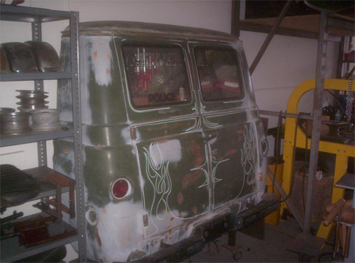

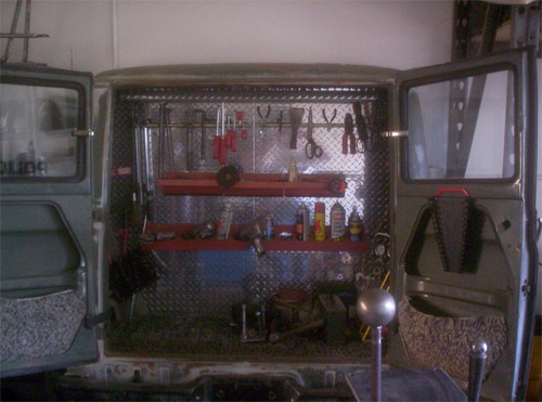

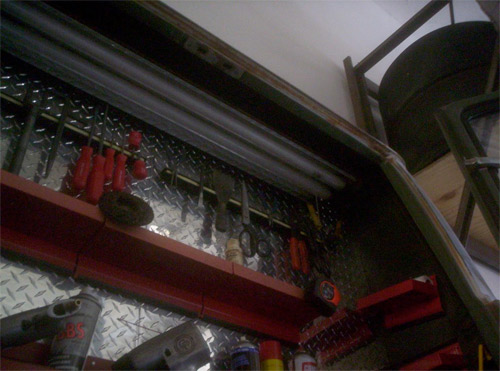

    That just gave me a great idea. I am in need of a larger blast cabinet! I thought thats what it was at first. Looks like a tool box got any other picks?

    29bowtie
    When I saw that in the back ground I thought it was your sand blast cabinet.It looks great in the shop.

    What a great idea. I need a bigger blast cabinet too. Just got done doing my intake and valve covers in a tiny cabinet, what a pain. Never thought of using it for that. I was trying to sell it but the blast cabinet is a much better idea.
    One pair of gloves in each door.
    And a new tool is born!:D

    i've been impressed with everything i've seen you do and i'm even more so with your low buck metal shaping tools. way to go. you've got at least a half a dozen tech articles all rolled into one. i'm savin this thread for sure!
    i too thought the back of that van was some kind of giant blast cabinet. LOL untill i enlarged the pics. great idea either way... if i only had the space. :)
