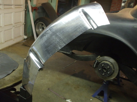

    One of my favorite tools for tipping a flange isn't a homemade tool - it's a crescent wrench! The 1/2" tools works well around flanges too. I made mine well before Ron Covell printed in his Professor Hammer column..........and I stole the idea from someone else!
    How tight of a curve can you do with a crescent wrench? Well, I did these for a friends Chevy truck:
    The curve around the back of the cab is the tightest radius I've had to tip a flange on.
    These were made by cutting the shape based on a template made from a set of original aprons. The originals looked very nice and were super straight............they were also VERY thin. The flexible shape pattern showed me where to put the flanges and the exact shape I needed to cut out. Ran them through the e-wheel with a go kart slick for an upper wheel to put the roll in it. Once that was right, the long straight flanges were done on a bead roller and the curved flanges were tipped with an 8" Crescent wrench. finished off the curved flanges with a hammer and dolly.

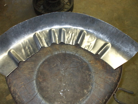

    Found another one. Tucking forks are great for shrinking. Some people do all of their shrinking by making the tucks and hammering them down. On compound curve stuff I use a stump like Johnny shows - if I don't use the thumbnail dies in the little yellow machine I posted before.
    For small areas and for some flanges, I still use the forks.
    I have a shrinker, but sometimes i just don't wanna ****** up the edges of the panel with the jaws.
    A couple of cheap pry bars were cut down and the tips were rounded and smoothed. I put a piece of 16ga in between the bars and welded them together. Welded a handle to the result and came up with what's in the pics. The set on the bottom has a larger gap between the tines....it was the first set I made.
    They don't get used a lot, but they are handy to have around.

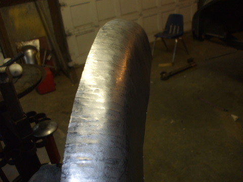

    Here is the hard part capturing your tuck so it just doesn't run out on you.
    I take a body hammer and beat in the end of the tuck.Moving from moving from side to side working my way back wards.It's hard to explain but the video will show you.
    After I get the tuck trapped I just wash it out toward the back with my shaping hammer.
    Just keep adding tucks until you get your desired shape.Where to place your tucks is a whole another story.
    There are two things I don't like about tuck shrinking it Gaul's the metal up and it takes me longer to clean up and I don't get as much shrink out tuck shrinking as I do with stump shrinking but I'm pretty sure that is because I am not very good at it.
    Investigate it for yourself and find what works the best for you.

    I use a combination method.
    I was taught to tuck shrink by making the tuck then hammering it out on a flat surface, working from the point of the tuck out to the open edge. A plastic hammer with wedge shaped faces and a hard plastic or wood surface work best.
    It works pretty well.
    Then, I got John Kelly's DVD "Tuck Shrinking". John teaches using a steel hammer and working from the open end of the tuck in toward the point. It's best to work over a steel surface that has a radius - a half-football post dooly works very well here.
    If I'm tucking a large area, like the fender(?) in your pics, I tend to make the tucks and then start working from the outside in - just like John teaches. Once I am making some progress on getting the edge shrunk, I'll flip it over and switch hammers. The wedge shaped plastic hammer, working from in to out, makes quick work of crushing the tuck.
    For flanges, I use John's method. Flanges usually require small tucks and it goes fairly quick.
    If I'm working in my garage and have to make big shrinks..........well, I use my thumbnail dies. Learning to shrink manually first, just makes the thumbnails that much nicer and easier to use...IMHO.
    The reason you can get a more effective shrink out of the stump is because the stump helps "trap" the rest of the metal. In the stump, it won't spread back out as readily as working on a flat surface. The only galling issues I have are from the ends of the forks. Doesn't matter how smooth the ends of the forks are, I always seem to get little "bite marks" on the metal that just don't come out without sanding.
