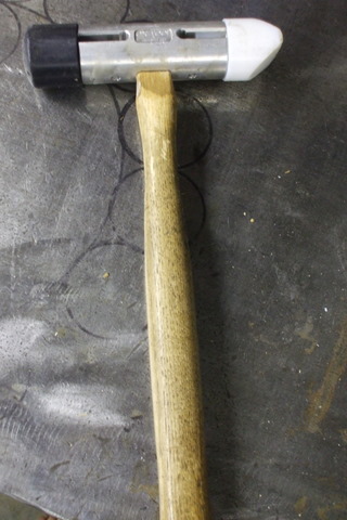

    They are filled with sand and I am not sure how thick the plastic is.If it did work you would be at a disadvantage with depth of the hammer.You will be hitting the handle before you know it.I do use a dead blow hammer for smoothing panels.
    Here is the hammer I use for shaping now and I love it.
    I walked into a harbor freight store once.I wasn't impressed at all,plus with so many American company's closing there doors due to compe***ive pricing I refuse to buy anything from stores like harbor freight.
