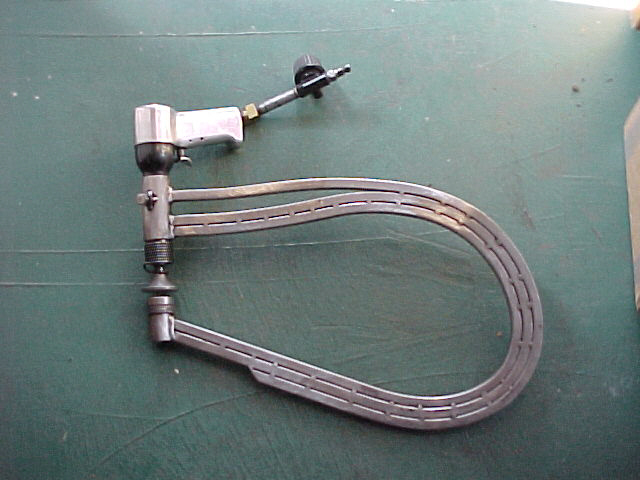

    Here are a couple of my home made tools. A stretching machine made from a palm nailer and a 5/8" solid stock frame, a portable planishing hammer, and a rectangular framed english wheel.
    John www.ghiaspecialties.com
