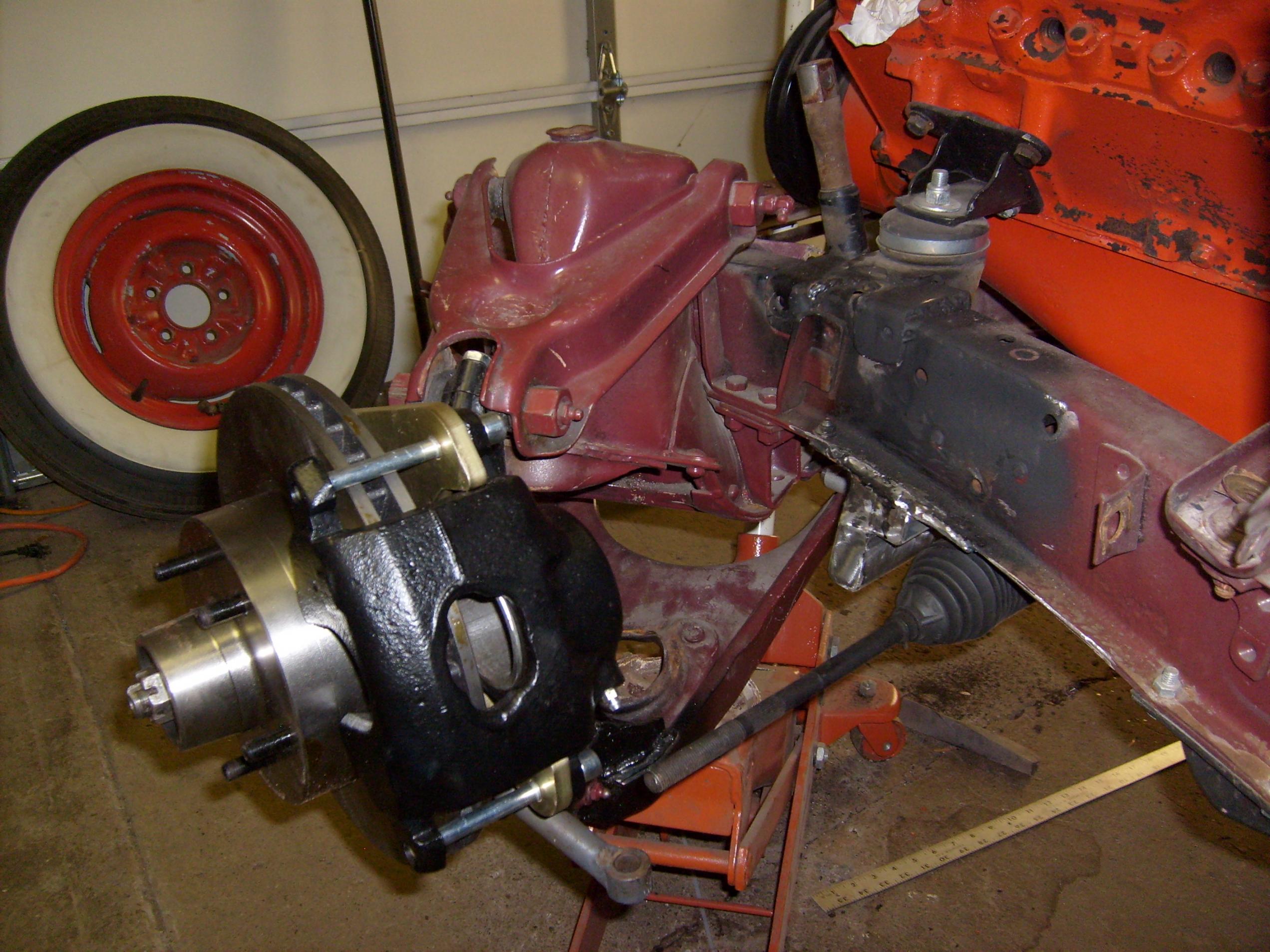

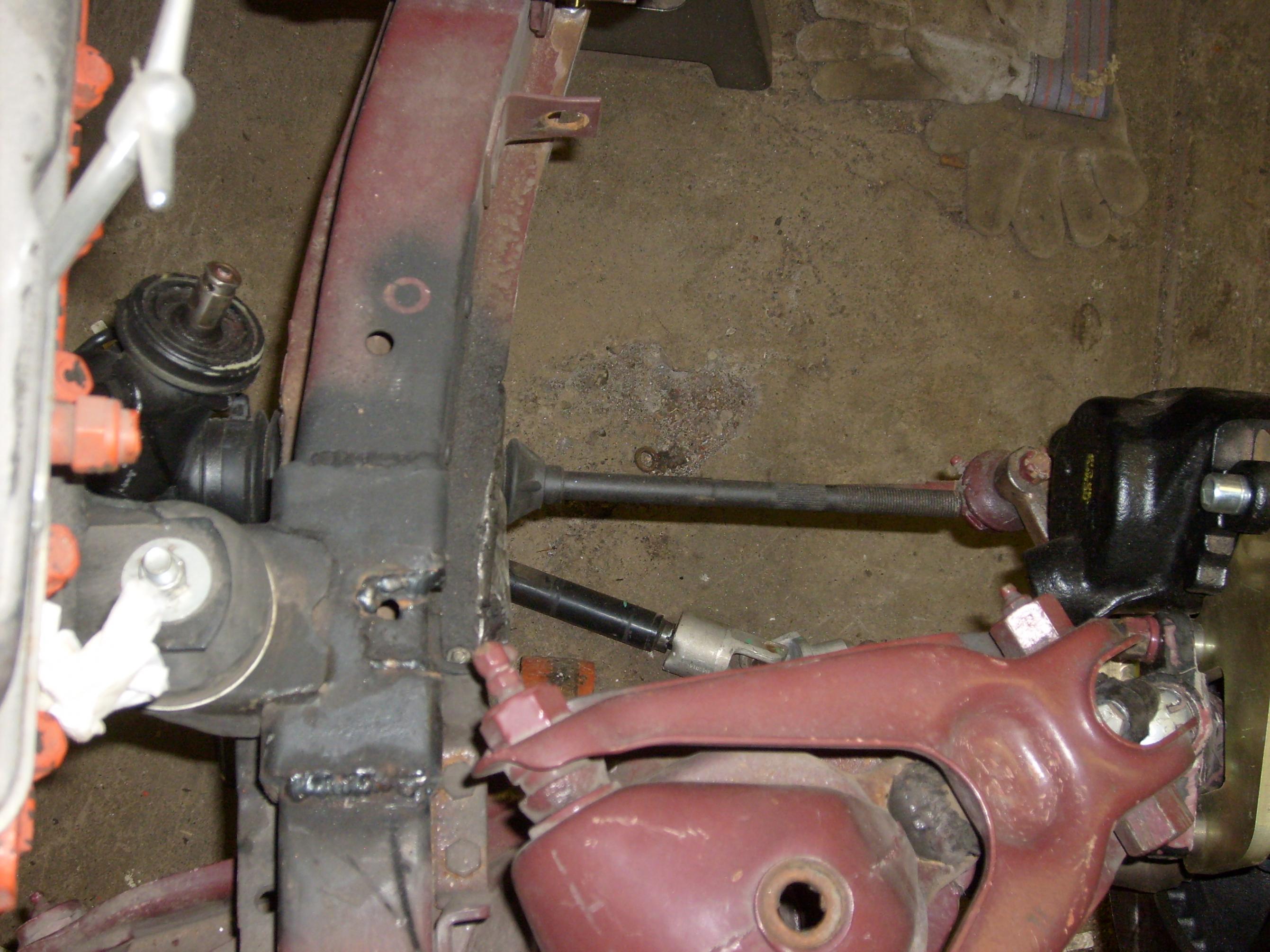

    I did it, think it should work out ok. I put a plate on the controll arm 1st before putting the link back on. I countersunk it into the arm so that the diamention stay the same. I haven't put the springs back in yet or put it on the ground but it looks like I will end up with 4 to 5"s between the controll arm and the pavement. Need to get the steering arms set up now for the rack.
  7. spiders web
    Joined: Jan 16, 2011
    Posts: 387
    spiders web
    Hey cosmic, Where did you get the disc brake set up or did you make it?
  8. cosmic12
    Joined: Oct 16, 2011
    Posts: 422
    cosmic12
    Got the bearing adptor and caliper mount from Street Rod Headquarters.
    Not real happy with it though, none of the holes lined up and the bearing adptor didn't work real good eather.Had to do alot of work to get any of it to fit. Rotors/calipers/pads from NAPA.

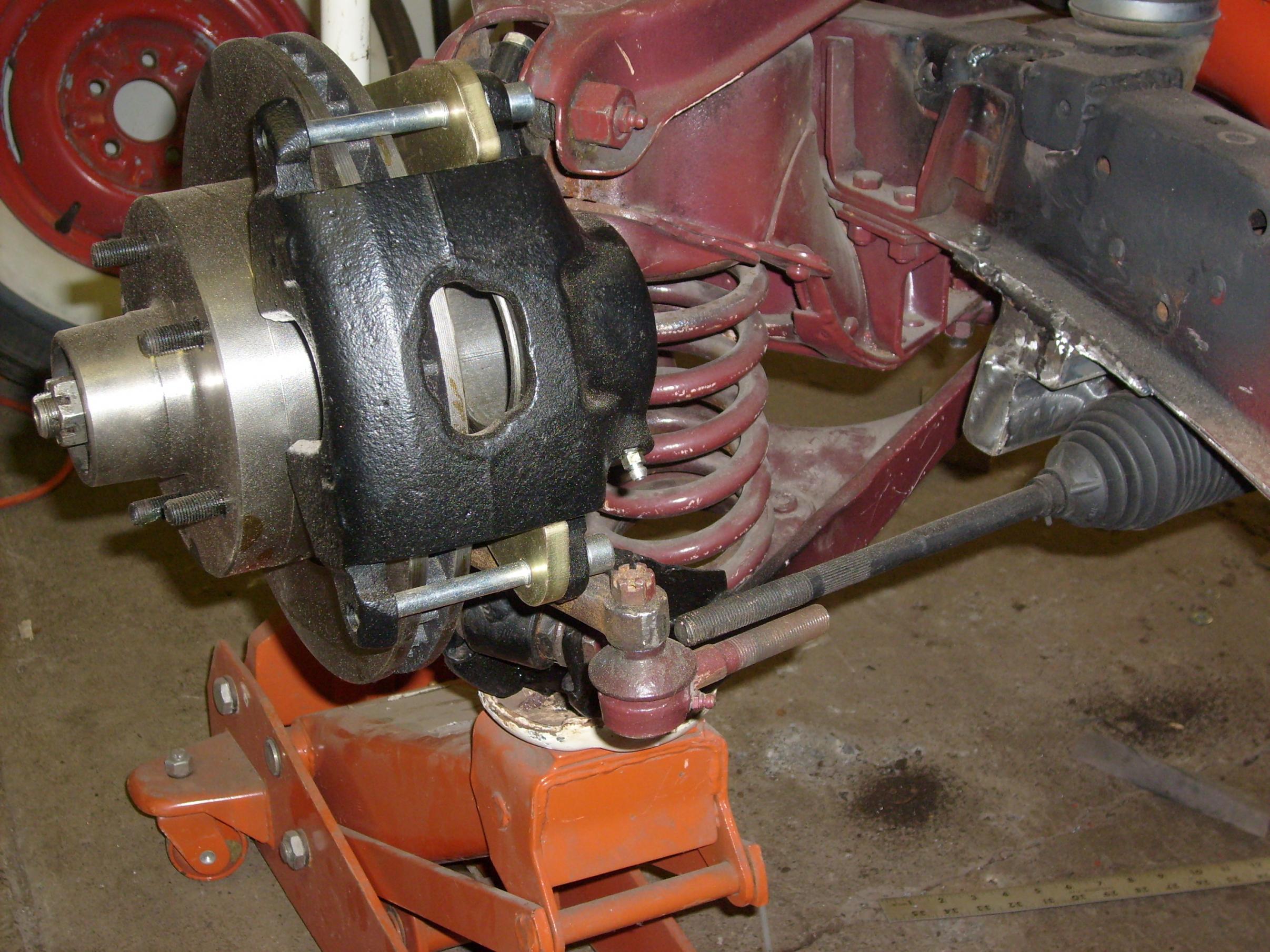

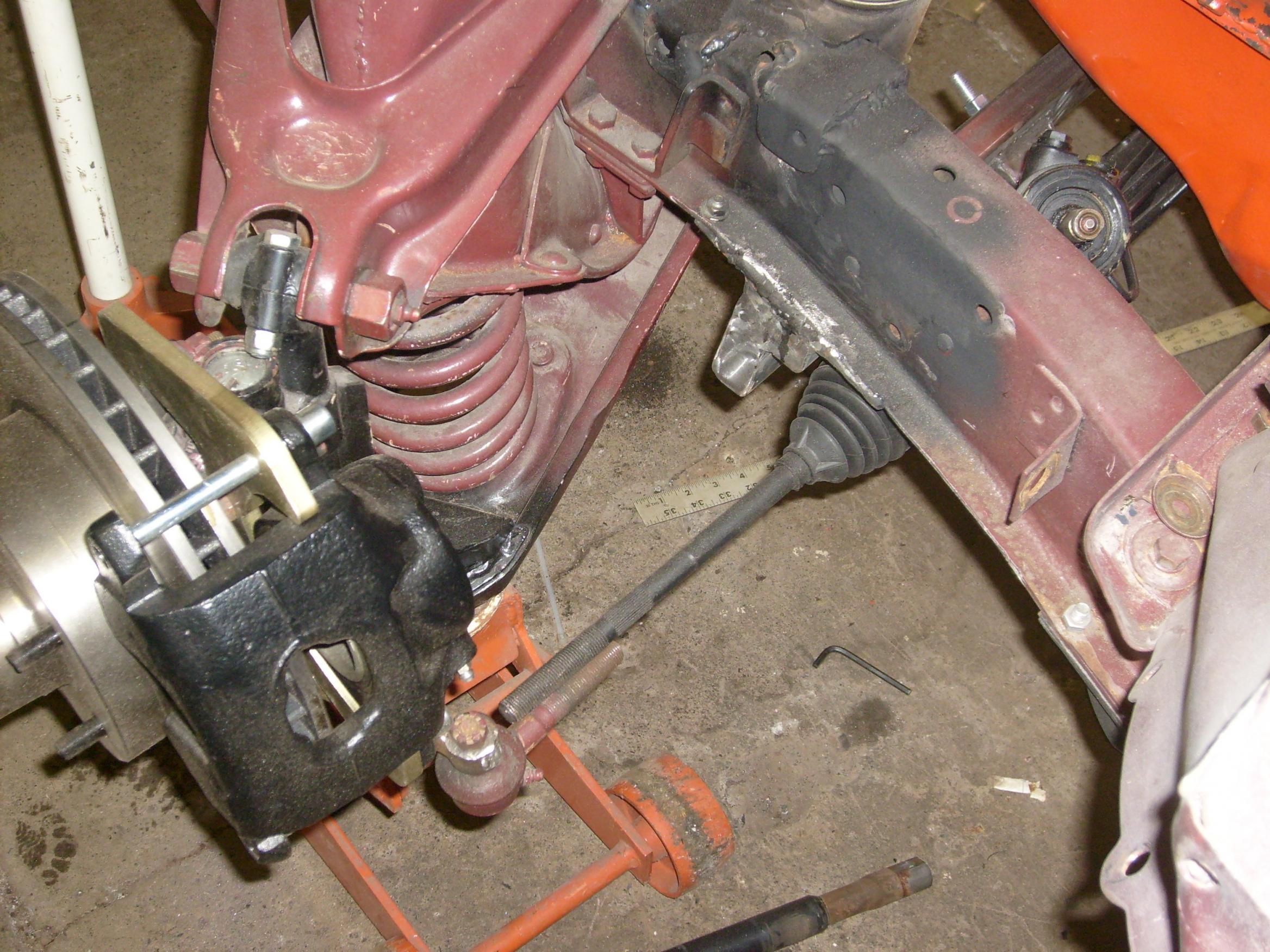

    Got the springs back in and the steering rack in. To my surprize the 2" drop steering arms didn't work but I put the stock ones back on and they are perfect. So I have a set of dropped arms for sale now.

  13. cosmic12
    Posts: 422
    cosmic12
    Forgot the pic on the last post:rolleyes:

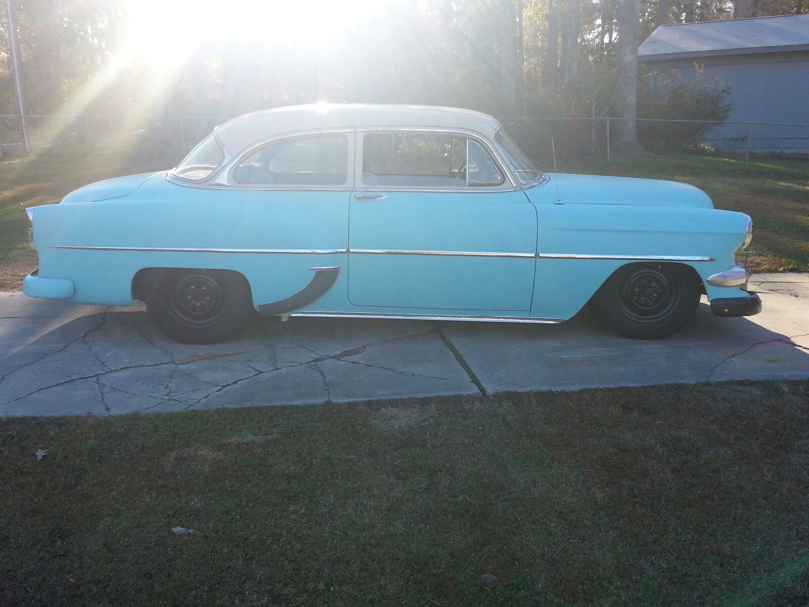

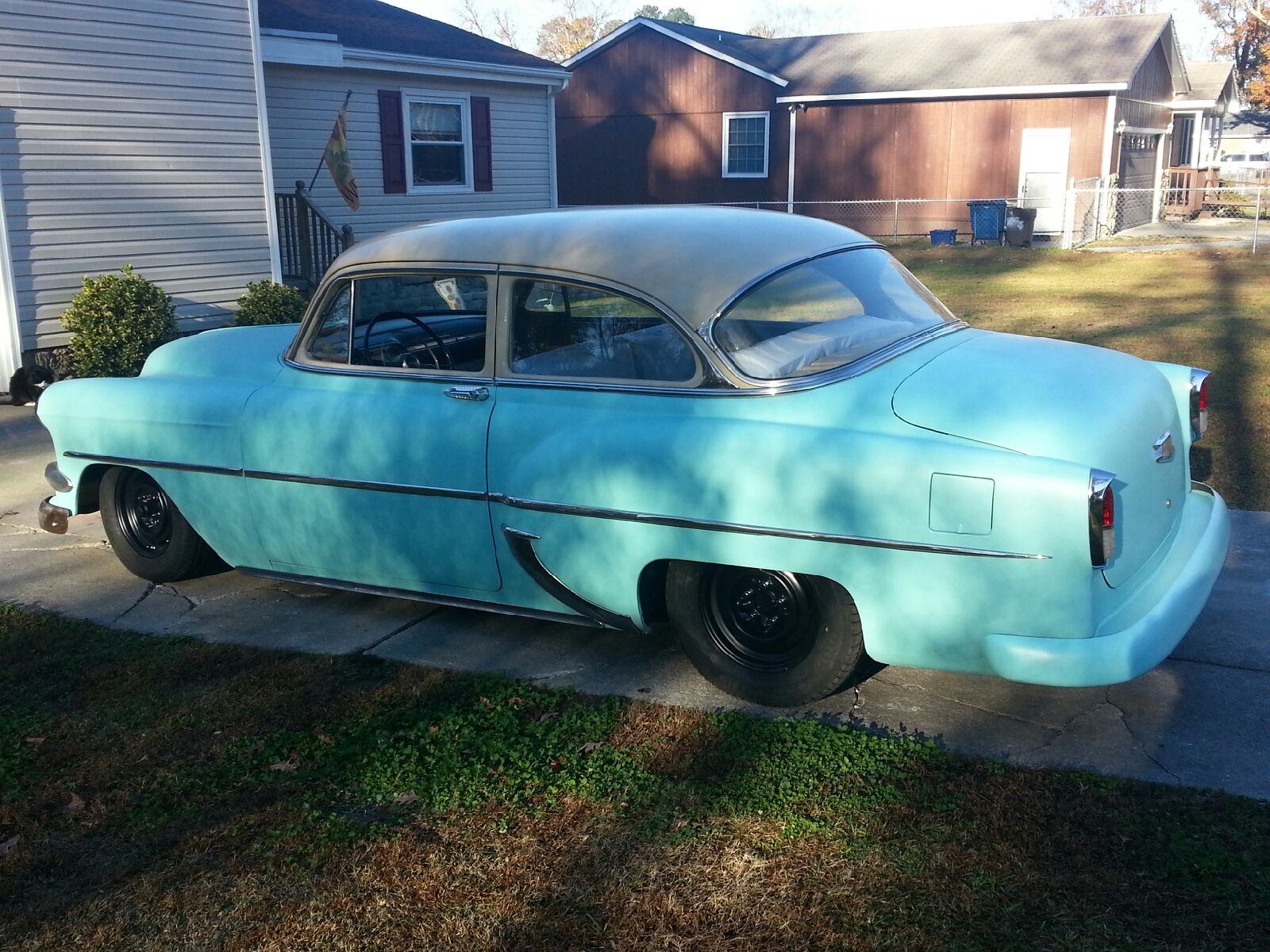

    Dropped my 54 this past couple weekends using this thread. The rear is 3" blocks, and the front is stepped lower arms, and 1 1/4 coils cut. My coils must have sagged a lot over the last 60 years. Now my front is a little to low. It's fine sitting but once a driver gets in the exhaust is on the ground. So hunting for some new coils. This time only cutting a half coil if any at all. Either way it looks *****in! LOL
    leadfootloon likes this.
  16. ahewetson
    Joined: Dec 3, 2010
    Posts: 77
    ahewetson
    Can you change the exhaust? The stance is KILLER!
  17. 51fordor
    Joined: Sep 16, 2010
    Posts: 215
    51fordor
    I wish but it's still to low. Once we pack the wife and kids with me the cross member is almost on the ground. I do love the stance!
