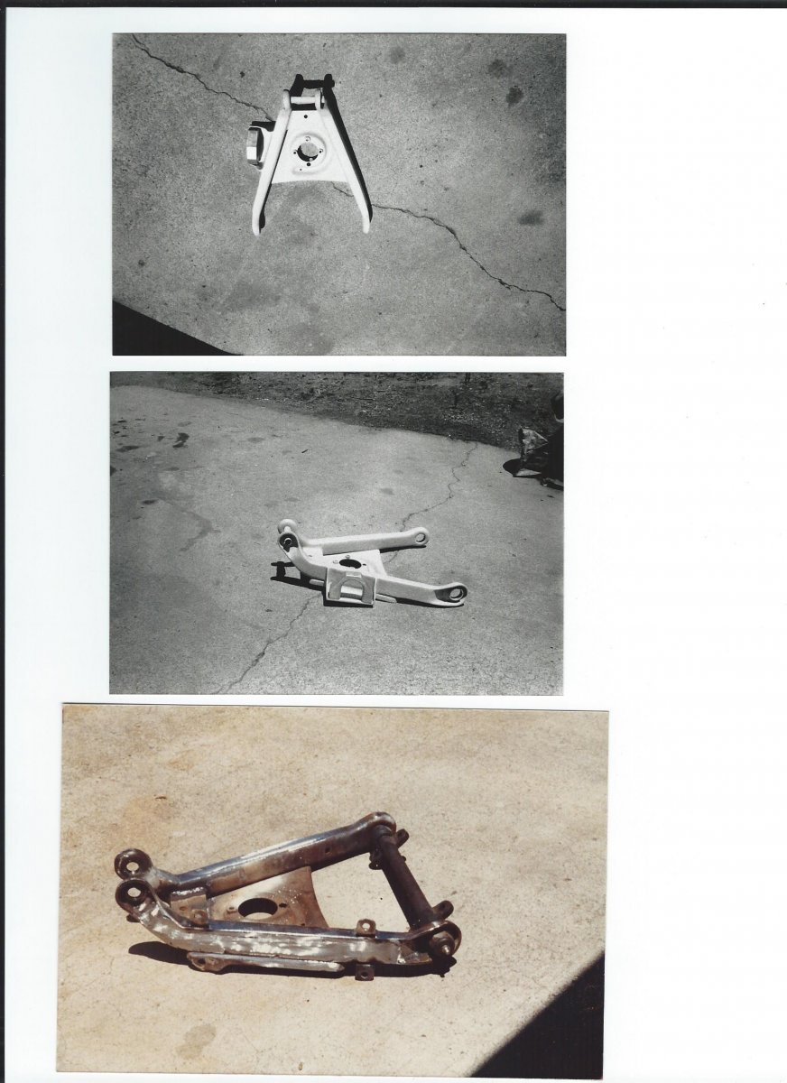

    Scan0035.jpg Scan0046.jpg Hey Guy's, these are shots of my modified 51 Ford A frames, after I made my cuts, I installed an enter piece of 1/8" flat stock to match the modified A frame and then boxed it on all sides, this is what it looked like with 2 coils cut.

    The bracket welded to the A frame if for a 1/2 Chevy pick up sway bar, the horse shoe pic carries a urethane bushing that the sway bar ends terminate in, using the sway bar took all of the Yaw out of the car when turning in a corner.

    Important info I forgot to mention, I had to add an aluminum spacer to lift the top A frame the same amount as I raised the lower A frame to keep the geometry close, when I was a kid in San Diego this was a popular mod if you wanted low, I had a 50 Chevy back then and did something very similar to those A frames to get it in the mud, I was getting to low tickets back then before there was a law, LOL, LOL

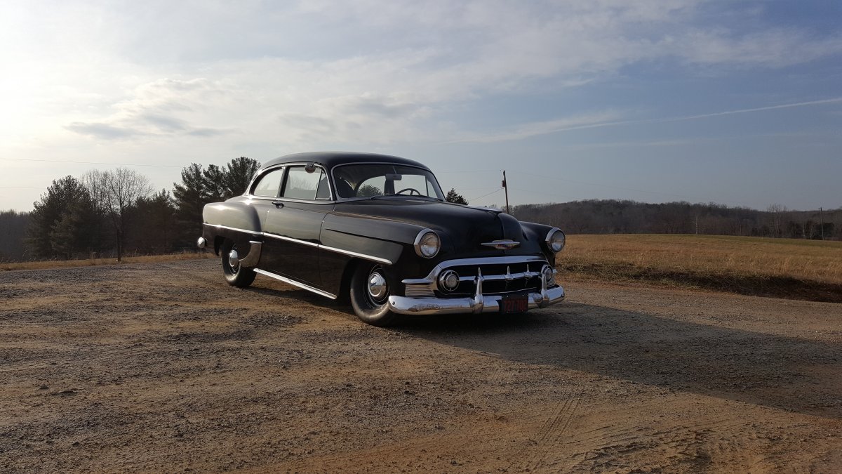

  16. Tim Payne
    Joined: Aug 5, 2015
    Posts: 23
    Tim Payne
    Updated pic after installing New stock sprinGS with 1/2 coil cut, stepped lowers and 3" rear blocks. Very happy with the stance but I have to correct a serious camber problem. Wheels still lean on at the top severely.
    niceguyede likes this.
  17. Lone Star Mopar
    Joined: Nov 2, 2005
    Posts: 4,208
    Lone Star Mopar
    They will lean until you get an alignment. It's also important to rebuild all the suspension components while your at it. Otherwise it won't align worth a **** anyways. Keep us posted

  18. Tim Payne
    Joined: Aug 5, 2015
    Posts: 23
    Tim Payne
    Update...aligned really well, drives great. Now I'm ready to cut another 1/2 coil. Never satisfied

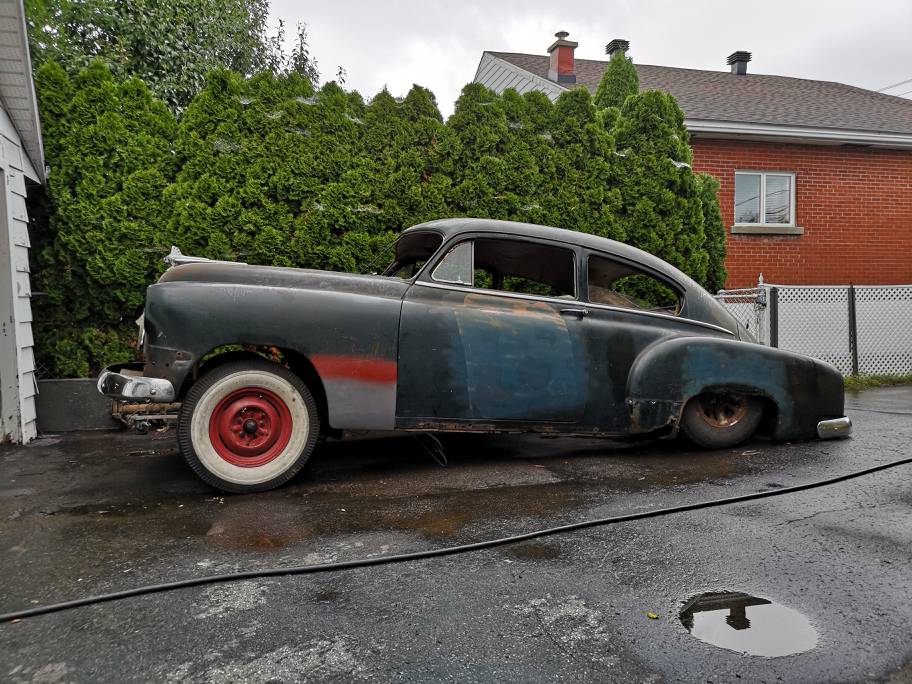

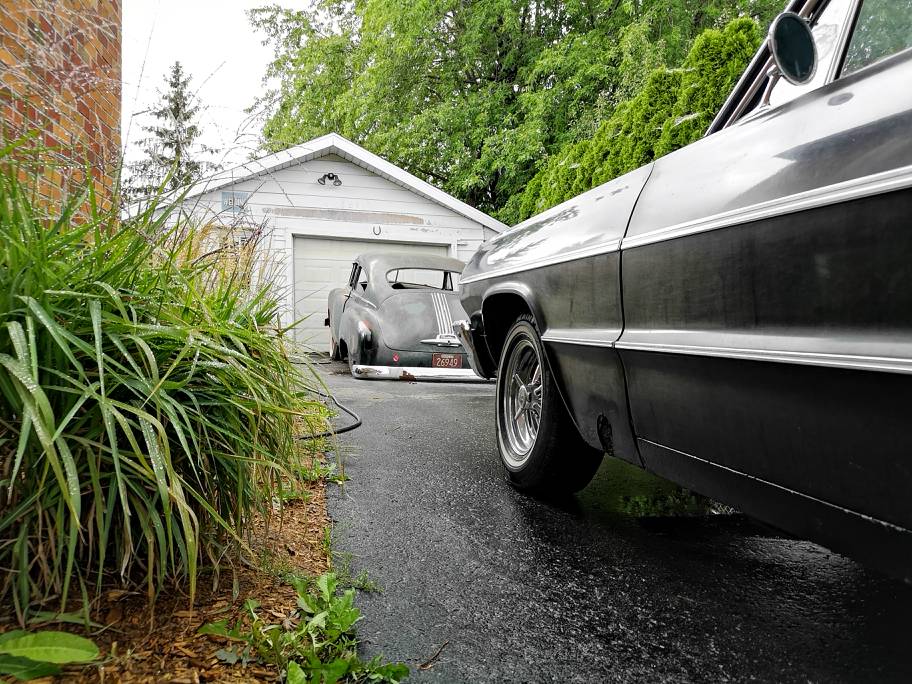

  28. sweetchaos
    Joined: Nov 29, 2010
    Posts: 4
    sweetchaos
    from montreal
    Thanks for this tread! Thats how i will build the front of my 51!!! [emoji1] IMG_20180911_120253.jpeg IMG_20180911_122102.jpeg
