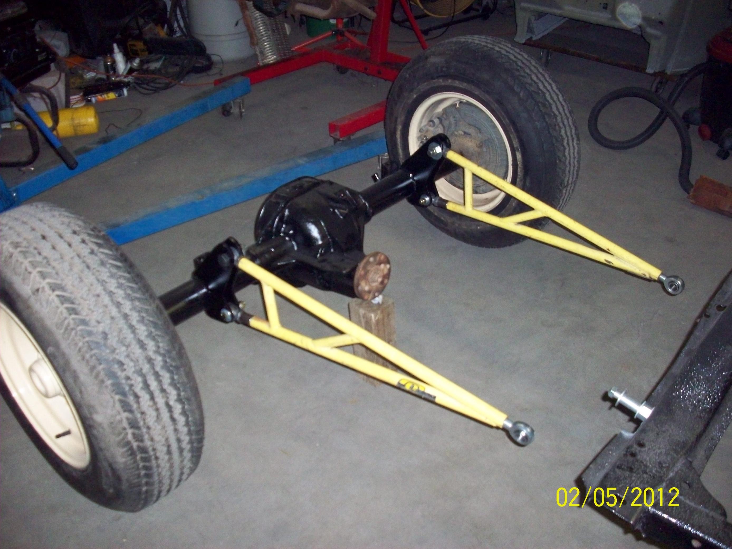

  17. Another idea that may help on mounting them inboard would be to replace the existing axle bracket that centers them on the axle with one that mounts them lower on the axle. Maybe similar to the P&J bracket in the picture.

    or this using an 8.8 under my A Coupe

    Sorry, but that is incorrect too. The closer to the center of the axle/chassis the control arms are mounted, as pictured, the less the forces are for a given amount of chassis roll, but the forces are still there and unwanted and will either resist suspension movement and/or want to break something. You can deny it, doubt the accuracy of these statements, but it is just a fact of physics/geometry that wishing won't make go away.
    If you put the forward ends very close together you further minimize the forces at the axle end, but the control arms need to be able to 'twist' along their length to actually make a difference in the outcome. For that reason, square, rectangular or round tube (single tube style) are not suitable. GM truck arms were "I" beam shaped and would twist along their length, were mounted very close together at their forward ends and, lastly, used compliant rubber bushings for more absorbtion of movement.

    I did exactly what Ray is suggesting on my track roadster that had a similar setup - the hairpins weren't even on rubber bushes where they mounted to the axle which may have taken up some of the movement in articulation. Scary thing is this car drove like this for about 12 years before I bought it.
    My new setup retains the look of the hairpin but only mounts as the upper link. Lower arms are triangulated inboard. They are pretty short but the axle moves though a 4" range of motion with no problems. Geometry could probably be better but this isn't a racecar and packaging was a consideration.

    tfeverfred: I am running the lowers triangulated instead of the uppers which seems to be more conventional. Herb Adams book and other research I did seemed to show no issues running them either way. Length of the lowers was a slight concern in terms of pinion angle change and well as anti-dive/squat etc. With the fairly limited travel and type of use intended I don't see a problem
