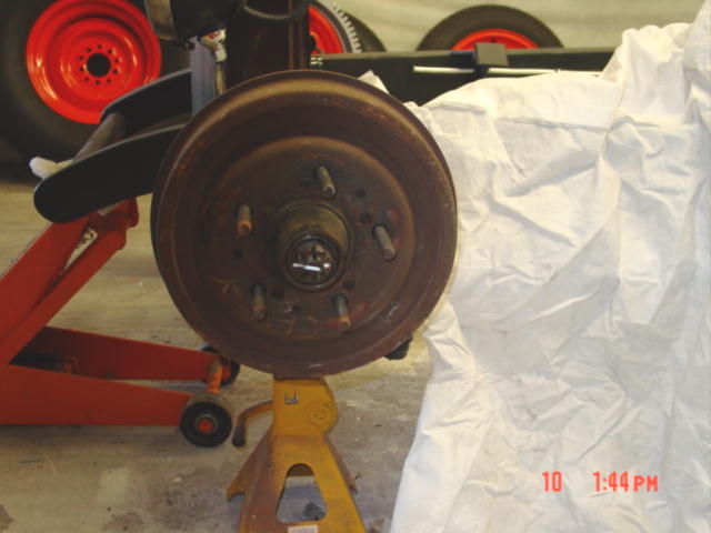

    I posted this before ---but since this is Tech Week,I' ll do it again.
    I used a set of 56 F-100 brakes on my 29 roadster. I wanted to use Buick drums but F100 brakes are 11 inch and early Ford and Buick are 12 inch. I found a set of out-of-spec Buick drums for $20.00 and used them as covers for the F-100 brakes---the F-100 brakes are completely stock and the Buick drum slip over the stock drums. I turned the lip of the Buick drum down about 1/16 to clear the backing plate.I used a 1/4 wheel spacer between the two drums to get the spacing I wanted and used Monroso longer studs. Been driving it for a month or so and everything looks and works good.

    I did the same thing on my roadster several years ago. I now have 111,000 miles on it with no problems. I think it actually helps cool the brakes. I've never had a problem with brake fade.

    Thats a neat trick, I did that to my Roadster pu a few yrs back, and f100's and Buick drums stacked works well. and like you said if you turn the edge back you can't tell they are covers. Cool post.--TV

    For '40 Ford brakes, you use the Buick drum instead of the '40 drum as they are both the same diameter.

    moonglow, this has been covered many times here. If you use 37-48 ford spindles the backing plates will work. there is a bearing adapter kit that speedway sells to use the hubs on the earlier ford spindles
