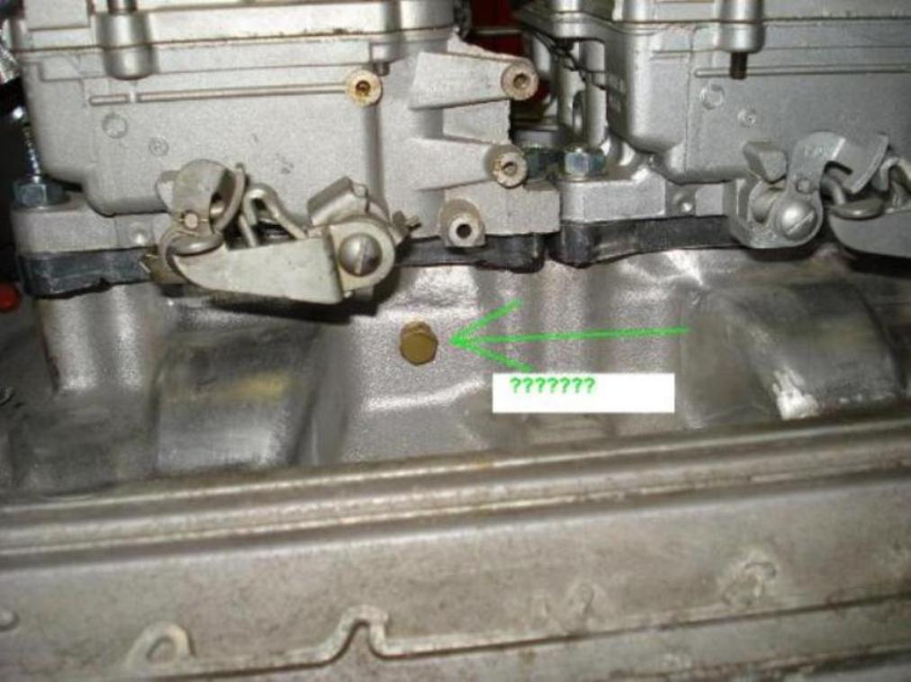

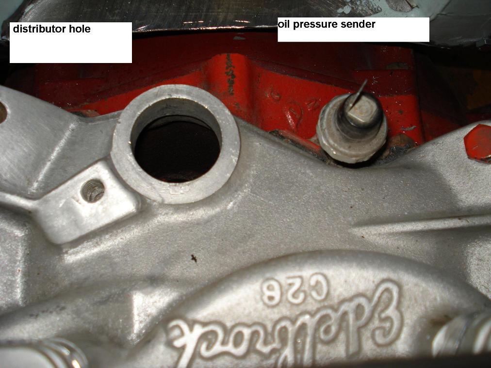

  12. I read all of the posts for this, and I saw nothing as it would relate to a 350 engine without the road draft. HELP!!!!http://www.jalopyjournal.com/forum/showthread.php?t=159551
    I have a 72 350 with the Edelbrock C-26 dual 4 set up and I am running the old no-vent 'Vette ribbed valve covers. I DO have a fill tube from a 66 vette that I am running a vented cap on and the tube has the threaded fitting for the Vette type pcv valve...What do I do to complete the system and where on the block or intake do I hook up what ever it is I need to hook up to? would the pcv valve hose go from the valve connected on the filler tube to the base of the front carb? thanks.:confused: :confused: :D

    if you are going to drill the back of manifold for PCV, why not just use the delectors that come inside PCV type valve covers?

    Yep, that's what I'm planning to do on my 327 w/o road draft tube, Edelbrock manifold & finned Vette covers.

  19. to C9: would you give me some feedback on the above please?...my 350 has no hole in the block for a road draft tube...just the port where the pressure sender lives....the manifold has a tapped hole on the verticle riser on the side of the manifold directly under the rear carb base...pictures attached. thanks.
