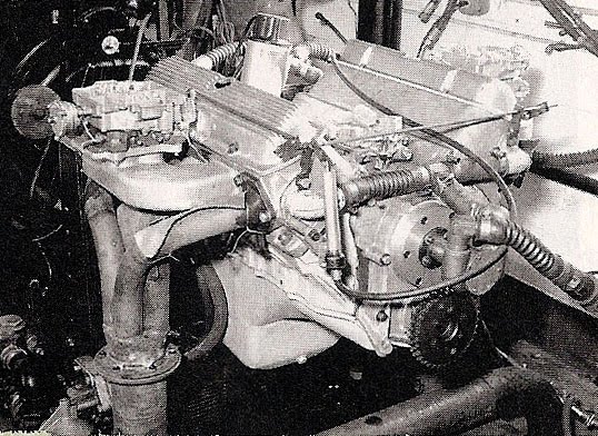

  20. Just because I'm a MT fanboi and nothing to do with nothing really...

  27. The whole idea of a side port set up is actually very brilliant. By running all the ports on the exhaust side, you end up with a much shorter, straighter port. You also do not have to steer away from push rods. About 10 years after M/T played with side port arrangements, Bruce Crower did the same thing with a little chev. It made huge power and the cover of Hot Rod. So, the theory is quite sound for a high hp combo.
    Balljoint likes this.

  29. This engine pic is very special! Have never seen it before. Are there any more? This is a side port arrangement with a high exhaust port! very wild and almost unlimited potential. Someone was really using their noodle.
    s s
  30. Not to take away from Mickey, but: its very rare NOT to find an inline 4, 6 or 8 cyl inline OHV that has "side ports" aka, intake & exhaust on the same side of the head.
