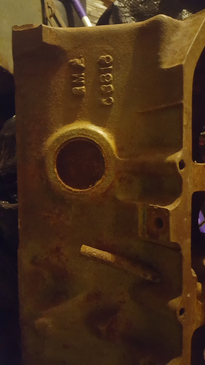

    Ok, while on the topic of Pontiac engines, I have a few questions about a block I have. The block in question is missing the last digit on the casting. Only has 538818 and it does not appear as if it was ground off. Has 4 bolt mains. Dated F-15-1 and has a 12B engine code with 288738 on the front of the block by the head.So far what Ive found the 12B puts this as a 62 389 385hp . Have not measured the bore yet. The 288738 is that a partial VIN, did Pontiac blocks that early even have VINs stamped or is # something different ??

    I will take a shot at this. Block should have 2 freeze plugs per side, no provision for block mounted starter, cylinders should be chamfered. The casting number should be 6 digits if this is a Super Duty block of 538181 (you show two 8s back to back). Build date is June 15, 1961 and production for ‘62 model year vehicles didn’t start until August 15, 1961 but that block would be considered a ‘62 with the 12B code (385 HP 3-speed manual trans application). The other number (288...) is an EUN (Engine unit number) and is not the VIN. Pontiac did not start stamping VINs until the ‘68 MY across the board. It should have 4-bolt main as you noted. I would interested in seeing a picture of the block from the bottom pls. That is a rare piece you have there. Regards, Randy

    I'll have to take a few more pics. All I had was the side with the casting and just beneath the head with the engine cide

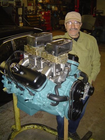

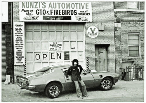

    I used to follow Nunzi from Brooklyn NY.. His heads were some of the best..
    I always liked the good old 421 with a set of close chambered heads. The 67 670 heads came with the bigger valves but the cyls needed unshrouded.
    I remember that place. We picked up two engines up there..

    Nunzi was the man! Randy
